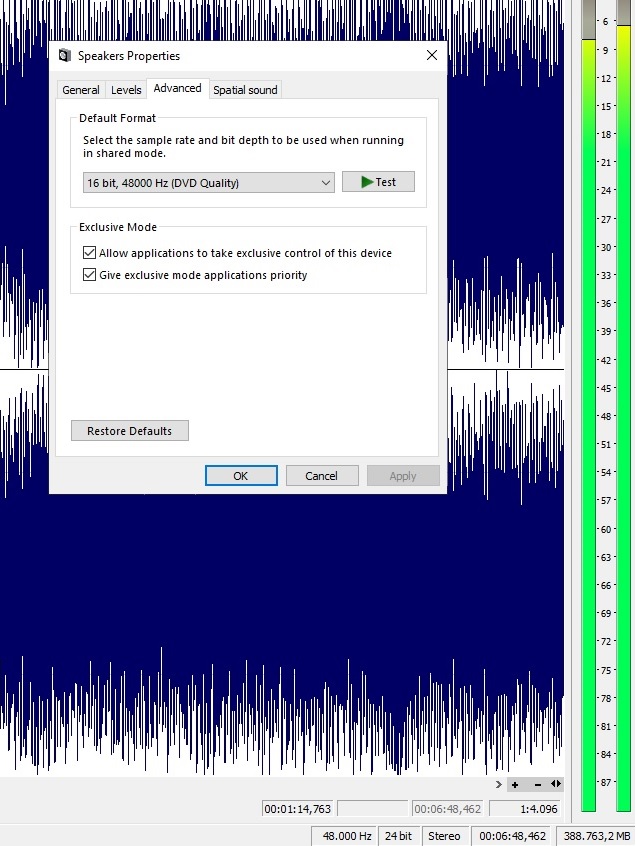

Ok, finally, it's working.
Like already Astroman suggested to change in multimedia to 48kHz, didn't worked yesterday, i have played again with settings today.
-full security access to C: (Users)
-run as administrators (Scope, Cubase, Soundforge)
and changing multimedia-advance settings.
