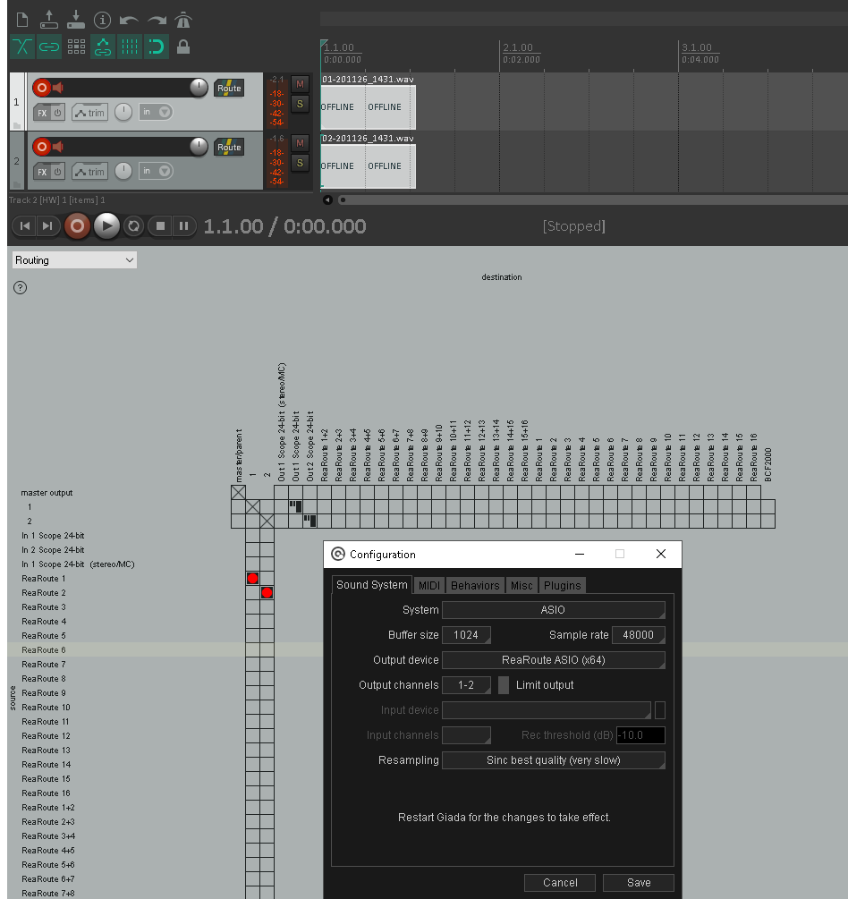

Hopefully this will help
I managed to get Giada working into scope asio by feeding it thru Reaper first.
The image below shows the Reaper setup and the Giada Config that makes use of Reaper's asio IO.
Reaper has for me solved a number of incompatibilities between scope and other apps by using this trick.
maus
Reaper_Giada Setup.png (52.41 KiB) Viewed 17191 times

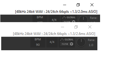

Rearoute doesn't add a lot of latency, this screenshot is a comparison between a session of Reaper connected straight to the hardware ASIO driver and another session of Reaper connected over Rearoute driver.
As we can see, Rearoute only added 0.6 ms on the total in/out roundtrip.
