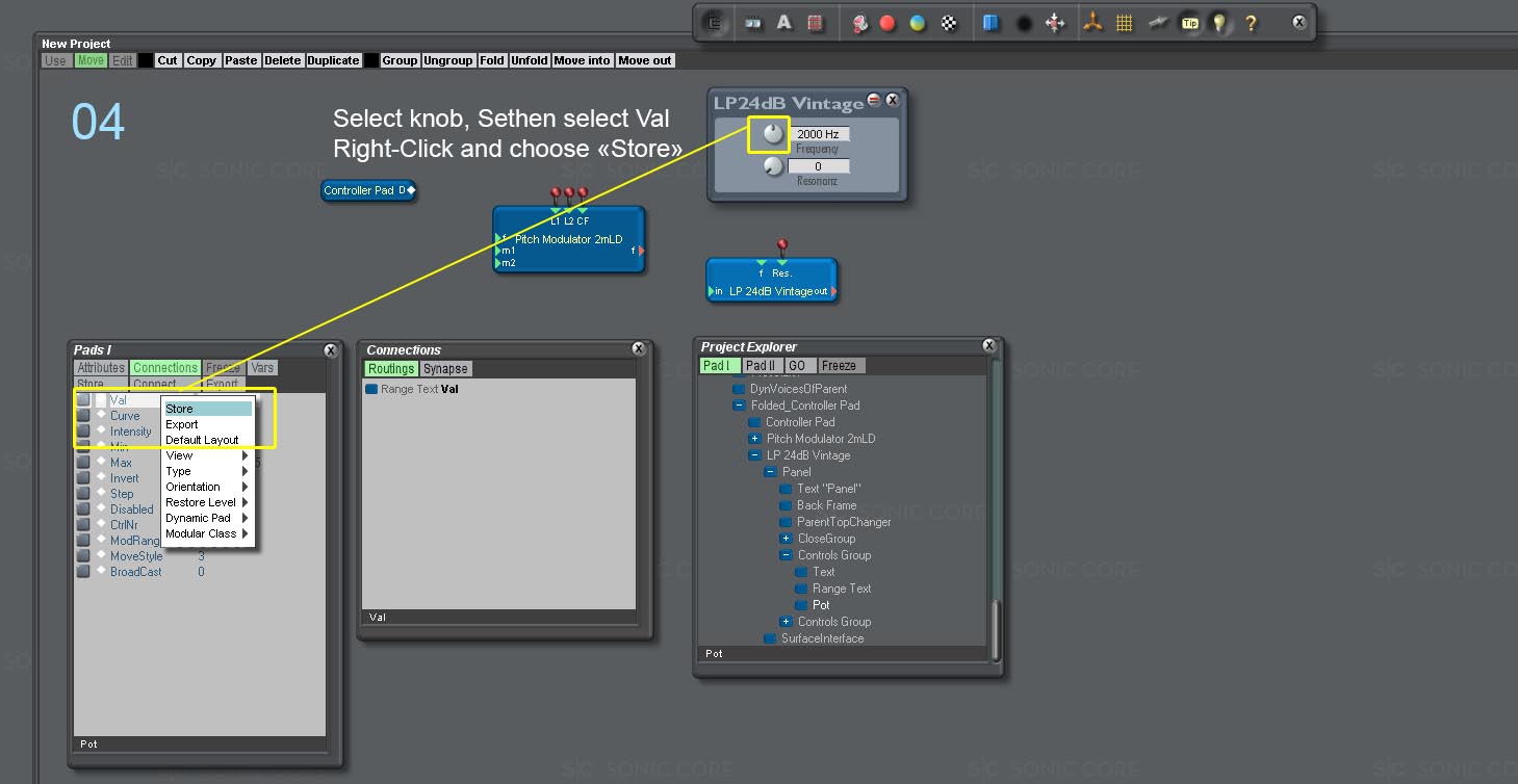

I'm stuck again at 14:45.
Pressing the freq-knob of LP24 doesn't show Rangetext val at connections, as on your video.
Pressing store and connect doesn't add Pot Val to the connections.
Are this differences, I should care about ?

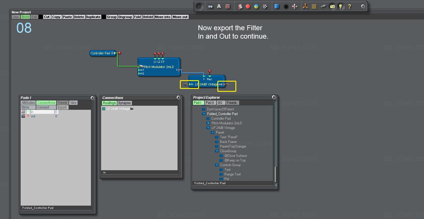

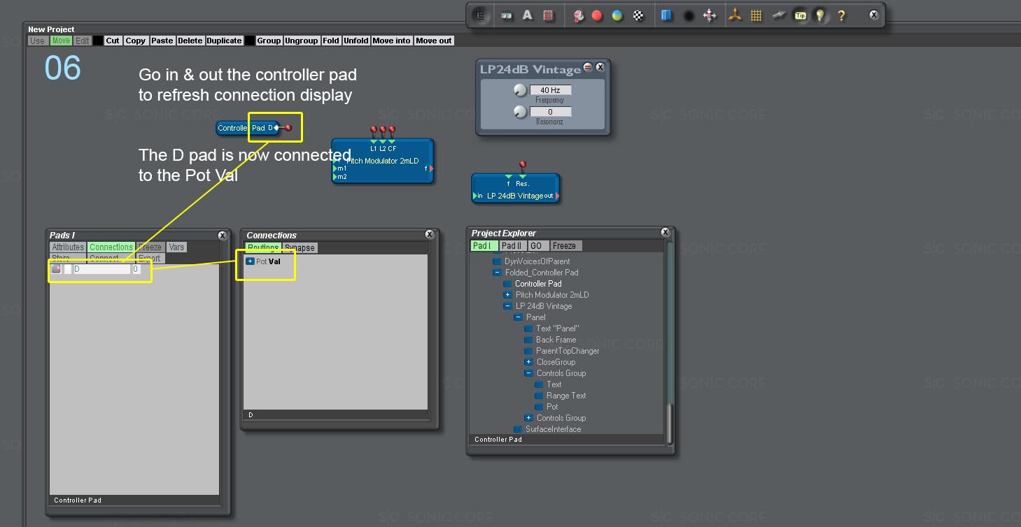

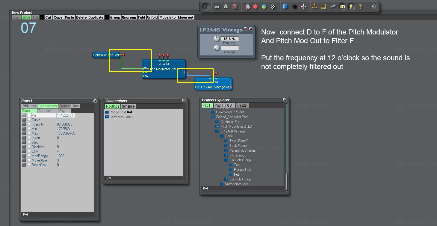

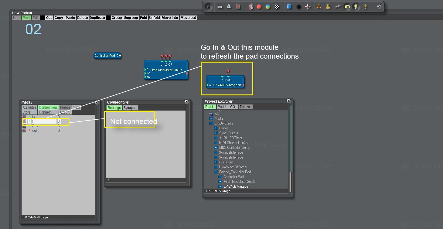

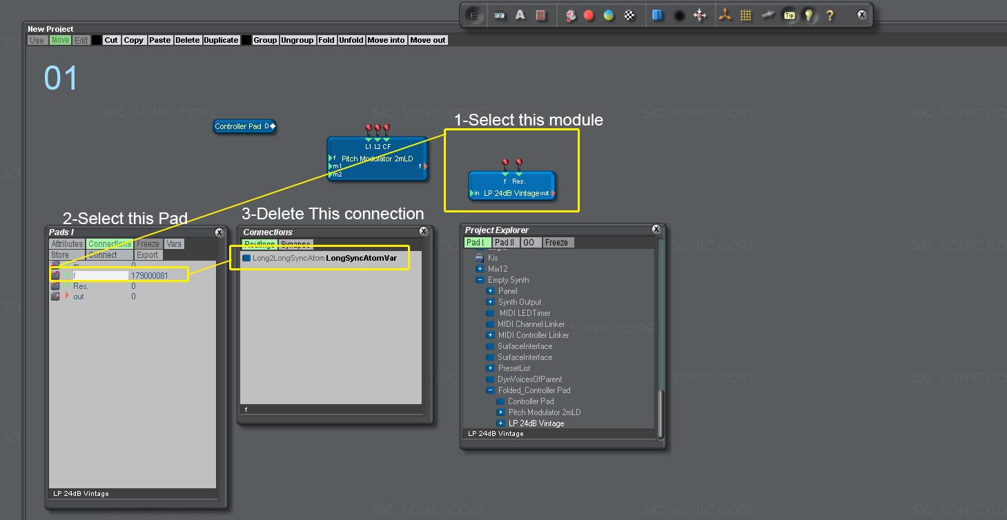

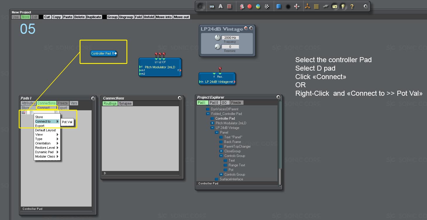

spacef
Posts: 3356
Re: TUTOR VIDEO - Make a synth in Scope SDK in less than an hour
Post by spacef »
Here is some help (2 posts)
You can download all images to see them better from your pc
or right click and "open image in new tab"
I also added more text/info at the end of the next message (under the images)
NB: to delete the connection, select it in the connection list and hit "Del" key
plug-ins for scope
SpaceF website
SC website
spacef
Posts: 3356
Post by spacef »
After all that, you can Cut & paste the pot and display group to the main surface.
Another way (more "pro") would be to delete all panels first, so pads are not connected to anything. Then import as many potis as you need on the surface panel, then make the connections that you need. BUT this method requires that you check the Min/Max values and curves of all these new potis. That's because you just copied the same poti many times, and it is unlikely that the setting of that pot conform the requirement all types of pads of all modules.
To do this, you can load a module a check what are the default values of various stuff (eg, you load a filter and check what are the min/max of the filter cutoff).
Cut & Paste= keeps the connections (the selected graphics are moved but connections are kept)
Copy & Paste= creates a new copy of the module or group. ie connections are not kept and the copied groups or modules are new instance. In general you want to delete the source group or modules in order to avoid double connections that can cause crashes due to exceptions ---> always check that what you want to connect is not connected somewhere else ie it does not create a loop of some kind with contradictory values or infinite loops that end up in an infinite loop of exception (stack) that obliges to hard-reboot your Scope !!! (ctrl+alt+del or PC reset button :-) )

nebelfuerst
Posts: 601
Post by nebelfuerst »
Wow!
Thank you very much for your detailed explanation. I managed to get the connection correct now.
