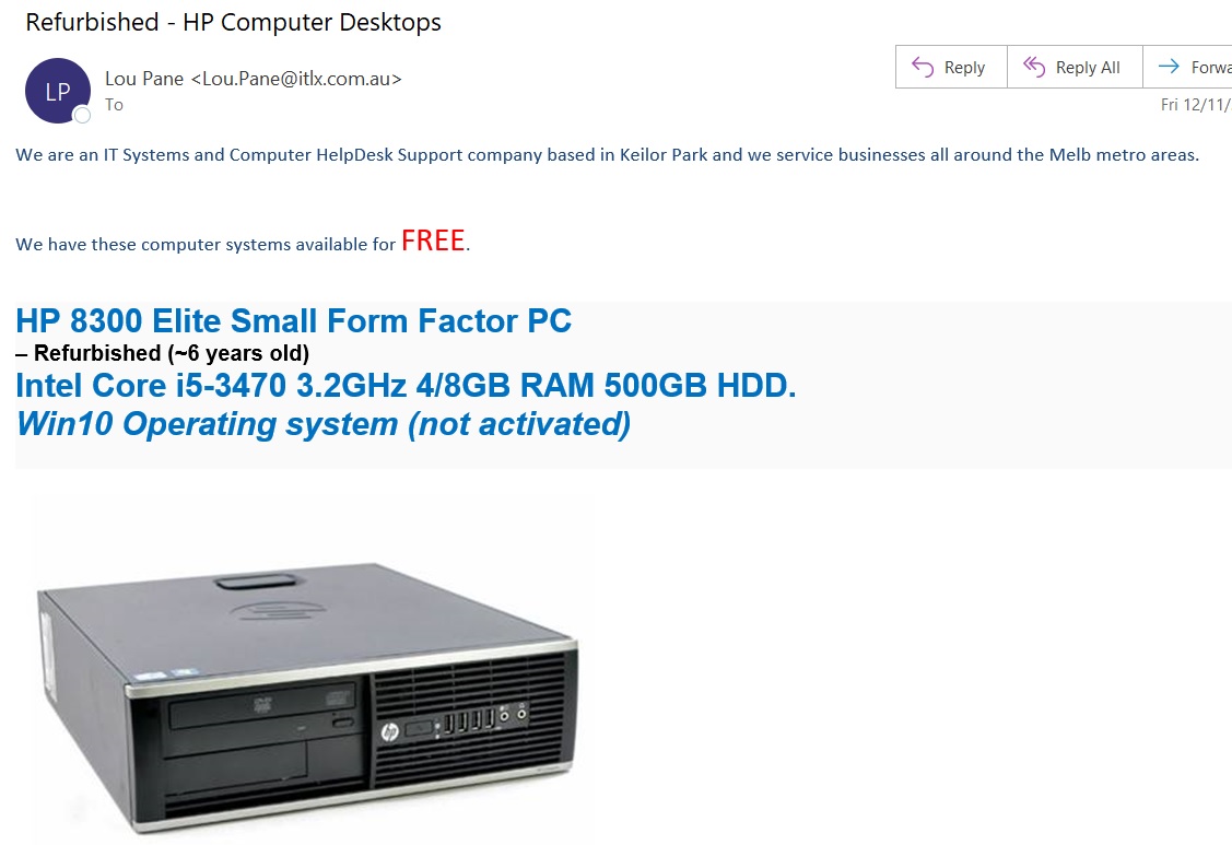

Here they are giving away HP8300 for free ... unless this is a scam. Dunno if the PCI cards will fit in this form factor - but I think theres 3 PCI slots ...
Free HP8300
Free HP8300
