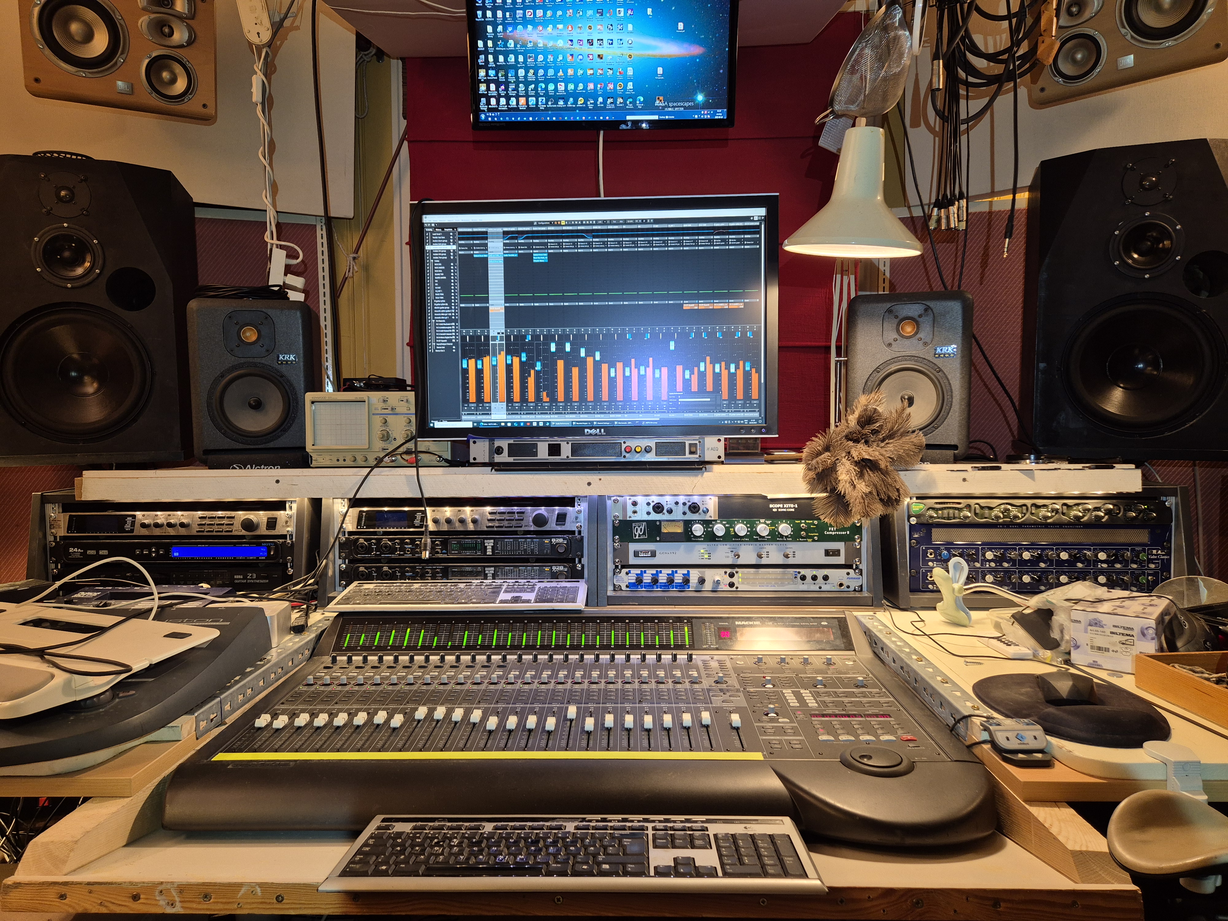

I didn't manage to pay the guy before recently.Bud Weiser wrote: Sat Apr 10, 2021 9:04 pmpics or it didn´t happen !drhardlove wrote: Sat Apr 10, 2021 2:57 pm Hi yah'all.
..- now I am here with a brand new second hand Xite-1.![]()
But now it is newly cleaned and set up to go.
Already tried it out on a Lenovo Thinkpad T530.
Worked with Scope v5.1 on Windows 10, after some finicky driver installing. How do I upload the picture?
