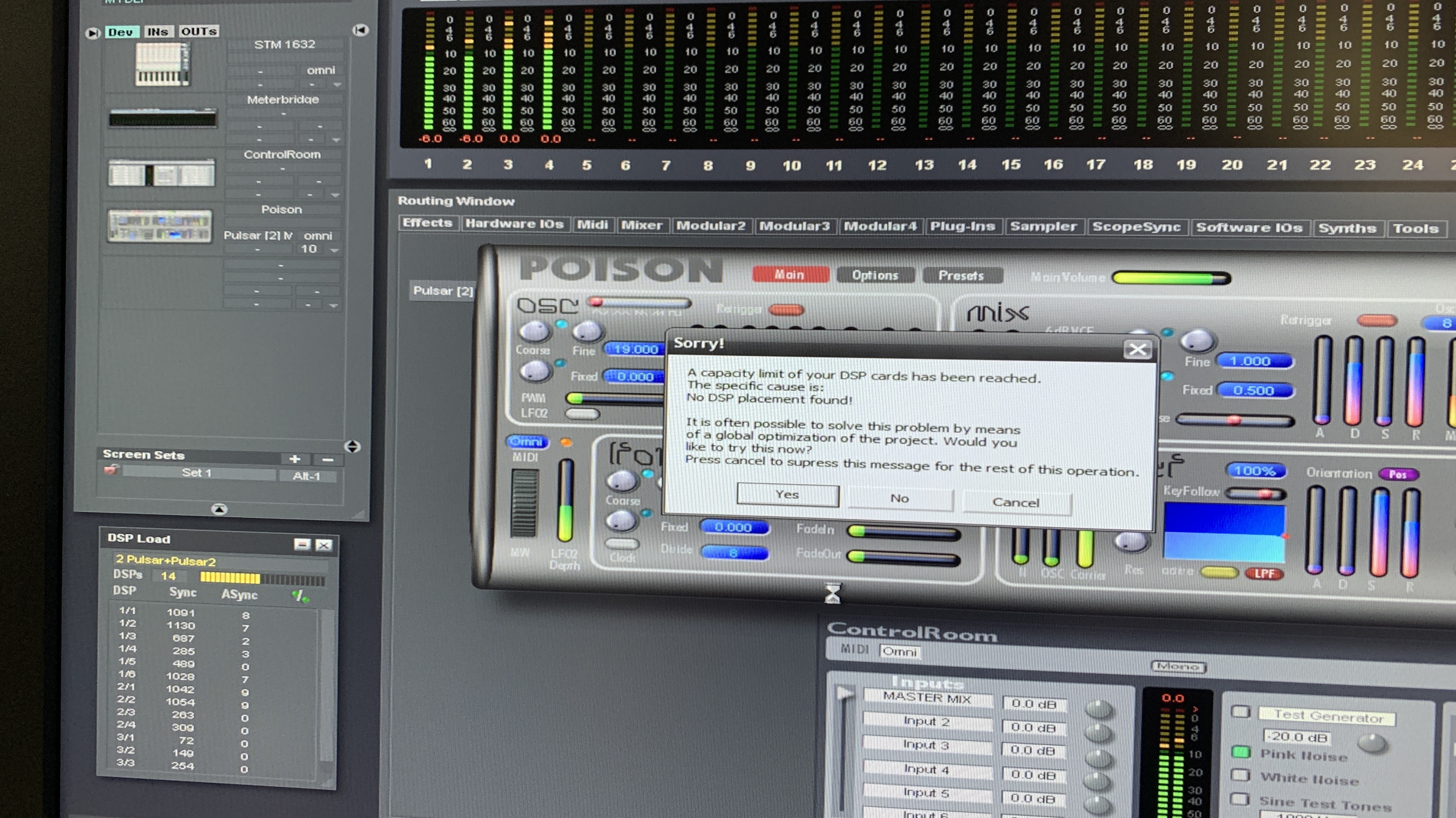

				Here is the message I am getting. It just happened now with only 1 poison FM running, 10 voice, and this message came up when I clicked LOAD FILTER ON DSP
and Im running at 44.1
- File_000 (2).jpeg (2.57 MiB) Viewed 5140 times
				Re: Out of DSP message, even though there is plenty?
				Posted: Thu Apr 01, 2021 5:41 pm
				Voice counts are the first thing to look at, if you load a synth with a voice count of say 8 it can take considerably more resources than you might expect.  Also be aware that the internal resources for each DSP chip aren't just an empty bucket to be filled, but each dsp chip might have all usable resources for one function utilized and so give this message, while a different simpler device might still load onto that dsp chip.

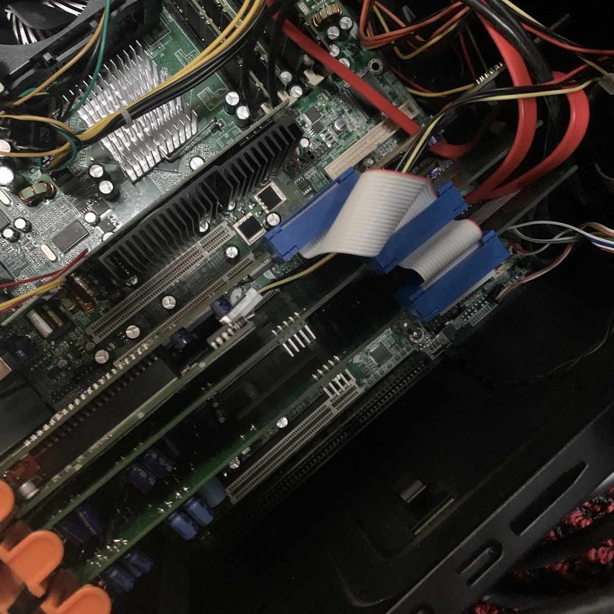

				I definitely followed the manual closely on how to connect them all up, and I was running just two headers of the STDM for weeks with no issue. I even made another cable yesterday, this is how I have it:
But yes maybe I should try to run the Pulsar2 by itself...
- 3 cards.jpg (525.26 KiB) Viewed 5050 times
				Posted: Fri Apr 02, 2021 9:44 am
				by mk_vip

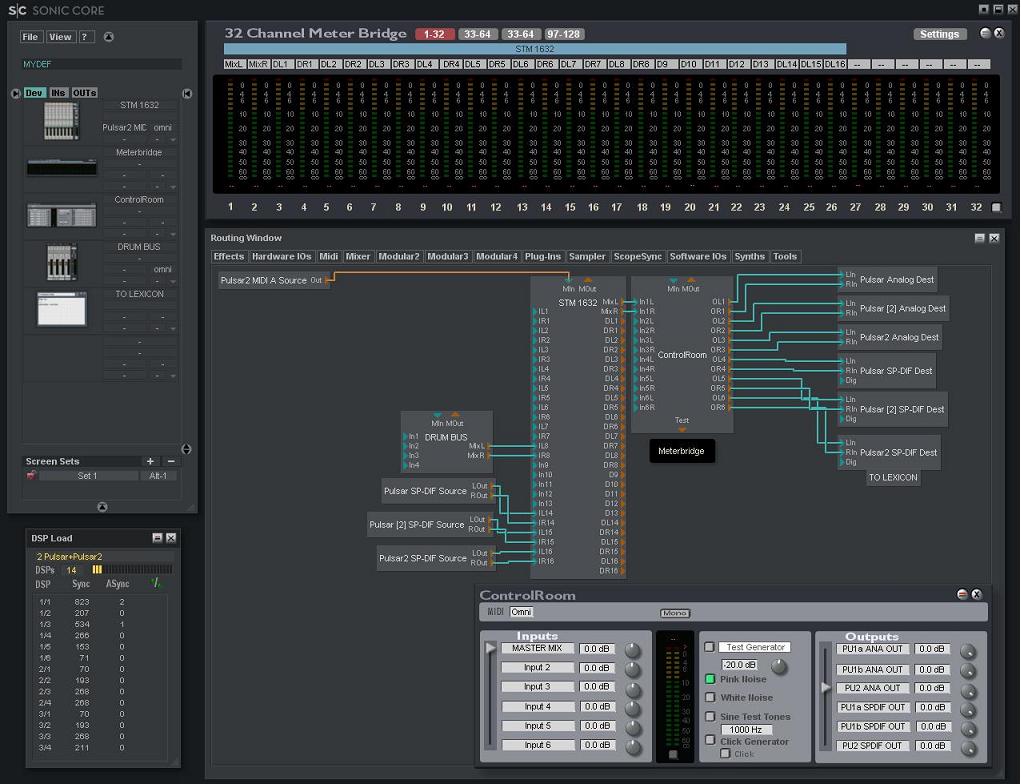

				1. Referencing your first screenshot, you do already appear to have the Pulsar2 (6 dsp card) "seen" by Scope as the first card.  As GaryB indicated, there's no much else needed in the Scope 7 era, so you're good here.
2. you have a very large mixer in that project, and as of yet you only have 1 synth.  Personally, unless I really need all the features of a mixer, I route in the routing window (rather than on a mixer) and use mostly Micromixers.
3. Aside from simplifying project usage as indicated above, the suggestion to reinstall the software might help.  You don't need to reinstall *everything*, but what I suggest is going into your Scope folder (which for me, using Scope7 on Winxp is "C:\Program Files\SCOPE PCI\") and then go into your App\Application folder (so C:\Program Files\SCOPE PCI\App\Application\) and delete the "IOs" folder.  This removes all existing IO modules, including any that may have carried over from earlier Scope versions.  Once that's done (with Scope closed of course) go into your device manager and remove the cards.  Reboot & reinstall, then see what order the cards are in, build a new project with the correct i/o's and see how things fare.
The reason I suggest #3 is many people are using Scope across multiple versions, with projects across multiple versions, and often mixed devices across versions as well.  Using older projects can also be problematic for this reason, though might be necessary for project recall sometimes.  Moving forward, build from scratch using Scope 7 modules and devices only, if possible.  This doesn't mean no older 3rd party devices of course, simply that you are eliminating bugs that have possibly been addressed within Scope's own codebase, and that all stock modules are using the same optimization techniques and so on.

				current routing:
- s7.JPG (123.95 KiB) Viewed 4899 times
				Posted: Sun Apr 04, 2021 10:48 pm
				Yes, I route directly between devices & i/o's.  I do understand why you use the mixer, I used to do that as well.  When I worked with Assaf on Flexor, I learned a lot about maximizing my use of resources in Scope for what I wanted it for, things that can be done elsewhere are.  But noone wants to dictate YOUR workflow, just giving hints since (as GaryB points out) sometimes resources are limited by the size of the board and/or how direct a path is between dsp's when certain resources are no longer available locally.
As flexible as Scope is, you can use it in many ways.  So rather than worrying about what the best way is for even me, I have learned multiple workflows and just deploy what works best at any given time.  Like you, I have a variety of external gear and lots of i/o in my space.  So much so, that most of my i/o to Scope is ADAT/AES/Spdif now.  It connects to my main board through one of my card's analog i/os on the output, and the input is fed off of a bus on my board.  The other card (I use 2) is fed from my sends and goes back to a return.  That effectively gives me a solid path to bus process audio, return audio, feed any synth stack or etc, and I can also do an fx chain on the send/return (or return another stereo pair etc).  The reality for me is that most things are going to get fed back via ADAT and bounced down eventually, so I started working in this manner.
What that  does is effectively give me a solid signal chain that does 1 thing in the end, whether it's a full fat synth stack or processing something external to record it, etc.
