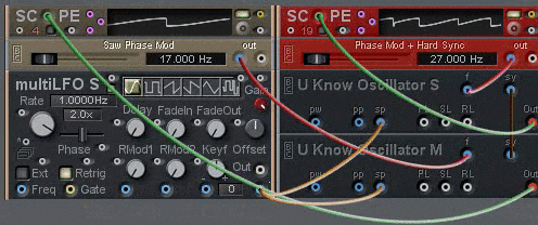

Might also be me being confused how the phase mod actually works on the oscs.
Normally the modulator will continuously update the phase in accordance with the modulators waveform. But reading the description for for example NBL Saw Gate it says "This oscillator is retriggered by gate messages to start from the point in the waveform indicated by the phase control".
So I guess they never did proper phase modulation, but just do start phase modulation.
Here is the NBL Saw oscs and Patten LFO doing the same thing (one saw osc being phase modulated with a sine an octave higher)
However if I sync the saw osc to a third osc running at a higher frequency one can notice the phase start modulation working:
Can perhaps lead to interesting results, but really want a normal phase mod osc....guess I have to use the Pattern LFO's at audio rate instead.
Or is there any other oscs with phase modulation?
Since the Pattern LFO can do it must be doable.

No, this has noting to do with the lack of sinc interpolation between samples as we discussed.
Look at the frequencies they are set to, both oscs and lfos are running at 20 and 40 hz.
And both pictures show things working as expected when understaning the Flexor manual correctly.
A bit confusing that phase mod is different things on the osc an LFO, but on the lower picture you can se how it is starting on a different phase for each sync, but still have the saw shape on each restart. Proper phase mod as seen on the LFO's causes the phase to constantly update, so you can see the intermodulation of the sine waveform.

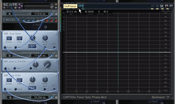

Spindrift wrote: Sun Feb 28, 2021 6:12 am I noticed a strange problem on my Xite system...phase mod doesn't work on any of my Flexor oscs.
...can someone with Xite verify that they are working?
NOT problem on our XITE system, all oK!
see Flexor`s Sync Logic, only the Sync Gate will set in Phase Mod!
cheers ron

Spindrift wrote: Sun Feb 28, 2021 10:07 am Might also be me being confused how the phase mod actually works on the oscs.
...Can perhaps lead to interesting results, but really want a normal phase mod osc....guess I have to use the Pattern LFO's at audio rate instead.
check here the OSC "U Know" Collection +Phase Mod >> https://www.styledriver.eu/scope/modular/chapter/U-KNOW-Osc.html
