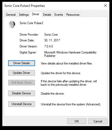

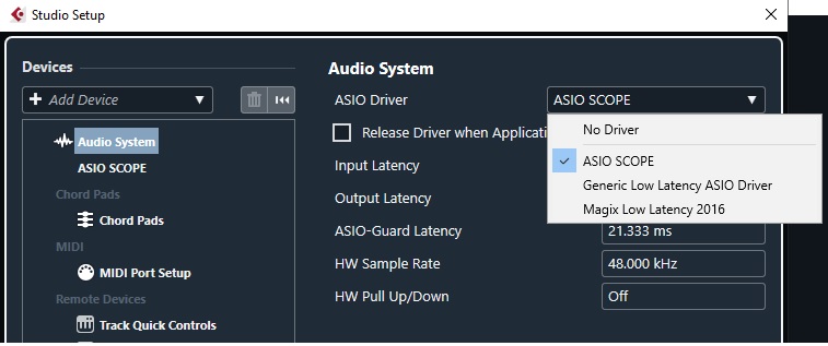

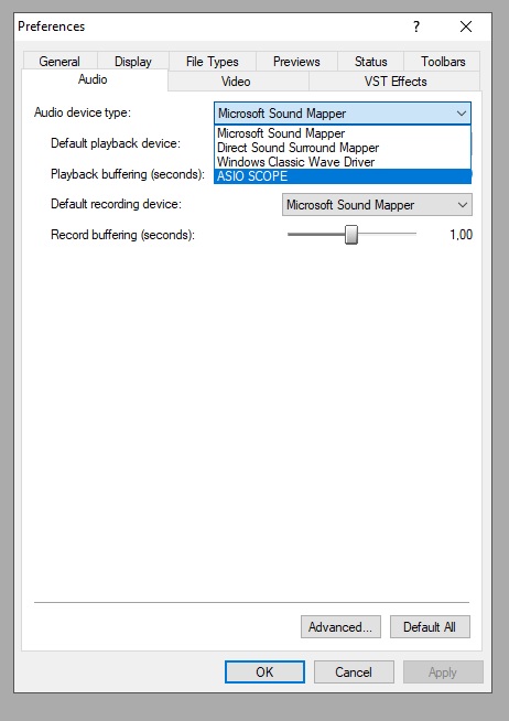

ASIO SCOPE, not sure for Ableton, just Cubase Artist 11 here.
Pictures:
Cubase, Sound Forge shows just ASIO SCOPE and driver version from Device Manager.
I would try to uninstall cards and drivers from device manager and install just driver part again.

Thanks, got that same date for my driver. Will see if I can uninstall the wave drivers by setting it to 0 and then back to 1.

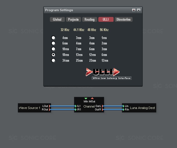

medway wrote: Fri Feb 05, 2021 8:22 am Ok set it to 0 and then let Scope reinstall again but still get dropouts in Youtube and mp3 player. I'm using the normal Wave driver.
This is my computer where i have few Luna II cards, just for internet and multimedia, mp3 player, Youtube, movies,
it's Scope 5 version, but try lowering the latency, which i did, after i searched what can i do about dropouts.
It's simple project which is running with Windows startup.

Hi thanks. You you mean raising the latency? I usually run on the largest setting. I think that's for ASIO only though? ASIO is working fine it's just the Windows driver I was getting dropouts from.
I changed my mp3 player to WASAPI and that seems to have solved it there. Just Youtube to figure out now as there's not an option for that as far as I know.
