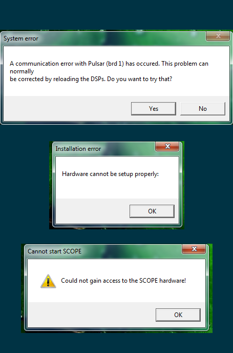

I cleaned my PC with a can of compressed air, no big deal, everything worked just fine. Then I added an equivalent to WD 40 Specialist electric contact cleaner spray.
To do this, I dissembled carefully the whole of the PC, removed the motherboard and then started the cleaning process, firs with compressed air on every item and then applied a thin coat of WD 40.
Then I put everything back happy for having a clean PC. But, when I booted up had the following errors in one of my two Pulsar cards:

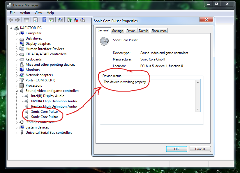

Nevertheless, look at this, both cards are recognized in windows device manager as working properly:
