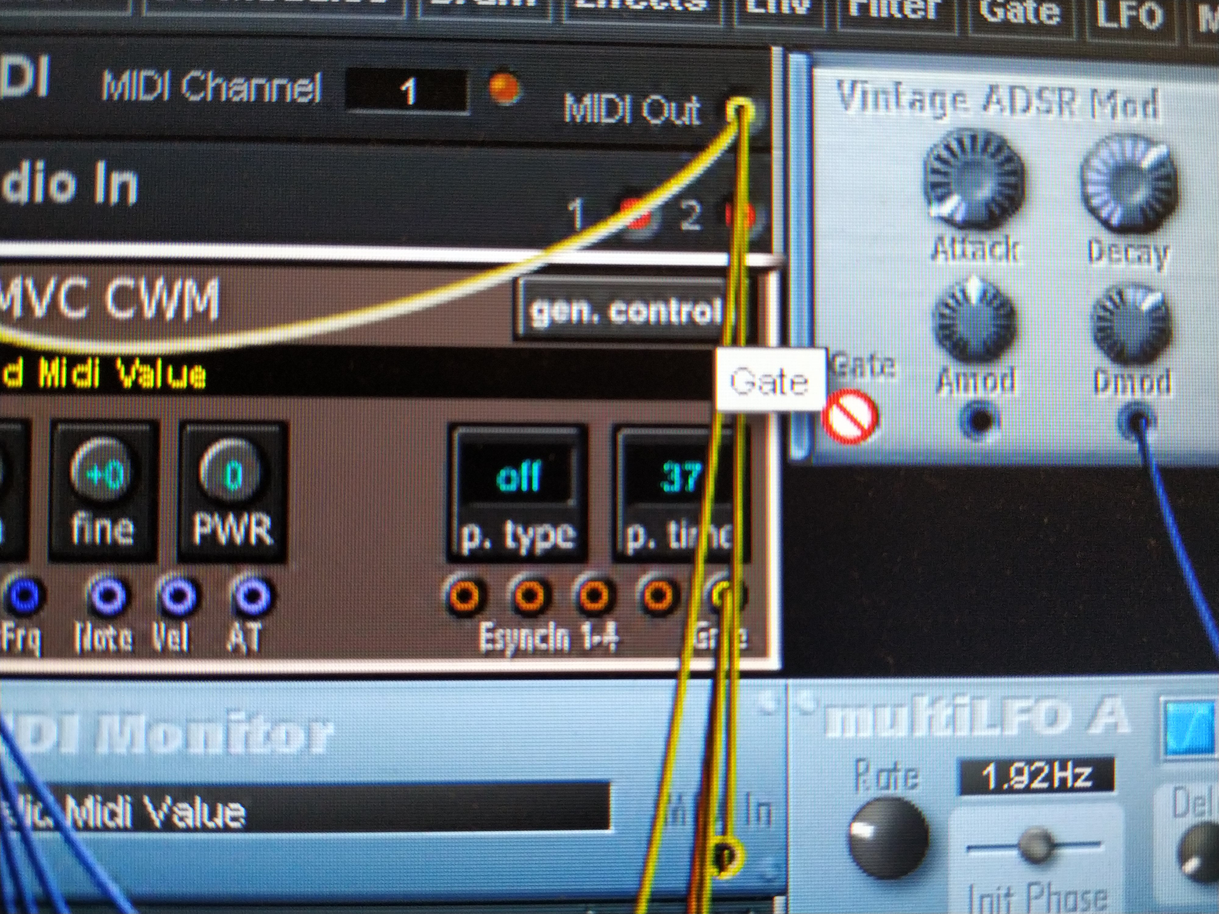

I was wondering what the stop sign means that occasionally (well, rather often) pops up when trying to make a connection, for instance a gate connection.
I assume it might have to do with sync/async, but I don't know how to solve it, apart from deleting one of the modules and putting it there again.
2020-12-22 13.20.54.jpg (2.19 MiB) Viewed 21533 times
here's a picture. I don't understand why I cannot make the connection, because it was there, I removed the cable and now I cannot connect again.
The connection was between the MVC gate out and the ADSR gate in.

to your example:
MVC Gt Out (Async) >> Env Gt In (Sync)

Thank you very much. That makes sense.
