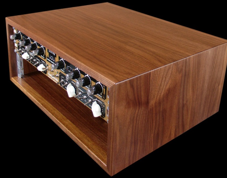

I'm really liking the idea of these wooden racks. Anyone used anything like this - any recommendations ? I dont think they're good for live as might get beaten up, but for static studio use....
Re: Wooden racks
Posted: Sun Dec 06, 2020 9:33 pm
most big studio racks are wood. it's nice.
the best ones have wooden rails to avoid chassis ground loops.
big studios have bespoke furniture.

I have a wooden rack like that, which i use for some studio amps. Works fine, but I wouldn't put my hotter rack gear in one that small.

I had a couple of built many years ago. They are not as nice as the one pictured. Mine were simple lacquered pine. Very strong. They still look new! Two hold 8 1Us. One holds 12. That one is still in use. Most of the equipment is gone as they were rack synths. It was great. Stackable. Put a mini-lite on each and a sliding tray on the bottom. I might consolidate what's left in my rolling rack to one of these someday. but the spaghetti is a nightmare.
They were custom built so many years ago at a good price but I can't recall who did them!

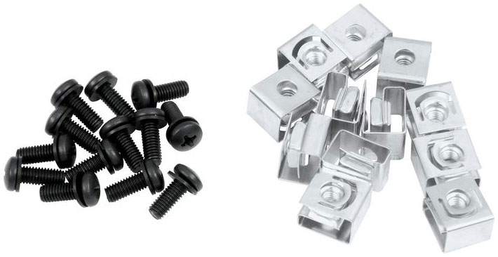

Also, is it just me - or these crappy springy clips - in restricted space - keep loosing their position or get stuck or thread rips. Id like to have fixed mount wingnuts or whatever...
Re: Wooden racks
Posted: Mon Dec 07, 2020 3:49 pm
those are good.
if they strip, just replace them.

the best quality server racks use clips, even expensive ones from 40 years ago. if you have hundreds of thousands of dollars worth of gear in the racks, you don't want to remove it all to replace a stripped out rack rail. it's better to just replace the clip.

Posted: Tue Dec 08, 2020 11:34 am
dante wrote: Mon Dec 07, 2020 1:38 pm Also, is it just me - or these crappy springy clips - in restricted space - keep loosing their position or get stuck or thread rips. Id like to have fixed mount wingnuts or whatever...
Those are the SKB parts. Work great until you start changing and re arranging.
