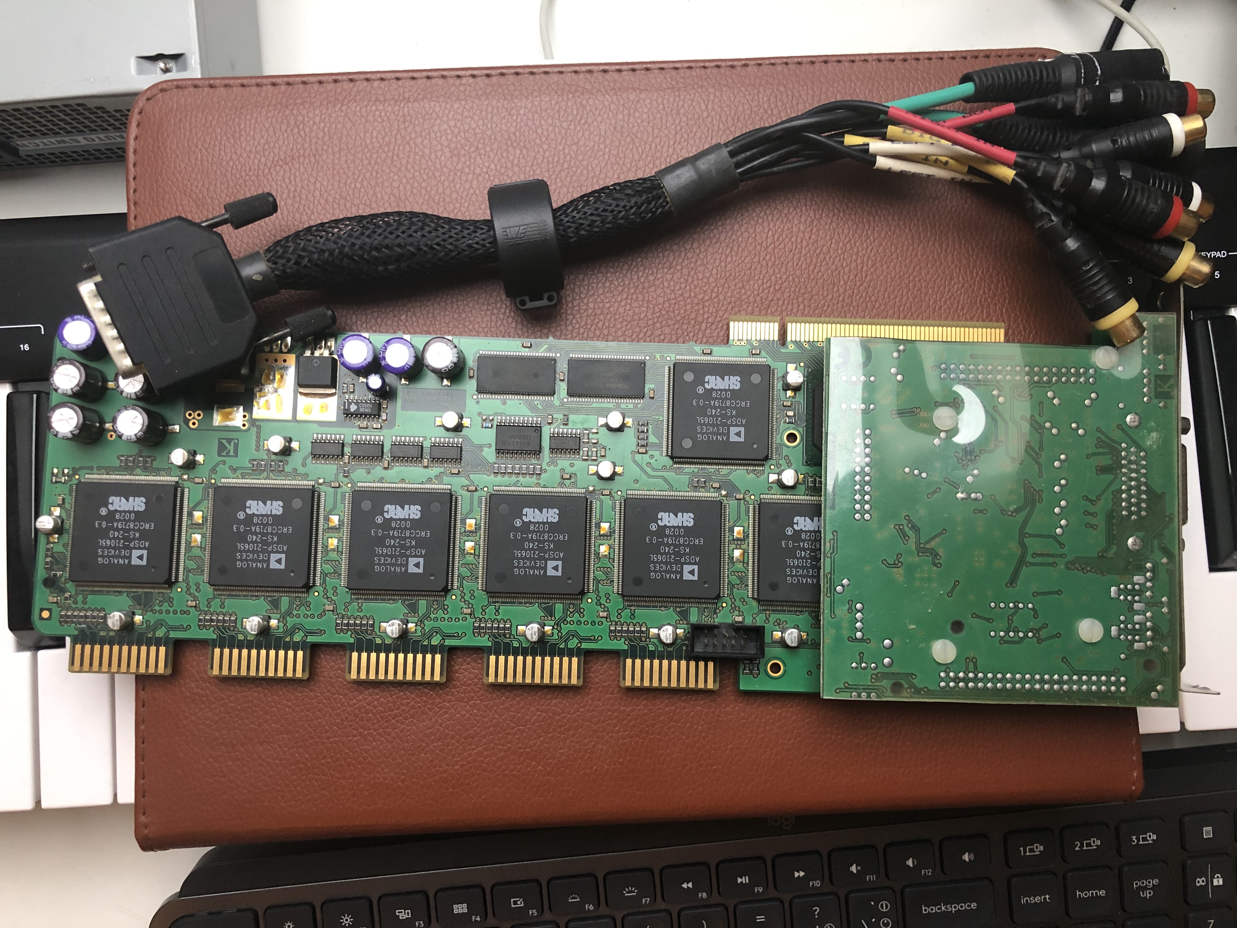

Thought I was getting back to scope, but I have realized that the platform is not for me for now. Just signed on a house and will need to collect all the cash i can to get money for fixing stuff.
So scope must go sadly.

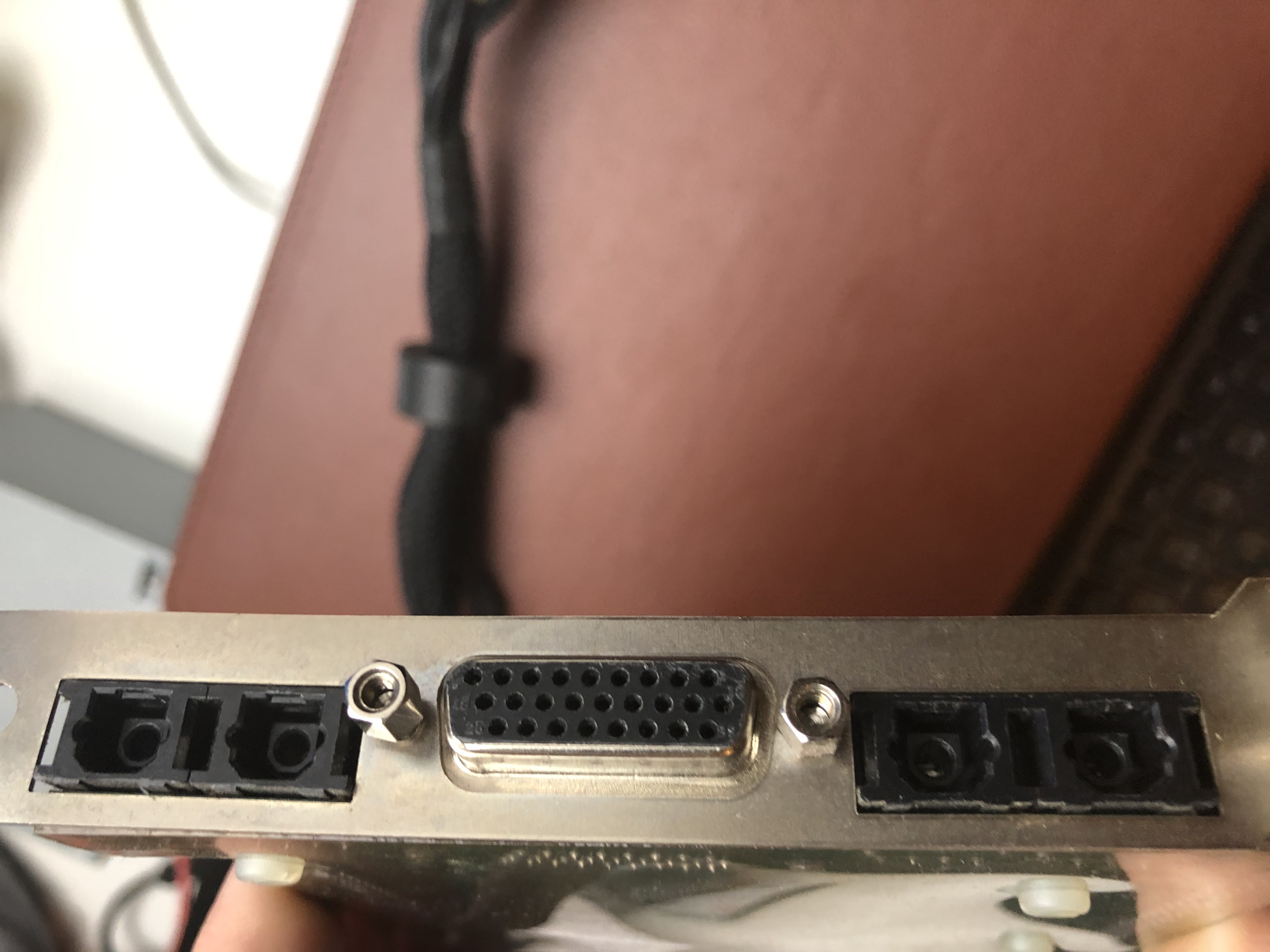

15dsp gen 2 card.
Comes with v7 of the scope sdk along with scope v7
also:
dNa-Summer-of-82
dNa-Super8Tracker
dNa-MonoCOMP
dNa-StereoCOMP
dNa-Tape Echo
The card has one issue though!
Midi input via the midi in DIN is not working correctly. You get garbled midi.
I have taken apart the DIN plug itself to check it. But could not detect any errors. The housing of the MIDI in is therefore broken. (you can solder another on easily).
This might just be a cable whip problem or it might be a plate problem or it might be an issue with the card itself.
I can run midi into it fine via a usb/midi interface.
Other than that I have not run into any problems at all.

You might consider that in this forum many guys already own high end cards.
The broken Midi input might also be an issue, as not everyone is happy to do midi-bridging outside a pure scope project.
A picture of your card would helpful to show the number of DSP and IO-configuration.
Just my 2cent ;-)

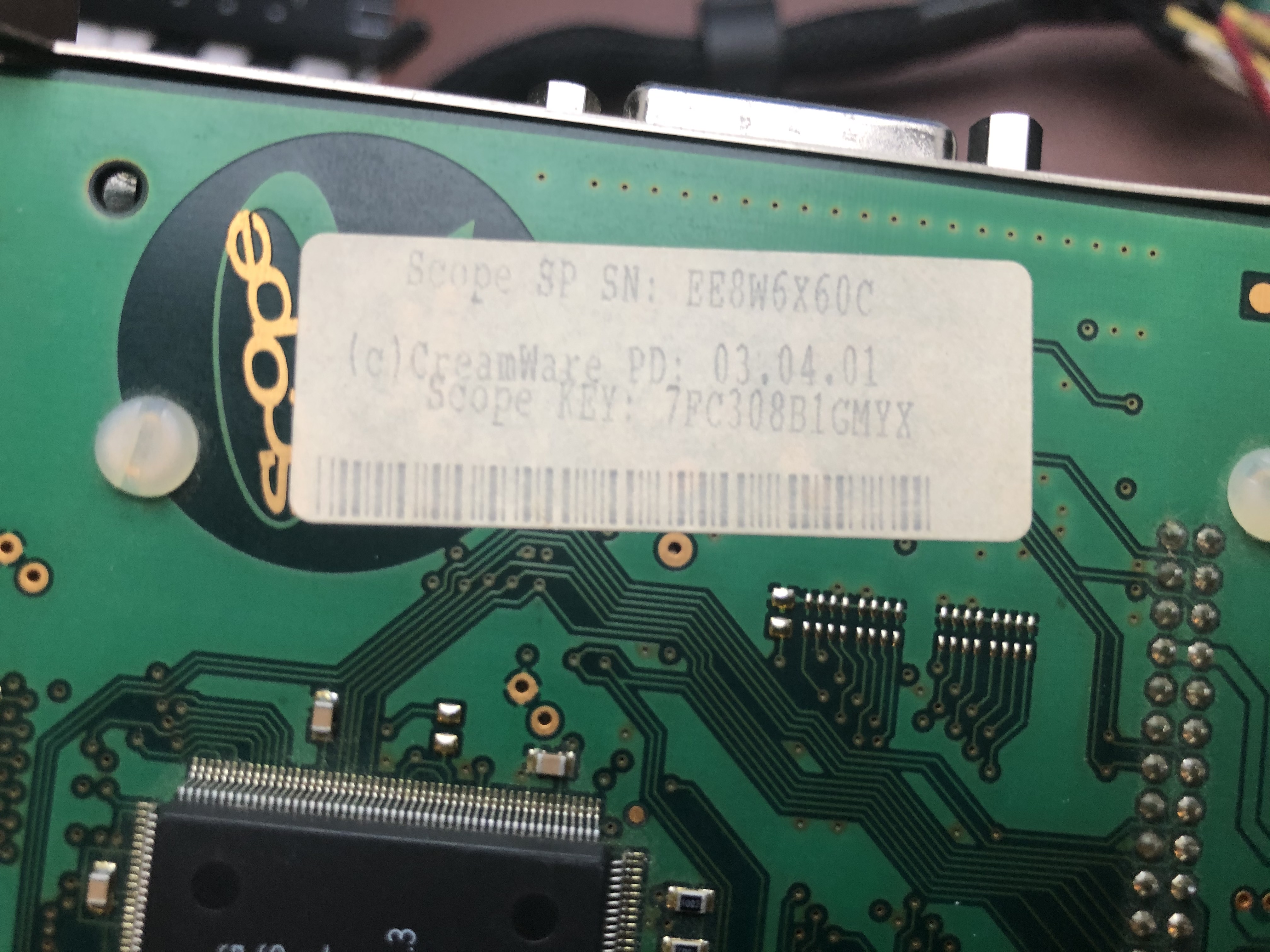

Post by the19thbear »
Thanks:) Have added pictures. But will go on Ebay soon if no one here is interested.

When the card were fully working incl. MIDI and if it were a 2nd gen. 15DSP card,- together w/ SCOPE v7 and SDK v7 you could get a somewhat better price than ~ EUR300,-.
So, is it a gen1 or gen2 card ?
The label shows 04.2001, so it might be one of the old ones introducing nearly twice the latency of a gen2 card.
And,- it is a defect card, issue not precisely identified,- and we all know the DNA devices came for free when buying SCOPE v7.
For everyone already owning SCOPE v7,- only the SDK would have a value and when removing cable-whip and plate, the card is just only a booster.
Now think about yourself what you´d be willing to pay for such discontinued piece of gear ?
EUR 650,- + shipping is way too much IMO.

Thanks for the input. It’s a gen 2 card. 15dsp.
Make me an offer if you are interested. Will probably be going on eBay sometime in January.
