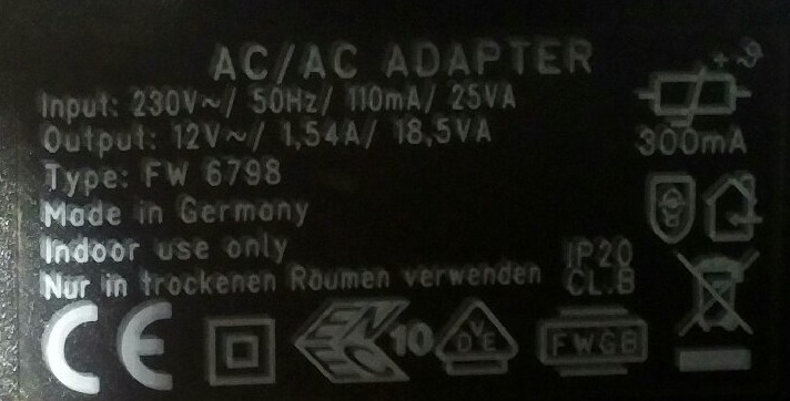

Polarity isn't an issue, due to AC. ( I mixed that up with an other powersupply.) :roll:
It's AC, because the generation of the voltages has to take place inside A16 anyway to keep the ripple voltages low.
Although you could also use a DC-supply, there are also AC supplies.
https://www.amazon.de/Steckernetzteil-1 ... =8-14&th=1
The plug has an outer diameter of 5.5mm, which is also included in that amazon-link.
Picture shows my original A16u-PSU.

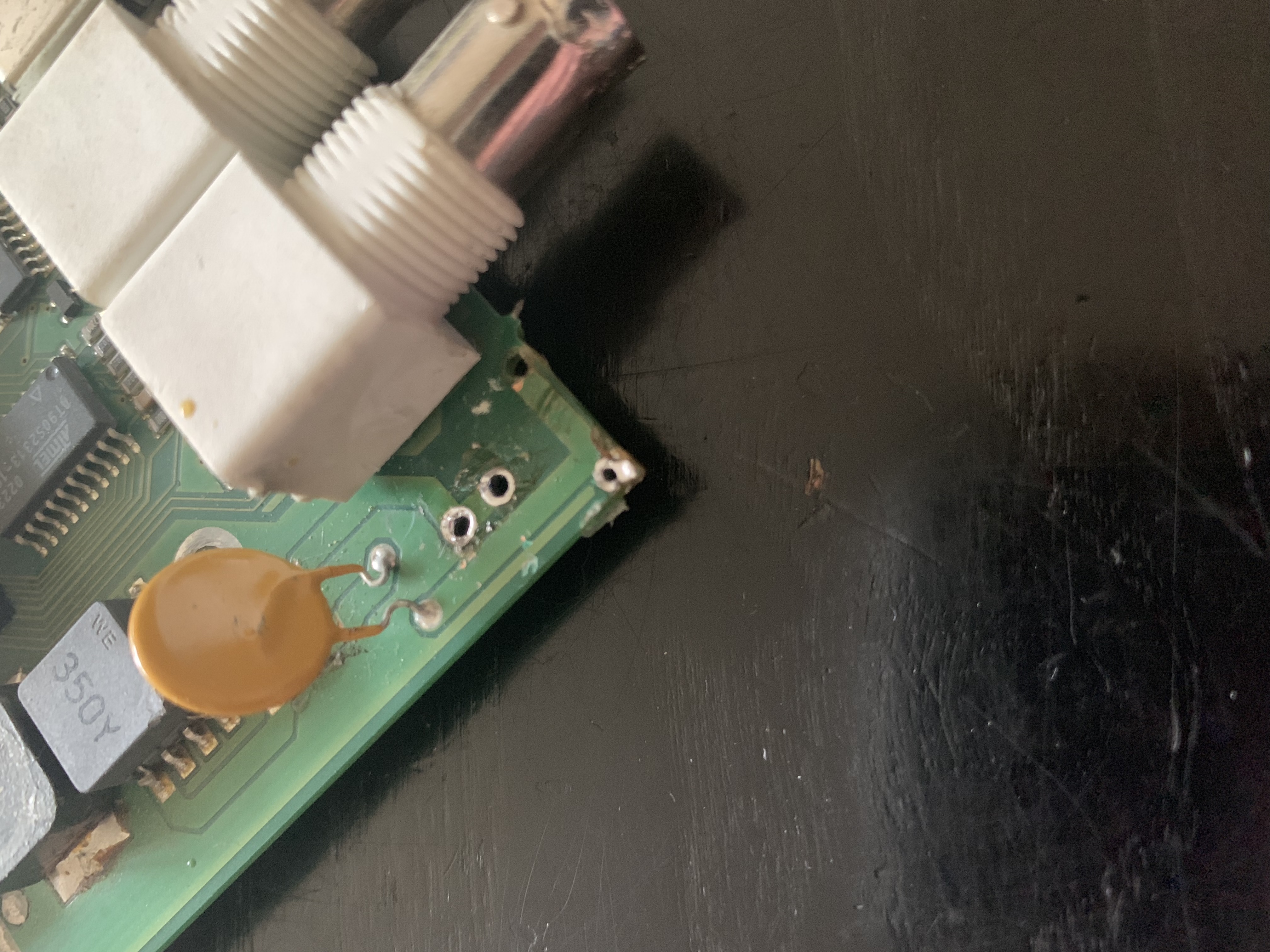

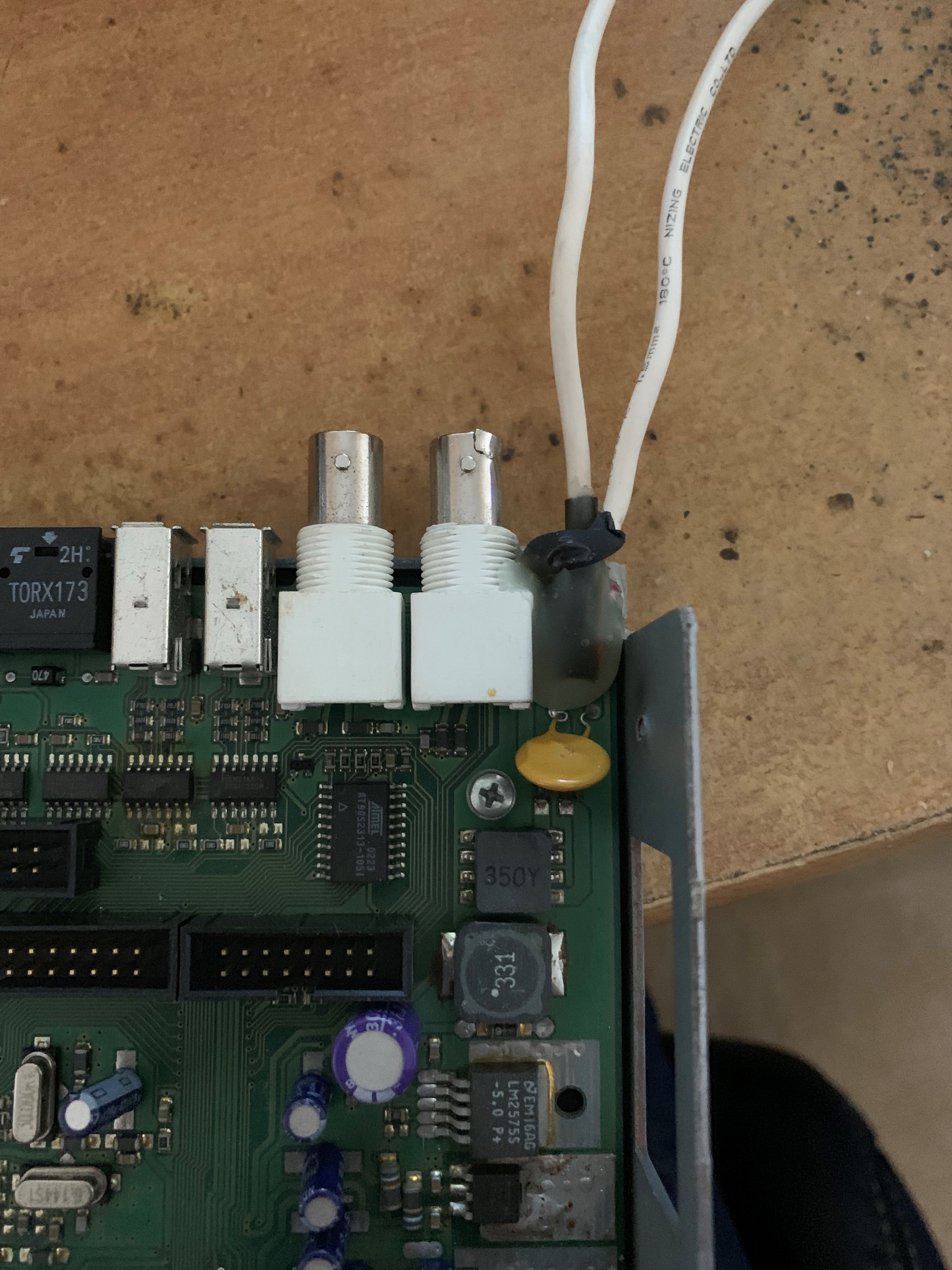

Ok so the unit arrived today. It turns out that socket where the PSU plugs in has been replaced with wires (as you can see from the photo).
I have soldering experience and the tools to do it but I dont know what the part is called so I can search for a replacement on an electronics site.
Can anyone tell me what they are called? PSU socket obviously returns a lot of results.
Thanks
R

Post by Refrochia »
Help!
None of them fit the circuit board.

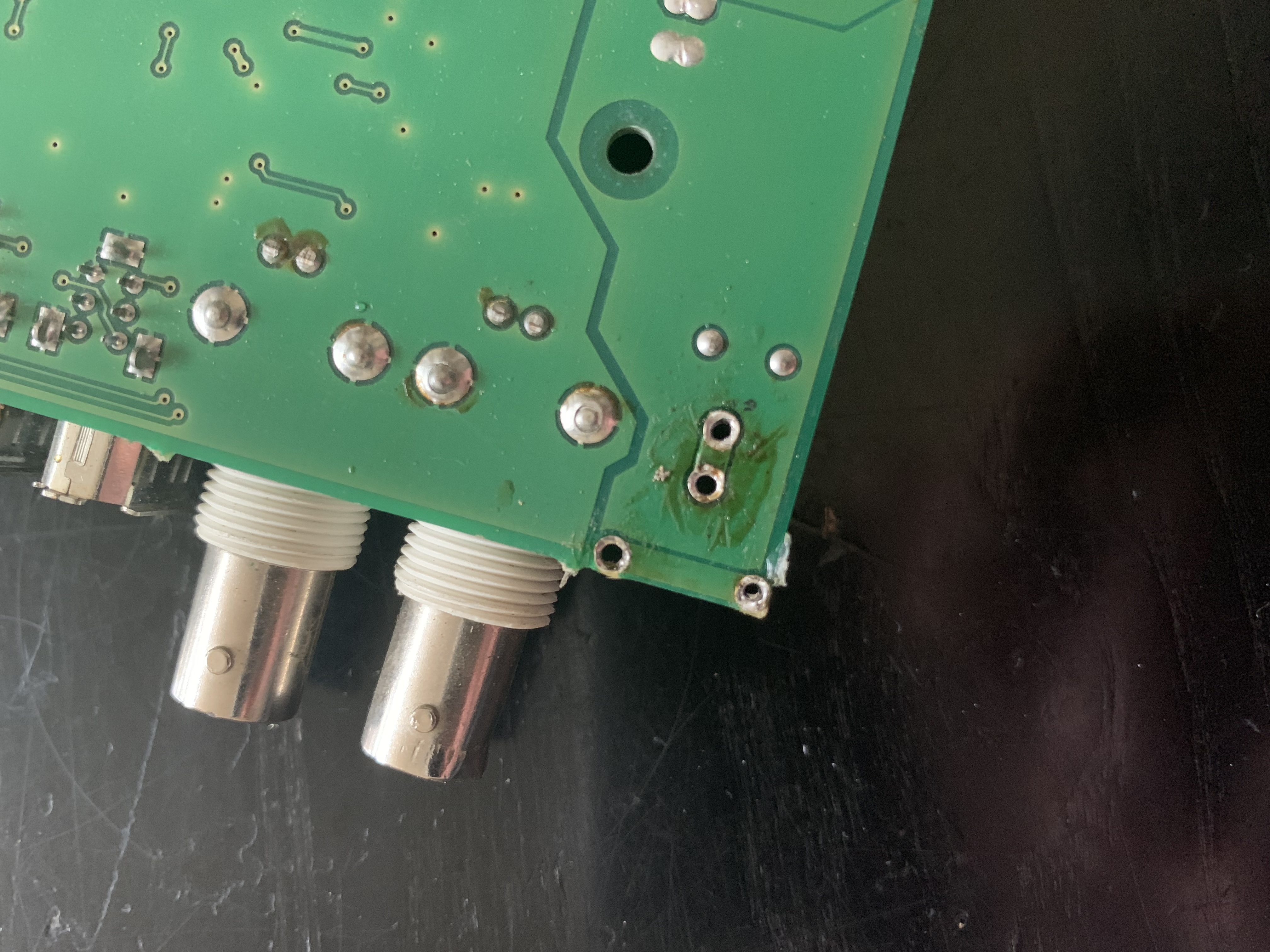

So the DC sockets arrived today and I've removed the wire that was soldered onto the board however the DC sockets legs are in the wrong place. There are 3 legs and 2 of them line up nicely but the other one doesn't. Given the state of the soldering of the wire I'm pretty confident that this will work once the correct DC connector has been installed.
@garyb Any ideas where I can get the correct DC power connector from? Are you able to find out the part number from Sonicore? Long shot I know.
Thanks
R

The links above doesn't show a part for PCB soldering.
You need something like this.
https://www.reichelt.de/einbaubuchse-au ... os_6&nbc=1
Probably you could provice a picture of the PCB-holes, so I might search an other one, if necessary.
you could also solder some wires to this part:
https://www.reichelt.de/einbaubuchse-au ... os_8&nbc=1

Thanks garyb-I’ve contacted them and they can’t help unfortunately.
Nebelfuerst-that’s awesome! Looks like it could fit so thanks a lot!
Photos attached for reference!

I checked RS components, Farnell, Digikey and LCSC, no joy.....,but looking on Reichelt looks promising.
This is the only jack I've found with the same footprint: https://www.reichelt.com/de/en/panel-mo ... ol_3&nbc=1
It's got to be worth a shot. I'd rather change the plug on the power adapter than have wires and a jack and wires dangling.
If you're in the UK, grab one for me! My A16U connector isn't the strongest... I'll bung you a fiver via PayPal...
Hope that helps....

If you do get one, please double check the connectivity of the pins, the data sheet isn't as clear as it could be... should be ok, but worth checking with a multimeter / continuity tester

Some of these devices contain a switch, which is often used to connect to battery if no plug is inserted. The PCB pictures show, that A16 doesn't make use of such a feature, so just don't care about the word "switch".
