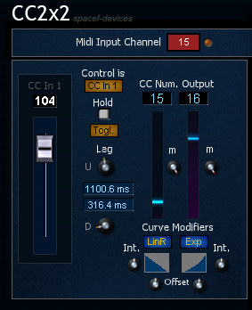

				This has audio inputs for even higher resolution.
- Untitled.png (99.73 KiB) Viewed 4111 times
