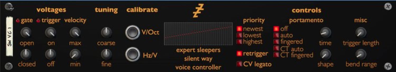

Silent Way
Silent Way

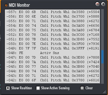

I think you can still troubleshoot this further. Use Midi-OX or another tool to watch the messages. Are you getting both MSB & LSB chunks? When doing a PB alone are you seeing smooth values or is there some discontinuity in the event stream (pauses, skips etc)?
Re: Active Sensing filter in Scope ?
Posted: Mon Sep 07, 2020 6:49 pm
This is what Im getting from the Scope MIDI Monitor (dont have MIDI OX installed). When held bend wheel fully open, there was time for one Active Sensing message before bringing the wheel back to rest position. Looks like 2 in every 3 values is skipped - maybe thats the issue. But when sequencer plays it back - maybe its filling in the missing values.
Pitch Bend MIDI
Pitch Bend MIDI
