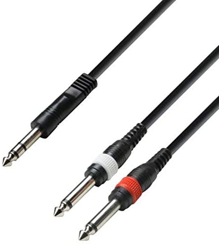

It's line level / consumer -10dBV with RCA connections (not balanced) so the only issue is that you shouldn't connect a balanced cable directly without modding it or using a DI box or ground loop isolator. Also of course anything that's +4 dBu will be rather hot (and perhaps the wrong impedance).

valis wrote: Wed Jul 29, 2020 11:04 am ...so the only issue is that you shouldn't connect a balanced cable directly without modding it or using a DI box or ground loop isolator.

For now, i just have this cable, 2 x mono output to 1 x stereo input.
