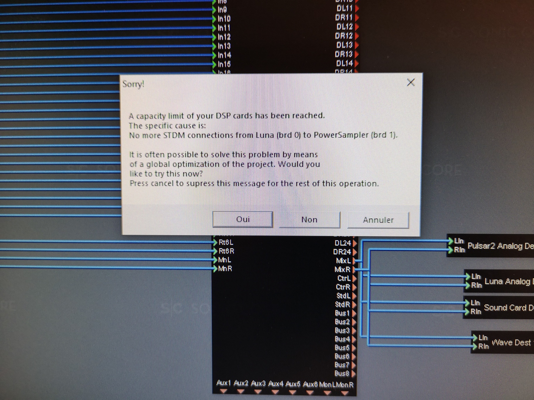

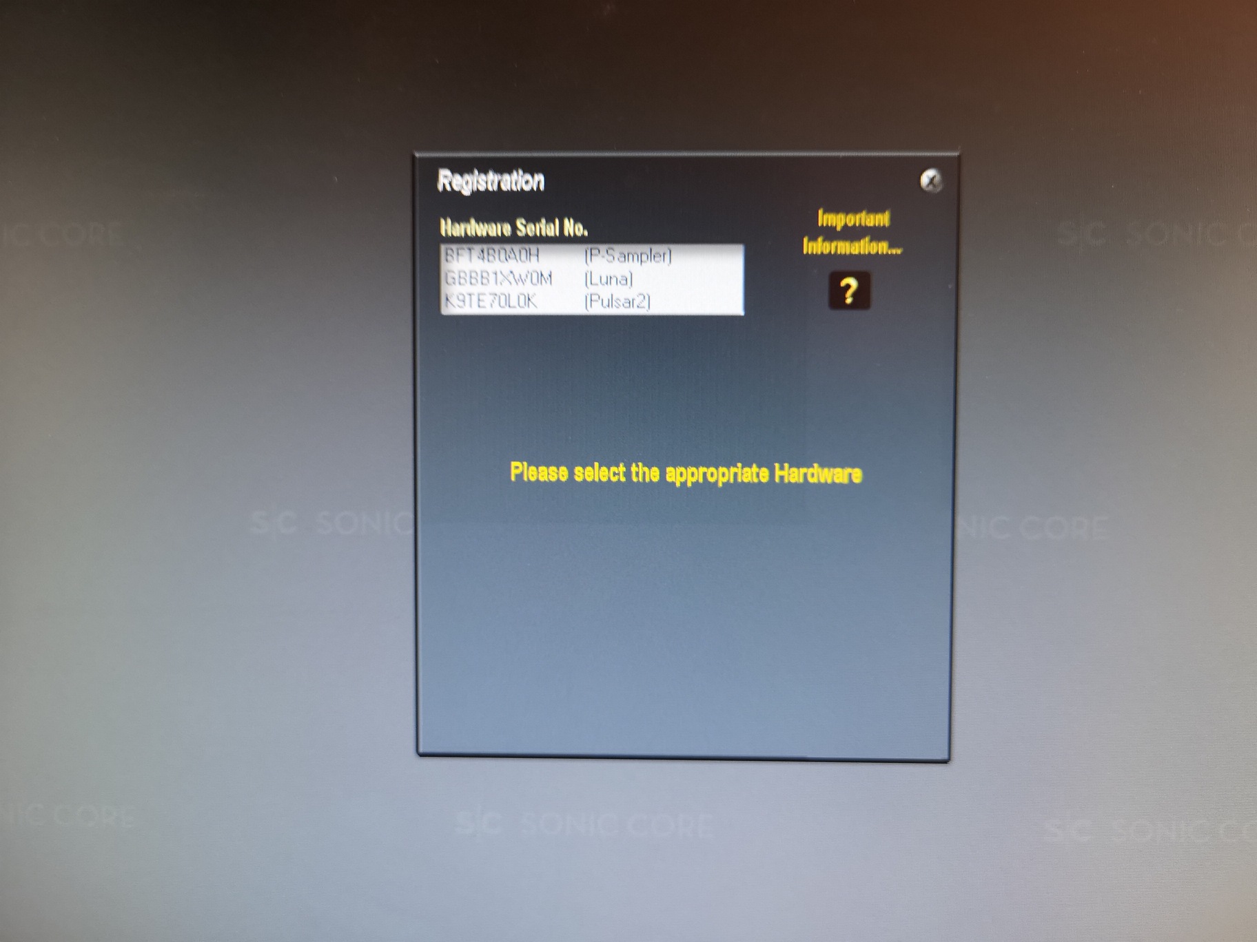

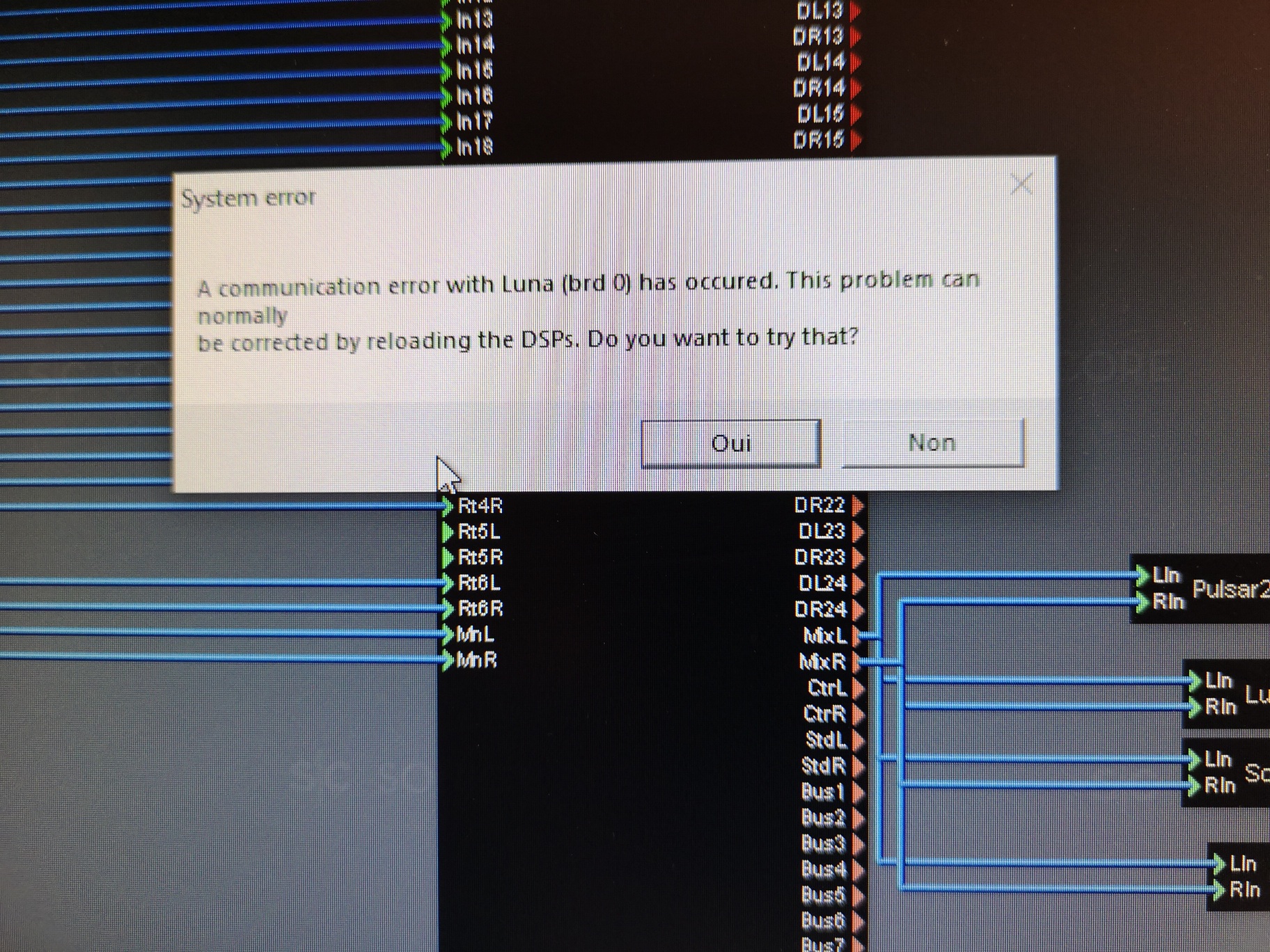

I just acquired a Power Sampler coupled to a Luna and a Pulsar 2.
Having only one PCI slot on my motherboard, I put the cards in a PCIe to 4 PCI expansion box (see picture).
Nothing works, error messages including repeated registrations but no sound, I think it's a problem of insufficient voltage to powered the 3 cards.
Is there anyone who's ever faced this problem before?
Are there more stable solutions in PCI extension?
thank you

Does it work with just 1 card in the expansion ?  With 2 boards ?
Try to replug the STDM-cable or use different connectors on the cable.
You could also use an empty project. This doesn't drain so much power like a fully loaded project.

Most PCIe > PCI expansion chassis don´t work as expected for SCOPE cards.
Possibly a Magma chassis does.
Re: voltage problem with 3 cards ?
not enough power.
expansion boxes suck.

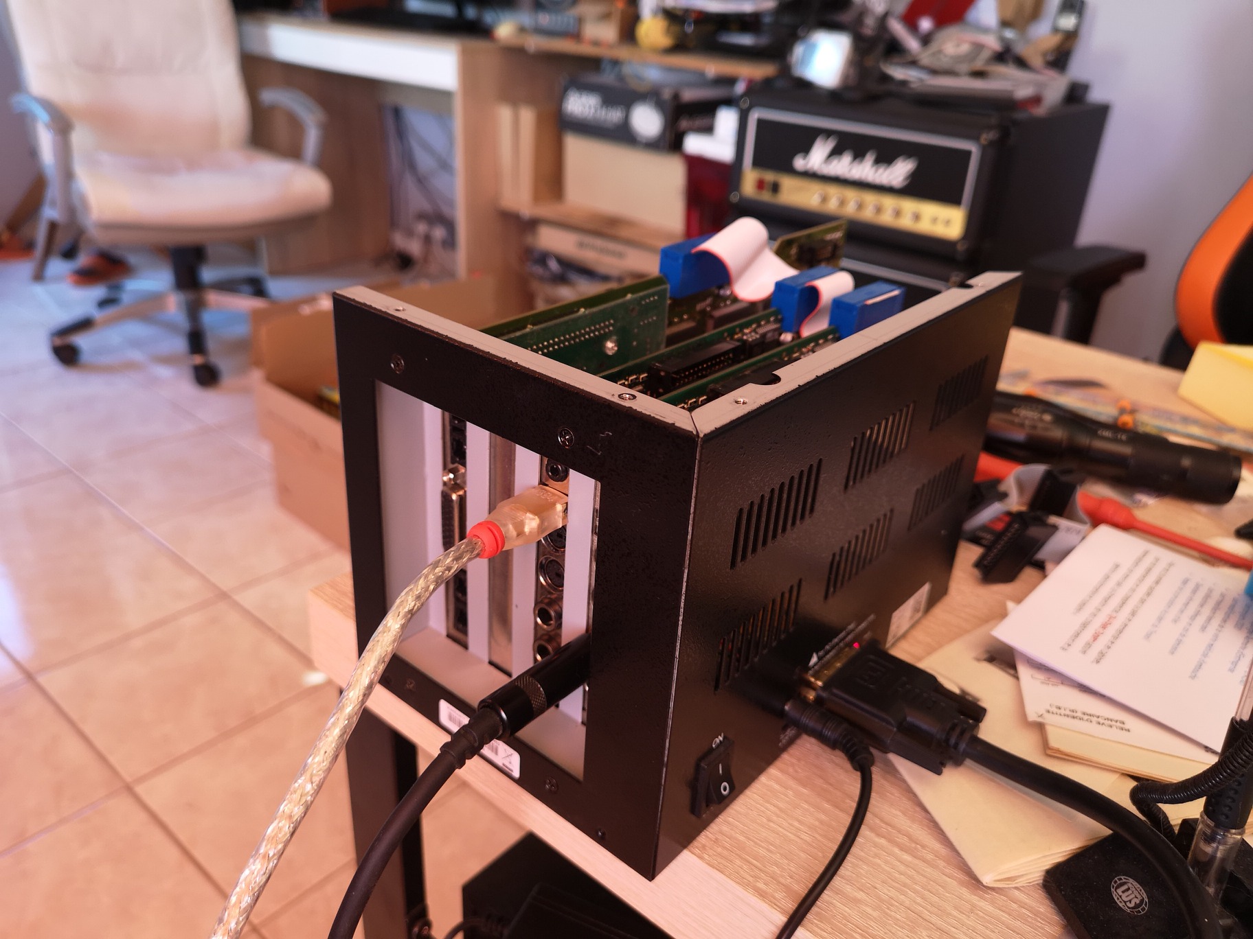

Luna 2, power sampler and pulsar 2 in the Magma box.
It's very stable.
The whole thing plugged in Zlink on the A16 Ultra, I could record 10 tracks simultaneously (reason why I added a power sampler because the AdatB of the A16 doesn't work).
I haven't really tried with the plugins yet but so far everything's fine.
						It's very stable.
