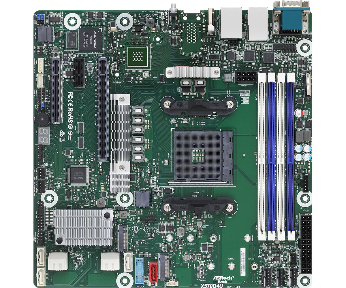

I just bought another Chinese motherboard that’s a consumer based server if that makes sense.
X570D4U-2T2L
Waiting for the Zen 3 CPUs since Intel fell asleep and just keeps adding more Watts, more cores, more latency.
AMD has tons of cache and will unify it on Zen 3.
Never paid 392.00 bucks for MOBO before.
If it doesn’t work I’ll have a 2000 dollar 8 core internet surf PC.

My Xeon motherboards all cost in the range of $500-750 usually, and even the last AMD build I did (3-4 years ago) I spent about $300 to get good 12 phase power & power buffering as well as heat hardened components (this is the machine I take to do live visuals).
ASRock is good stuff, and if it's a server motherboard that should mean it's built to higher tolerances for both of the above (power/heat) than typical consumer fare, and trades the fancy paintjob and chrome RGB heatsinks for stability.
Re: Chinese motherboard.
Posted: Sun Aug 02, 2020 10:39 am
And dual M.2 NVMe’s set up horizontally right under 3 x Supermicro Barrell fans too.
Stability is worth the money, even though my old Intel, MSI and ASRock consumer boards worked great too.
These 1U builds are finnicky but once the airflow is going smoothly everything works well.
