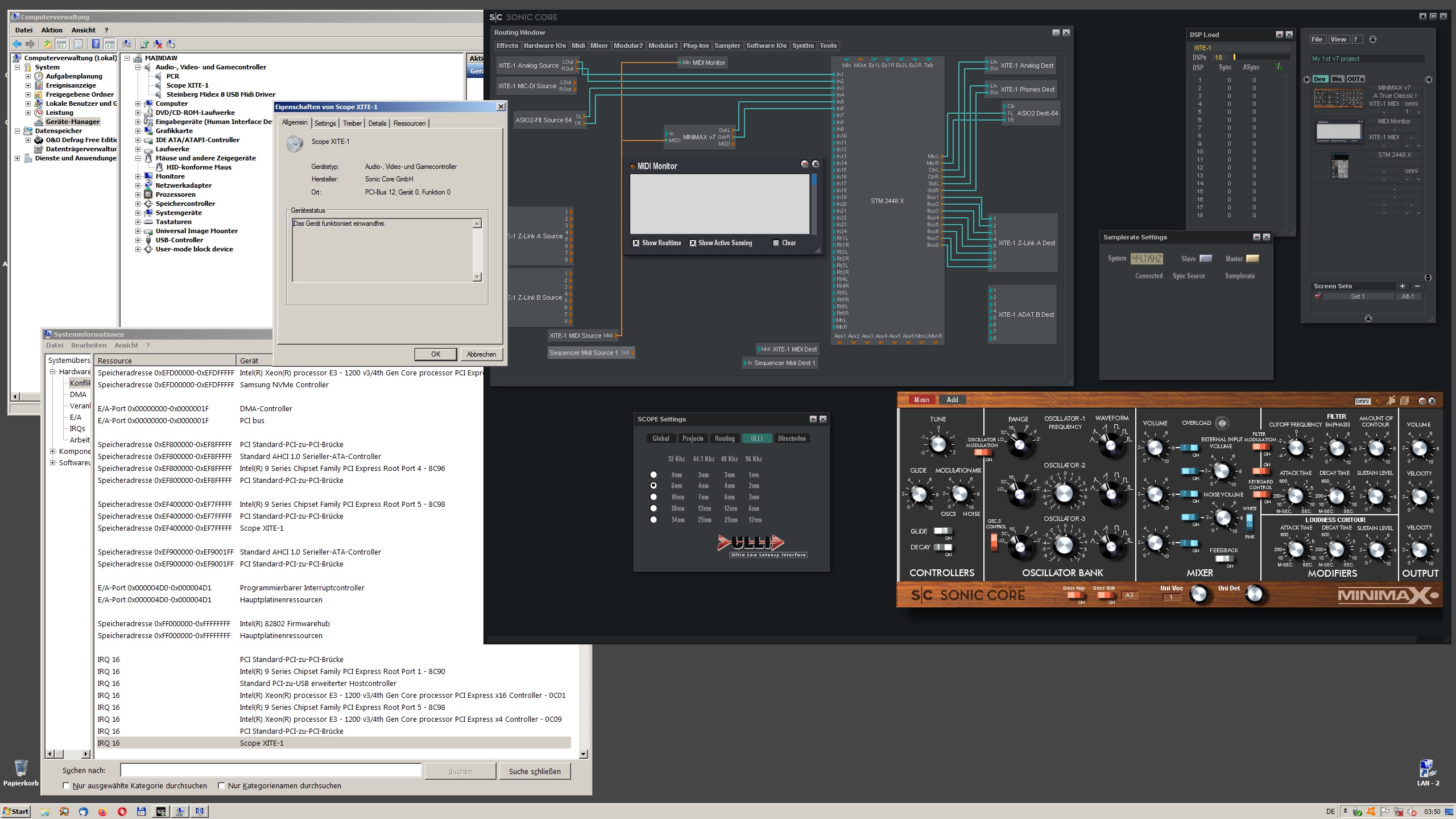

				Thx SpaceF !
Unfortunately.- same message as above.

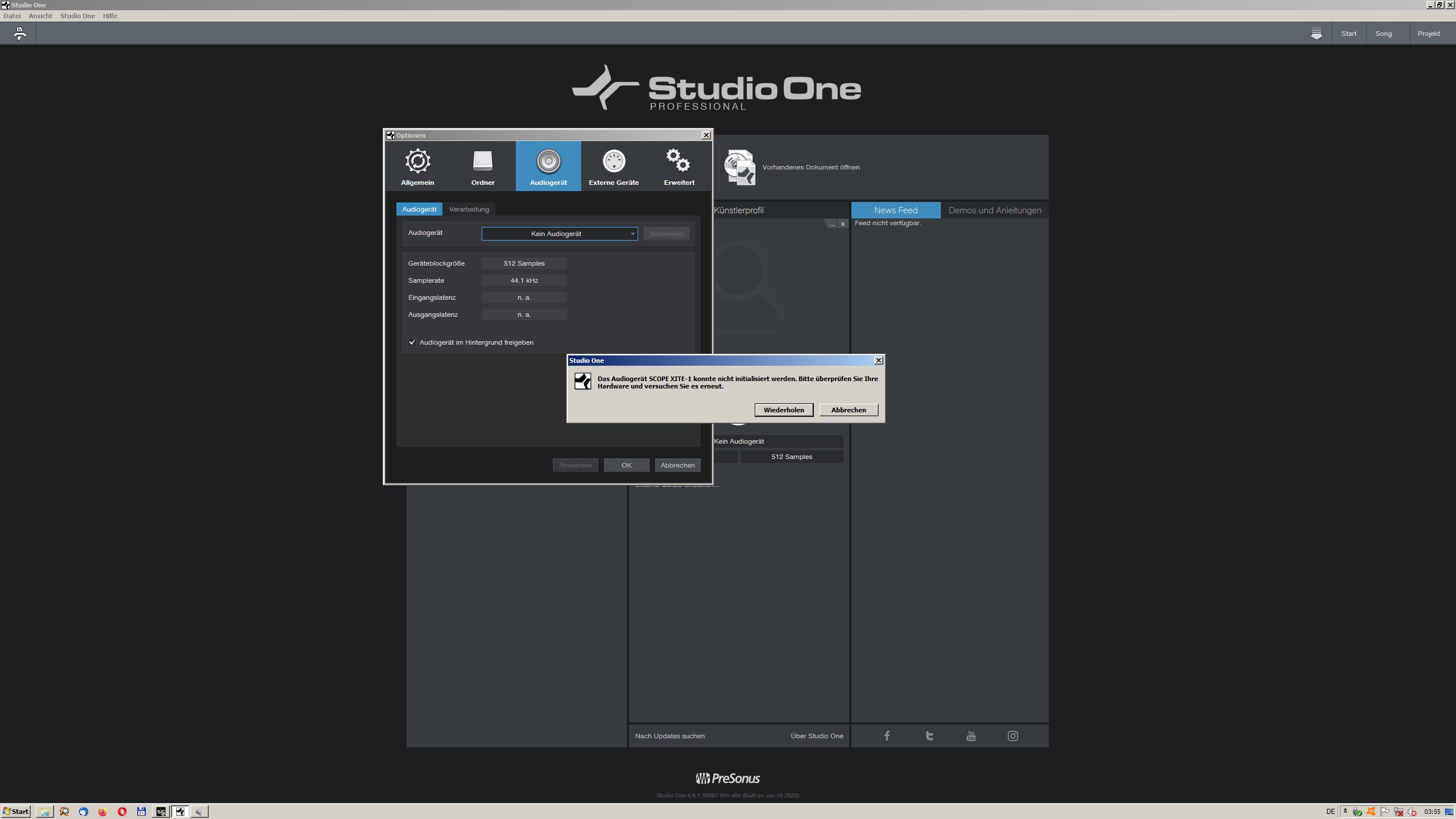

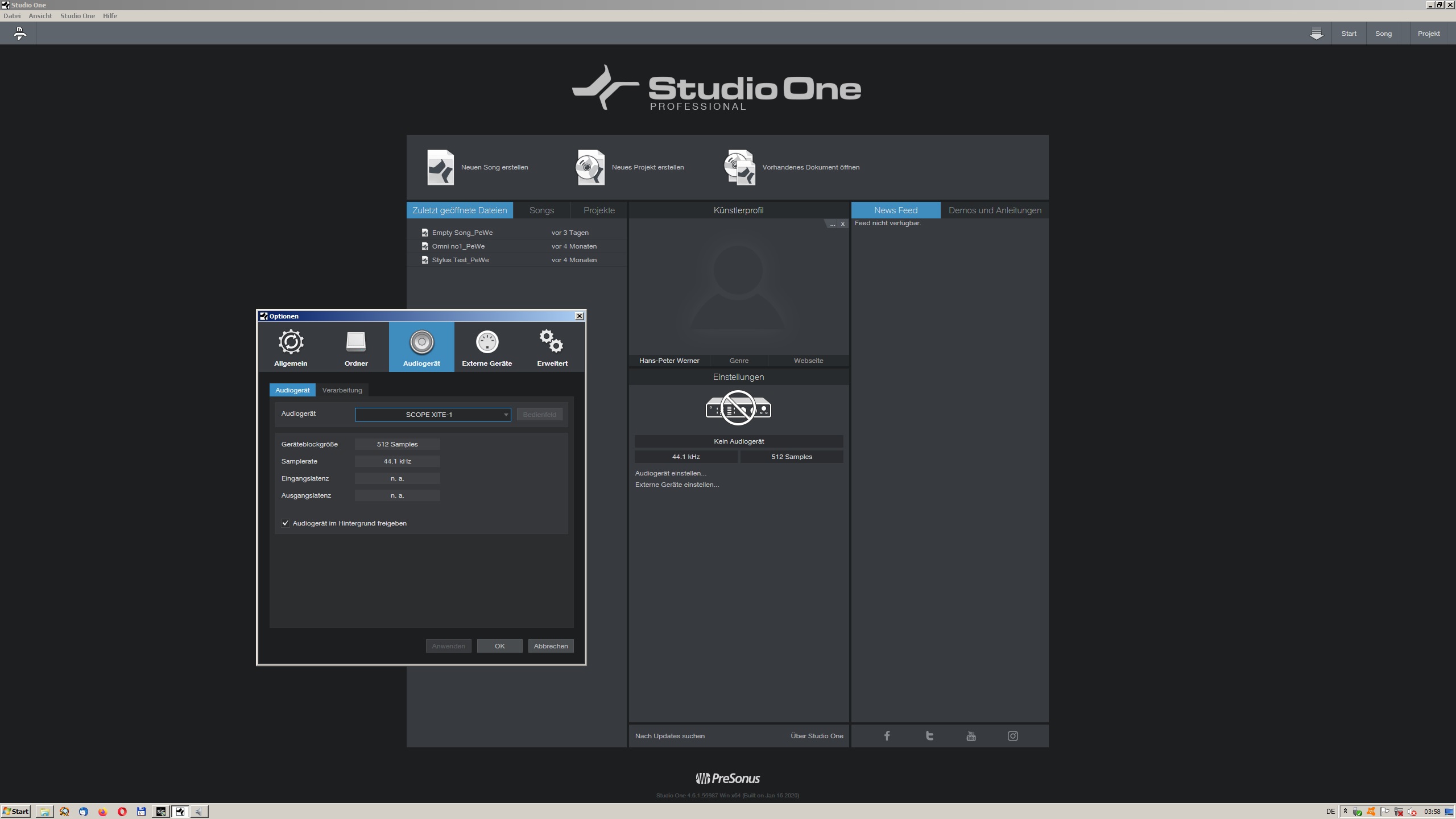

I don´t get any sound out of XITE-1,- SCOPE v7 standalone,- or as the ASIO audio device for Presonus Studio One Pro 4.x, Reaper 6.0.8, Reason 10.4, Reason 11.2 (or any standalone audio application requireing ASIO).
In DAW apps I can select SCOPE ASIO, but impossible (pre-) selecting audio channels like ASIO #1+2 p.ex.
I also get no MIDI into the project even I double checked (by connecting to another  device´s MIDI In) controller keyboard´s MIDI out and MIDI cable works.
The machine worked well w/ Realtek onboard audio, ASIO4ALL, that controller keyboard and all the apps and plugins I have installed.
Now, after I installed SCOPE v7 latest build, nothing works.
Win7 Pro SP1 x64 device manager shows PCR / XITE-1 and Steinberg Midex-8 as "Video-, Audio,- Game Controllers" ... no conflicts like "yellow warning triangles w/ exclamation mark",- and properties for XITE-1 report it works perfect.
MSinfo32 shows XITE on IRQ #16 together w/ several other devices,- but no conflicts obviously.
It´s not about performance at all,- it simply doesn´t work,- no MIDI in, no audio out, no chance to check out ASIO I/O channels.
I recognize SCOPE/XITE, running as master (and until my masterclock arrives), syncs S|C "blackface" A16U as slave perfect to SCOPE S/R setting of 44.1KHz via Z-Link.
I don´t even get sound out of XITE-1 "phones destination" ... possibly because I cannot trigger Minimax v7 via MIDI ...
In Win7 audio configuration settings, I see XITE-1 for playback "speakers" twice (one as "standard") and 2x SPDIF too,- but cannot configurate.
Nothing happens when I click on [configurate] tabs ...
Same for audio input/recording/mic settings.
I also don´t see XITE-1 DIN-MIDI I/Os elsewhere ...
Never had such problems when I bought XITE-1 and installed SCOPE 5.1 on Win XP SP3 machine,- just only the project load times were insanely slow because of mobo data thruput (PCIe v1.1) and SATA-2 HDDs.
Oh well, what a frustrating nitemare.

				Re: Scope/XITE > Exception
				Posted: Mon Apr 20, 2020 3:49 am
				spacef wrote: Sun Apr 19, 2020 10:49 pm
have you tried installing scope again ? (over itself) ?
I´ll try,- but possibly it´s not the culprit...
I made a "My 1st SCOPEv7_XITE" project after I installed SCOPE v7 which already IS the latest build available from S|C ftp - server.
The project loads fine and VERY quick compared to my experiences w/ my outdated WinXP machine.
I can do everything in the environment,- doing all the wireing, load/remove devices, open preset lists for STM 24/96X mixer and Minimax v7, set sample rate as also ASIO buffers in ULLI.
I just only don´t get (actually) XITE-MIDI-In to work as also not any sound out of XITE-1.

AND,- in my case, initialization of ASIO in DAW apps don´t work,- so it´s NOT o.k. in Studio One and all the others too.

And @ Spielraum: I don´t have XITE-1 non-functional driver, marked w/ yellow warning exclamation mark, like you have above.
Sorry for the small size of my pics above,- it´s original size when converting from bitmap (Paint) to jpeg/jpg.
Possibly hard to recognize w/o using windows screen magnifier ...

				Posted: Mon Apr 20, 2020 8:58 am
				Hi Gary,- plz see 1st post (and my follow up posts).
I cannot get SCOPE v7 x64 (latest build for S|C server) to run on my machine.
(AsRock Z97Extreme6, i74790k, 32GB GSkill DDR3 RAM, Seasonic PSU, Samsung Pro SSD (SATA) for OS, programs, Samsung & Patriot NVMe M.2 SSDs for samples, another Samsung 850EVO for data like VST presets etc., WD Velocity Raptor SATA3 for recording.
Worked before w/ ASIO4ALL (256 samples/ 6ms roundtip) and Realtek onboard HD-audio.
I deinstalled ASIO4ALL and deactivated Realtek devices before I installed SCOPEv7.
I get no warnings nowhere in devicemanager and all is reported as to be ready and to work well.
MSinfo32 reports XITE-1 on IRQ#16 together w/ several other devices.
I replaced Pulsarconfig.pep to make XITE "master" for the time being, have S|C A16U connected which shows (green LEDs !) 44.1k and Z-Link on front panel.
When launching SCOPE,- I only get the message:
Exception
FreqText1 has no background
When I click o.k.,- my new project launches already.
It has Minimax and a MIDI monitor device together w/ STM24/48 and some I/O,- nothing to call home about.
Samplerate settings show [System] palegrey (!) 44.1KHz and golden/yellow "master" button,- but I can also switch between master and slave which alternately changes button colors (blue/yellow).
No MIDI In using XITE Din-Midi connector,- no audio out.
All the above is SCOPE standalone !
In addition,- in DAW apps, I can select SCOPE ASIO,- but no I/O channel selection possible in preferences of Reaper, Studio One, Reason or whatelse.
I installed MS Visual Studio redistributable x64 (and x86) beginning from 2008 ´til 2015_17_19 which is the latest.
Some of the older came w/ VST stuff and SCOPE anyway.
Latest .NETframework 4.7.2 and 4.8 too.
There are no problems w/ the machine, just only w/ SCOPE v7 x64 installation.
I installed and deinstalled twice meanwhile,- same results.
B.t.w., I recognized the the original PulsarConfig.pep file after installation has different size than the support files we can rename to make XITE-slave or master.
So, when it´s true XITE-1 is by default "slave" when SCOPE is installed for the 1st time,- that renamed "slave" file has different size too !!!
How comes ?

After that, any project loads,- but no MIDI, no sound.
I lose patience.
I better go back to 32Bit w/ SCOPE.
What I get here is a driver issue and I have no clue how to fix.
The PCIe card for XITE-1 is pretty well recognized in device manager and works.
If it didn´t, I got no project loaded.
B.t.w,,- in SCOPE environment w/ project loaded,- I don´t see any DSP load or Async percentage !!!
Zeros only !
Any idea ?
				Posted: Mon Apr 20, 2020 5:23 pm
				garyb wrote: Mon Apr 20, 2020 3:59 pm
v7 works on those motherboards, usually.
something seems really broken with your setup, but i have no idea what that is.
you can't really see hardware problems with the XITE in Windows. Windows has NO IDEA what happens inside the XITE. either the driver is installed and working or it's not, but the XITE itself is not really involved in that, not specifically.
Yep,- what to do now ?
 is that a newer version of Studio One? did you try using win8 compatibility mode for Studio One?
fugeddit,- because it happens w/
EVERY DAW app I own
AND in SCOPE standalone mode.
The cryptic message appears when I launch SCOPE v7 and from there no MIDI/audio.
No other DAW app in the ballpark, no standalone VSTi or such.

XITE works in a way,- the driver would never been loaded when XITE-1 would not power up and the via Z-Link connected S|C A16U shows slave mode and 44.1K.
When I shut down PC and switch off XITE-1 and re-boot,- there´s no XITE-1 visible in device manager.
So, when it powers up and I see XITE-1 in device manager, it doesn´t indicate it works ?
What about PCIe card ?
Can it be the culprit ?
Can I uopload 2.345MB attachement here ?
I collected all the screenshots from system settings etc. ...
Would that help ?
