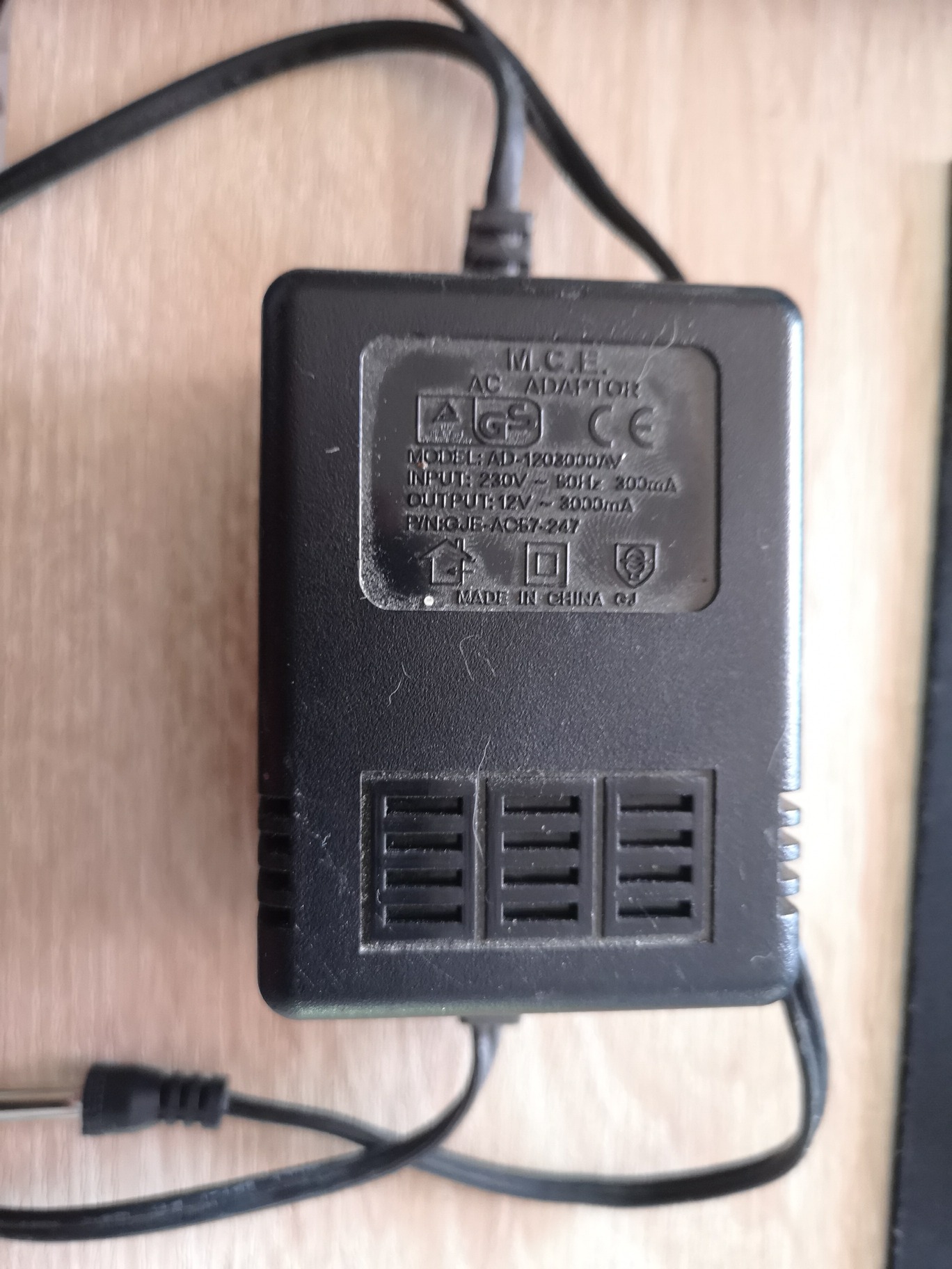

After checking everything, and before throwing away my A16 ;)
As I bought it second hand, is it the original power supply, if not which power supply do you advise me to use?

Posted: Thu Apr 16, 2020 6:31 am
that should work, i believe. did you put a meter on it?

by Strictly East
14/15v but not stable

Re: My A16 Ultra's going to trash..
Posted: Fri Apr 17, 2020 4:08 pm
Strictly East wrote: Thu Apr 16, 2020 2:04 am ... is it the original power supply, if not which power supply do you advise me to use?
Original or not doesn´t matter.
For A16U you need output AC 12V / 1.5A.
For my S|C "blackface" A16U I have AC 12V 1.6A and for my CW A16U there´s a much more bulky AC 12V / 3.5A.
