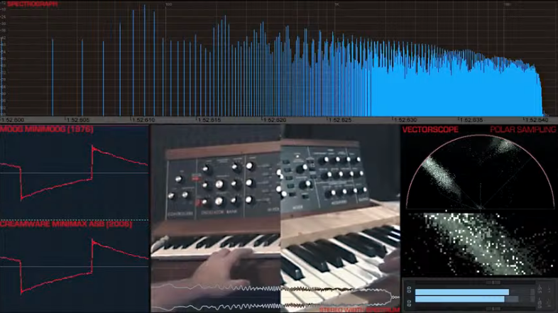

revealing A<>B comparison
thx for this cool and wounderful presentation!
Minimoog vs Minimax (vectorscope, spectrograph & waveforms).PNG (532.42 KiB) Viewed 42577 times

Minimax is a great Minimoog D emulation.
I owned 3 original (and modded) Minimoog D and still own one which actually is in service.
But also w/ the hardware,- it sounds different when playing the Mini via MIDI or via it´s Pratt-Read keyboard.
It´s similar to a Hammond tonewheel organ´s key contacts which are part of the sound.
The Minimog D´s keycontact springs don´t only close/open.
They smear over the busbars and it´s different for every single key since the alignment isn´t 100% perfect.
besides audio artefacts, one of the results is slightly different trigger point of VCF- and VCA- ENV per key.
None of the software emulations mimiks this.
The other difference is when using the audio loopback (audio-out back into pre-filter ext. input).
In fact, this behaves different in every single vintage MInimoog D already,- and what Minimax does in this department is sonically worlds apart from what my Minimoogs did.
Then, Minimax has a graphic bug in regards of it´s octave/footage switch.
Typing from my head I think it was in OSC #1 ... maybe #2 (?) ...
It annoys me all the time because it looks different than it sounds.
And,- when dialing in some of the "jan-hammerish" single OSC, clicky-percussive nasal flanged sounds,- the output level becomes very low and there´s no compensation for in Minimax.
It´s because when you want that clicky sound, normally produced by the keyboard contacts in conjunction w/ VCA ENV Atack/Release and Sustain settings, you´d have to set VCA sustain level below 6 or even lower and then don´t have any gain boost option when master volume is already 100%.
I dunno how it is w/ ASB/Klangbox which you run into an amp which itself is a gain boost option then,.- but in SCOPE it is like described above.
In SCOPE it helped running into an amp sim though,- but then it´s often crap to have Minimax´ FX before amp, especialy the DLY,- but sometimes also Cho or FL.
