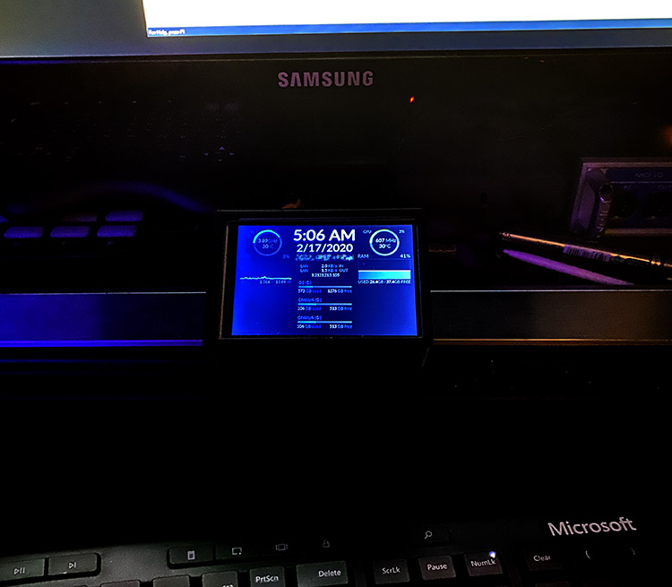

The next step is to go into the Preferences > LCD > LCD Options submenu item and start to setup your monitoring screen. I set mine up to show CPU usage & RAM usage as a line-type bar graph, show CPU temp & speed with both numeric & 'dial' type readout, and the same for GPU speed & temp (inner & outer rings for each, mirrored on each side of the display). Time & Date are center along with machine name and ip address, under which I am showing network up & down rates, and then CPU Core Voltage & Wattage next to that along with used & free memory values (text in addition to he bar graph above). Lastly my drive usage in used/free values along with a bar graph and name+Drive letter. Next to that is drive temps and i/o speeds per drive. This will actually be useful for my video work as well as I have a drive I use for frame store for things like After Effects & Nuke/Fusion.
Here's what this looks like, when viewed from my raspberry pi in a 3" touchscreen case install:
In this image, I had not yet setup drive speeds and only had 3 drives defined. There are 5 present in this PC and several more remote shares mounted, which I have now added to my layout (though the remote ones are in a subsection as they have only usages and drive full meters, no temp or i/o rates). See below for my raspberry pi configuration.

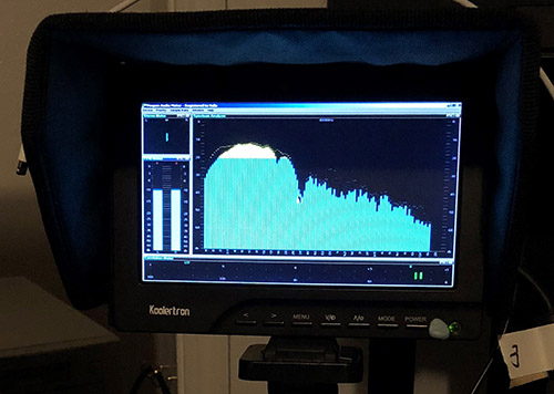

I use a few 7" LCD monitors of the type intended for recording ('ala DSLR mount, for instance) or monitoring video, on an HDMI or DVI>VGA port while doing visuals, and I use one attached to an ancient 12W (max) Dell celeron/atom microcomputer with Pinguin Audio Meter (non-Pro) running on it as it runs best on an XP machine (GDI+ GUI has no lag for it like Vista and Win7/8/10 do) and it's great to have it sitting there monitoring the master bus on my analog mixer at all times. Plus with it running the machine eats more like 7W max, and the 7" LCD can run quite a few hours on 4 AA's so it's not consuming a ton of power either.

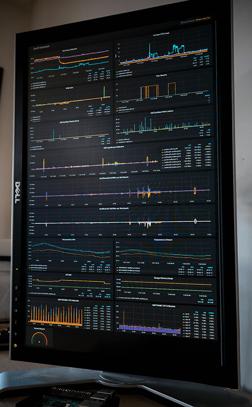

I have played with using my Pi's to display data from something like NEMS, Grafana, and have also displayed data from balenaCloud using Screenly when I was working as Marketing Director. It's fun displaying network statistics from my router & main storage machine here, remote monitoring the web-server this runs on and displaying uptime and usage %'s. Sometimes I do it on local PC, sometimes I run something on a Pi to keep an eye on a machine under heavy use (rendering or when the web-server is experiencing...interesting traffic patterns & login attempts). BalenaCloud looks something like this when setup on a large enough monitor:

So, Grafana was a fun thing to play with during some downtime, but getting the metrics to show up that I really want to see is requiring a lot of time setting up scripts to serve as the data interface (I'm pulling data manually from Google & my webserver etc, as grafana has no plugins for these things). Since I'm time limited at present, I'm either going to retool my Grafana-Pi into a Zynthian synth or perhaps build a MOD Dwarf to goof off with (one of my rack effects units just died and needs servicing, so this would be a fun stand-in in the meantime). My last paragraph above with NEMS, or just email notifications, will give me the basics of what I was thinking with Grafana (inform me about issues on the webserver or with client sites etc) without as much work, albeit a lot less pretty on the eyes...
The Touchscreen Pi I have monitoring my PC's now rotates between 5 screens to show 5 machines. That worked out well and was relatively easy given that AIDA64 does the bulk of the heavy lifting for you.

Well, I was using Grafana headless and an original Intel stick running Ubuntu for the remote display, using a web browser. The default Ubuntu 14.x that it ships installed loses wifi with any modern update, and is very sluggish in terms of UI. I have been running 18.0.4 but it blows up constantly too! So that whole setup is just fragile beyond belief. It's only 2 years old (replaced last year) though they've been out since 2015, you'd think the low end option would have solid debugging by Intel. Having to grep dmesg & cat-ted logs constantly to keep this thing running is rediculous. Also it performs worse than a Pi as a desktop, which makes me think the Intel Stick i3's would probably be the base version for any kind of usability, which is just too costly for what these things are intended to be used for.
