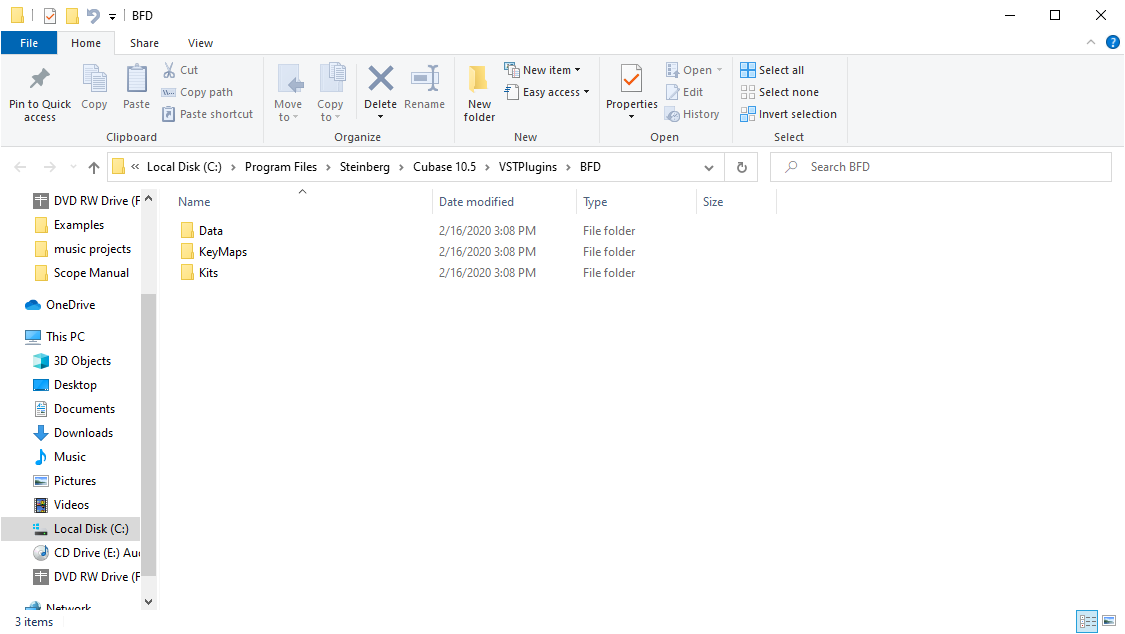

So I went to Local Disk(C:) > Program Files(x86) > BFD and copied the file
Then went to Local Disk(C:) > Program Files > Steinberg > Cubase 10.5 > VSTPlugins and pasted BFD
I am trying to get BFD to play in Cubase.
When I go to Cubase
Project>Add Track>Instrument, BFD does not show up. Where did I mess up?
