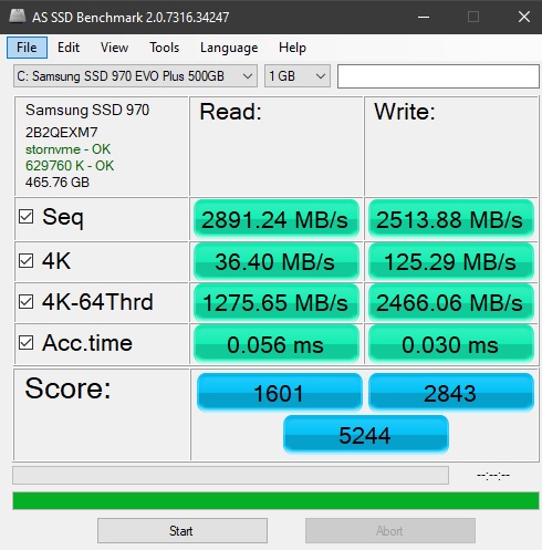

This is what I get on my Samsung 970's - is it good ?
Samsung 970 EVO Speed Test
M.2 SSD Speed.jpg (83.45 KiB) Viewed 9436 times

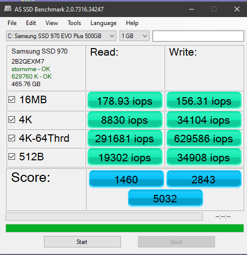

Re: Win 7 and NVMe
Good sequential but show tests with Random IOps.
100,000 IOps in random is about all we can utilize.
On sequential ASIO can’t benefit from anything over 9-1000GBps.
But you won’t notice the difference from 525MBps on SSD’s to 9-1000MBps.
Check AS-SSD Random.
IIRC it’s under tools, but it’s somewhere in the menu.
Posts: 5052
Re: Win 7 and NVMe
here tis.
random-iops
random-iops
Re: Win 7 and NVMe
3 x more than is required.
I use the Samsung PRO SSD’s and NVMe’s.
Only difference is the warranty.
