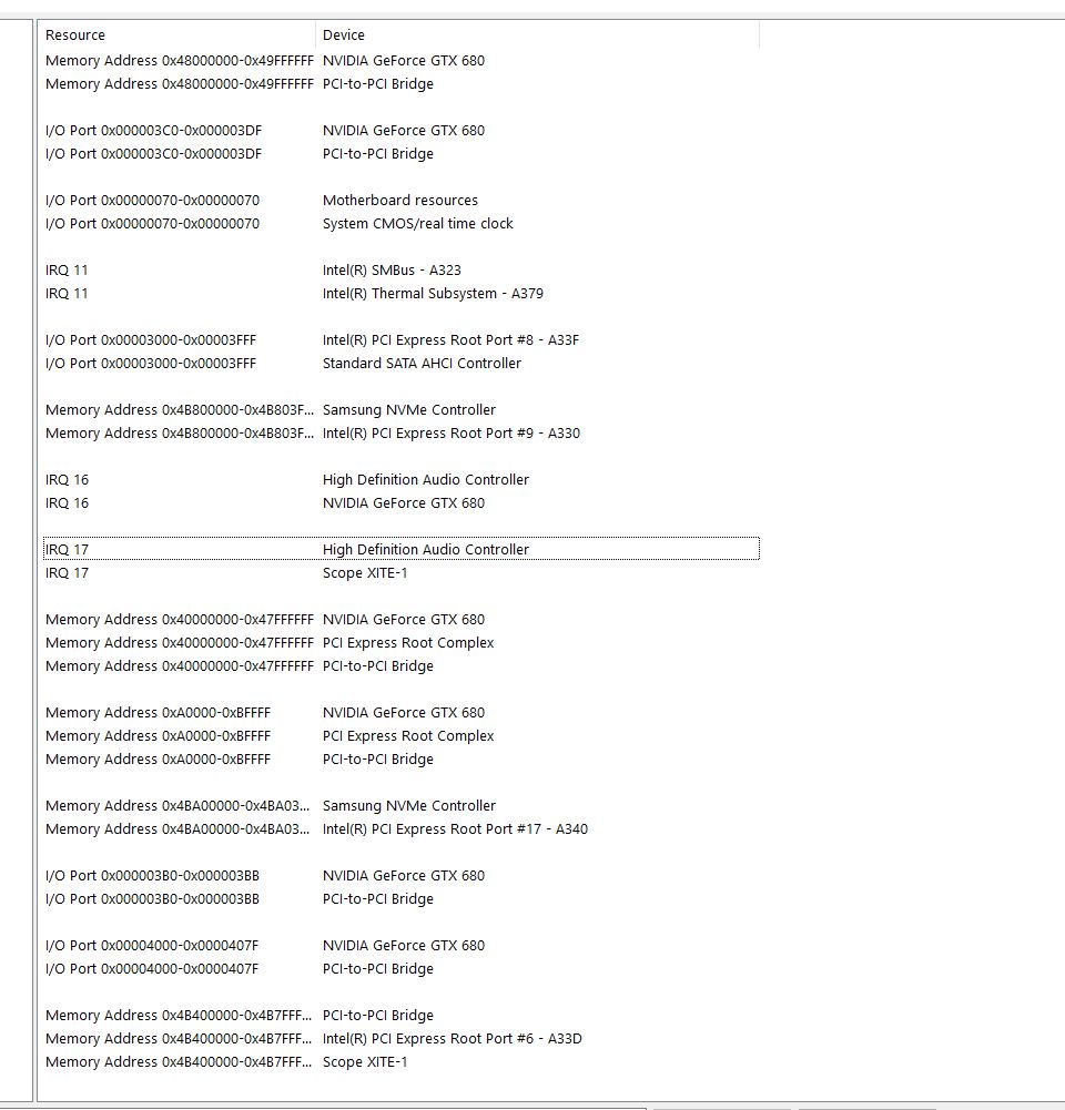

My Pc has a BSOD everytime I configure the output of a stanalone audio app to scope's ASIO,
example : any Arturia stanalone apps, Hise, Voltage Modular and Sample Robot 6 cause a BSOD
the driver on the BSOD is Scopexite.sys
This is driving me crazy, I have used driver verifier to search for conflicts and there is 1
i've disabled it in device manager,and I've tried re-installing scope, but it makes no difference
I think that maybe all these apps try to take control of the Scope driver
any thoughts on how to solve this?

this is NOT a driver issue.
rather, it is about Arturia assuming that you are a dilettante with a standard Windows soundcard. those stand-alone apps are trying to configure the soundcard. Scope hardware is not a soundcard(but it will function as one). it cannot be configured in the host app. there is no ASIO control panel. Windows does not know what happens with the dsps. this is all about people who cannot configure their own audio devices. if the program did not require a response that the Scope hardware cannot and will not provide, and the configuration process was allowed to time out, then the driver would work the way it works for your sequencer. why do you need stand-alone operation?

i would be more angry at the guys who made sample robot for making the driver/app interface that way. it is actually easier for them to just use the streams as they are and allow the XITE to control itself as it should.
have you tried the built-in audio with ASIO drivers like ASIO4all?

Install ASIO4ALL v2.14 http://www.asio4all.org/ which I use w/ 256samples/5.8ms latency and the Realtek HD Audio chip on my AsRock Z97 mobo w/ Win7 Pro x64.
To get that value of 256samples, you´ll have to change default setting of "512 samples" to "256 samples" and set "Buffer Offset" to zero (0) in ASIO4ALL- ASIO Control Panel.
Depending on application, latency might be 1ms more,- p.ex. in Studio One Pro 4.x.
I don´t have problems playing VSTis in realtime via USB MIDI controller keyboard w/ these settings,- fast runs, clusters, chords ... everything.
Simply select ASIO4ALL in SampleRobot and Hise audio settings, open ASIO control panel and make the changes, then apply to make it permanent.
Ambient Source wrote: Sat Jan 04, 2020 10:34 am ... i'd ideally not want to sell my scope system, but I dont want to buy another audio interface as a work around.
You don´t have to,- ASIO4ALL is freeware and you can use it side-by-side w/ SCOPE.
