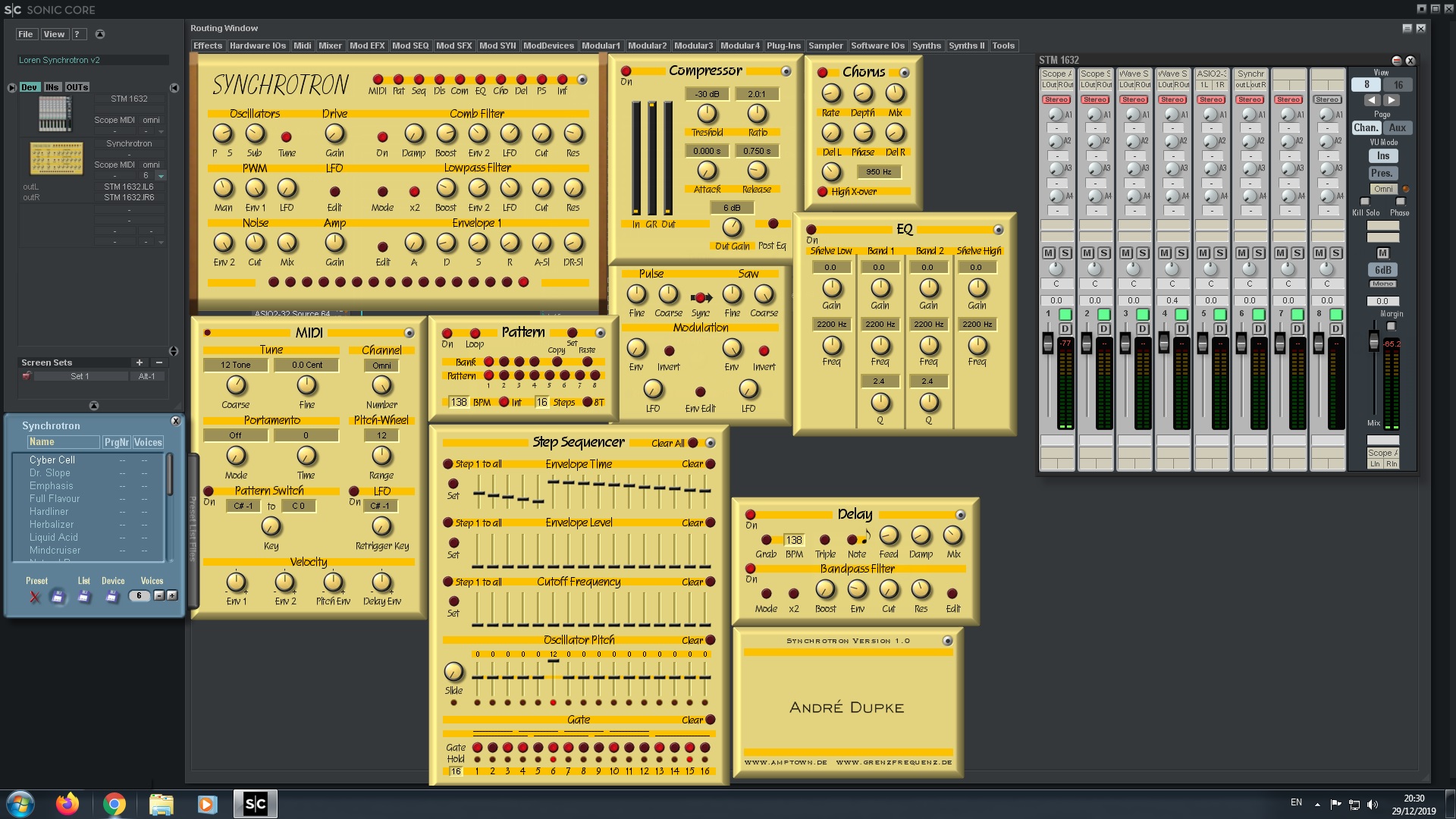

Dear Scope Users,
Need Help with Synchrotron under Scope V7
I try to play any-notes (there is a midi signal) but no sound :(
I change presets and no sound too ..
Maybe, I missed a dsp file?
My Synchroton.dev file is version 1.0
Do I miss something, how can I solve that?
Can someone help me?
Many thanks in advance
Merry Christmas :)
Loren

i don't know, but the Synchrotron is pretty old. it may not work correctly in 64bit. also, some step sequencer devices made with old atoms do not work in 64bit. are there any .sys or .dsp files associated with it?

I don't ask for any .dsp or .sys file ?!
When I move the NB of Polyphonic voices it don't affect the DSP Usage meter .. :(
Something is wrong ..
Posts: 23474
Re: Grenzfrequenz Synchrotron
maybe someone else using that plugin will have all the files. it seems that something is missing.

I have synchrotron here, but am away right now, so will reply when I am home. But yes sometimes it won’t play a sound when you change to another preset so you may have to try reloading the device and then reloading whichever preset. Also you may need to set the midi channel in both the device and in the scope device taskbar to the same channel you wanting to use. Try that and let us know. I don’t remember there being any other files needed but not 100% sure.

Try everything .. it don't work :(

i got a newer version of Synchrotron.
1.3.1c, twice even: The one with hamburg audio in the file name has preset list that stores voices with each preset, while the other one does not. Yet both are labelled same version. Weird. Anyways, maybe these work for you?

WOW it is working !!!!
The Hamburg Version 1.3.1c is working like a charm in Scope Version 7
Many thanks you and to all Great Scope Friends at the forums (Gary,Tim) !!!
