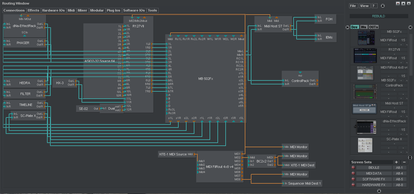

My aim is to have a single MIDI knob that, when I turn it, multiple things are adjusted in Modular.
Specifically, I want one knob to:
Attenuate gain
Boost gain of a low shelving parametric filter
...across two channels
I've been looking in Modular and I can't see a way to do it.
Anyone got a tip on how to do this?
https://imgur.com/W1PuJXk

Solved it!
Found I could use SpaceF's CC5 module so:
https://youtu.be/RBTuLUS1tec

Care to elaborate? As far as I could tell the knobs for the Vol Att and 12dB LowShelfEQ don't have control signal inputs so the only way I could think to do it was to "go outside" of Modular and pre-process the MIDI CC signals using CC5.

Following a prompt from Valis I investigated BCModular, which I'd not installed since I rebuild my PC and completely forgotten existed!
Using that I was able to make a cleaner module that just takes one MIDI CC input and duplicates and scales that to multiple controls so:
https://www.youtube.com/watch?v=SZju542Fa4g
