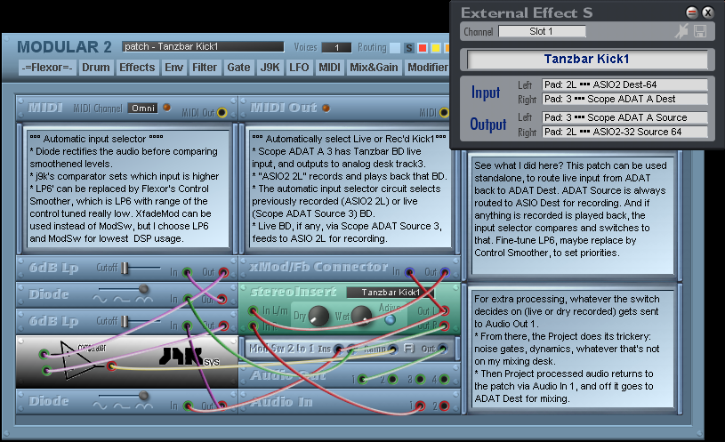

Meanwhile, came up with a lil patch that
  • does away with lots of wires in the Routing Window
  • automagically selects between live and recorded audio - not sure about this yet. will have to actually play with it some more. i'm not feeling much to spend much more DSP on this. If it comes to that, out goes the automatic selector circuitry and manual switching it will be.
  • is quite an efficient way of doing what I described in the original post above
  • may keep me from going out and seeing folks IRL for a change, on this saturday evening. err. disregard that. :lol:
I hope this doesn't confuse the hell out of some of you:
automatically selects live or recorded source for DSP processing then external mixing

After some more trying, seems the patch works just great. With both live and recorded audio active it switches inadvertedly, as the automagic switching is very crude, but then it's a matter of me choosing what channel to mute/unmute in the DAW.
I will now do different presets of that very same patch containing different saved versions of the External Effect, and populate the project with that. And make a stereo version, a different patch with 2 Ext FX. I expect DSP usage and amount connections to remain pretty low when scaling this, so should be ok. I'll update when done.
Most of the work is human batch processing in assigning IO to the External Effect in the project, saving the External Effect, deleting it, loading it again so it can be named in the Live Bar, and then save the final version. For each and every HW device.
Oh, and the Audio In takes Direct Output from the STM, which is used for gate, dynamics, other stuff I don't have in hardware. Once the Direct Outs are set to Hide on the STM, the connections will be hidden in the Routing Window.
And for the stereo version, using 2 Ext Fx, the xMod/Fb Connector can go. And all them text modules are going out, too. These were there just for explaining the patch in the screenshot.
Sorry for thinking aloud here, but maybe someone else, too, can find a use for such.
more has been done with less
