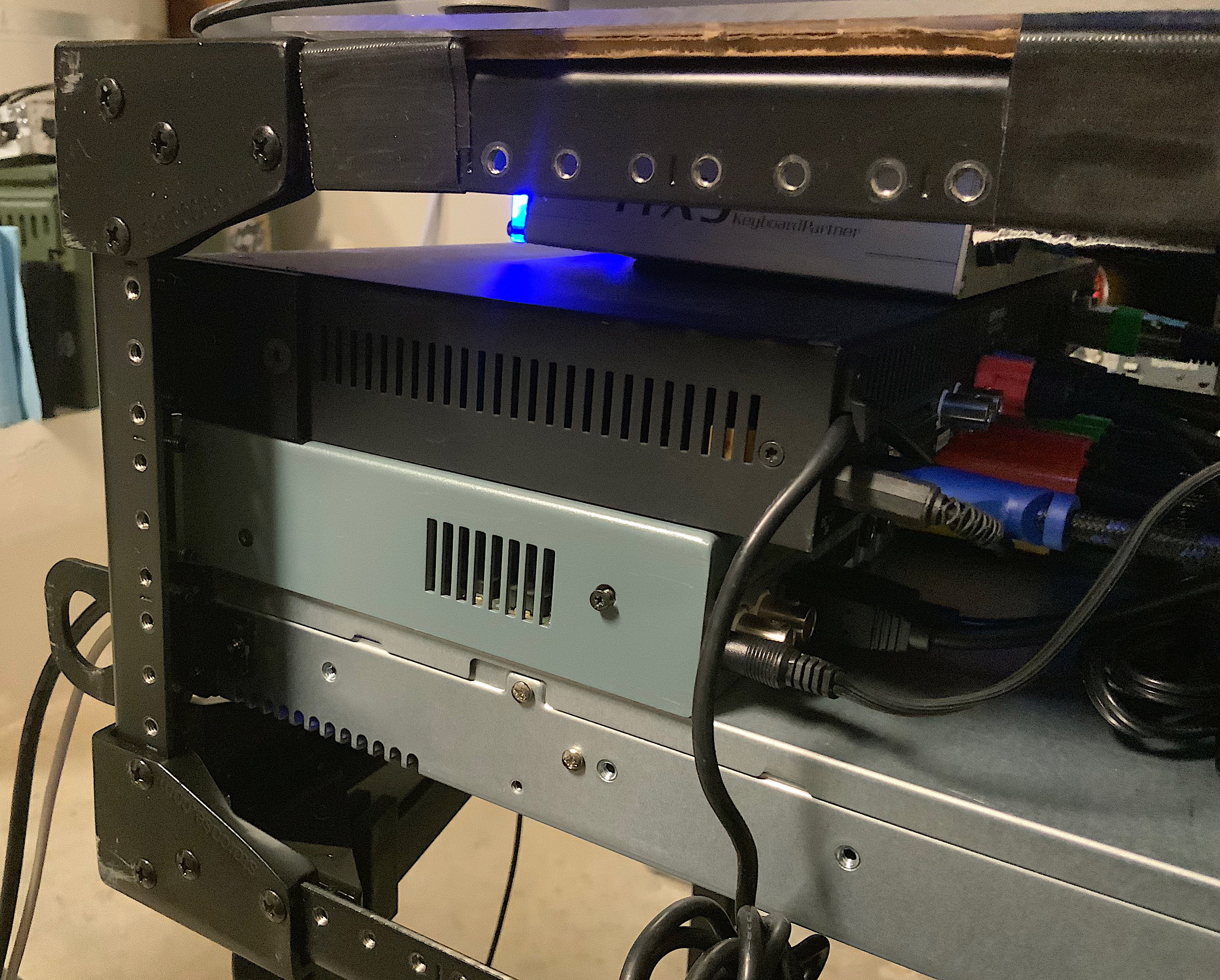

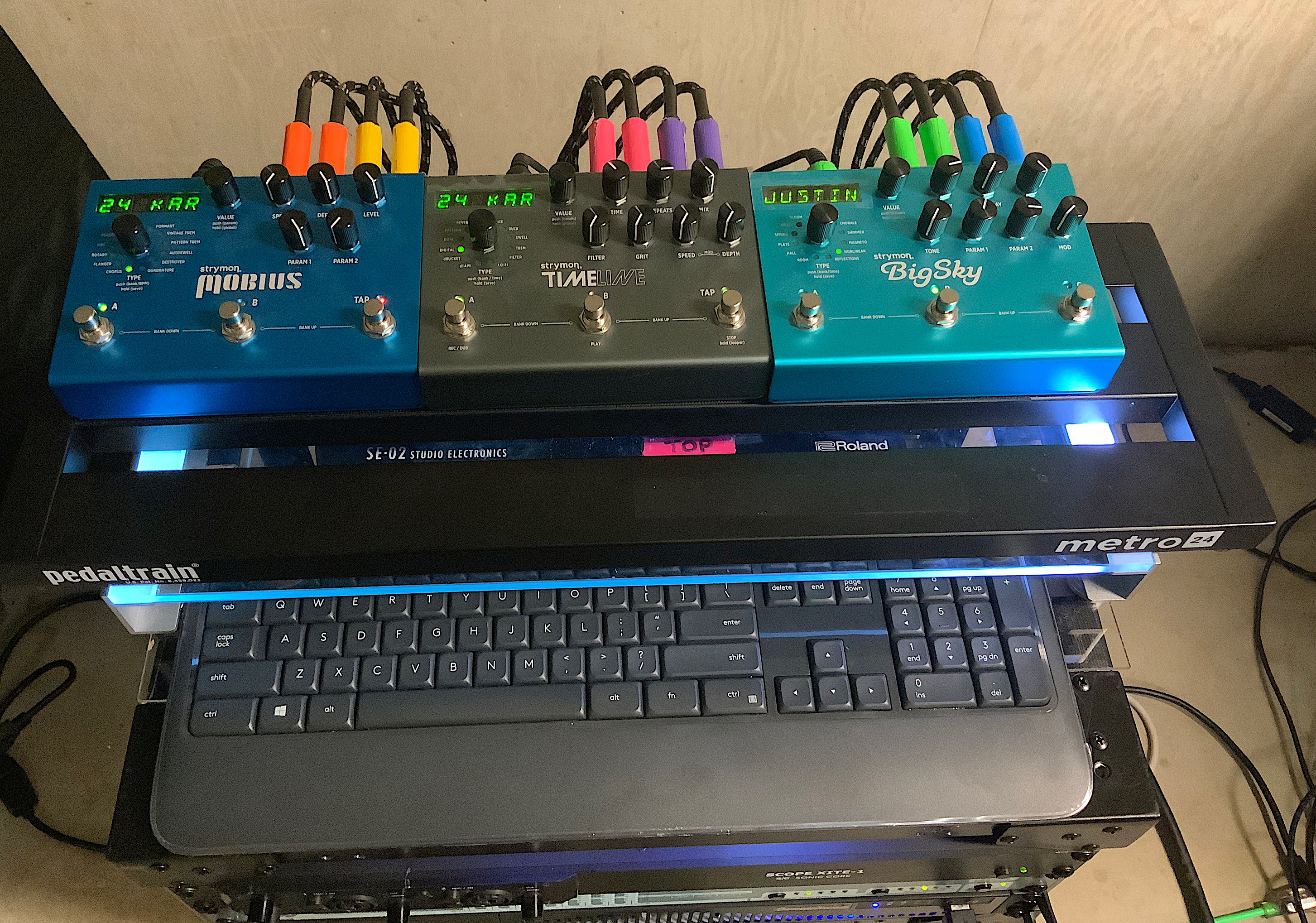

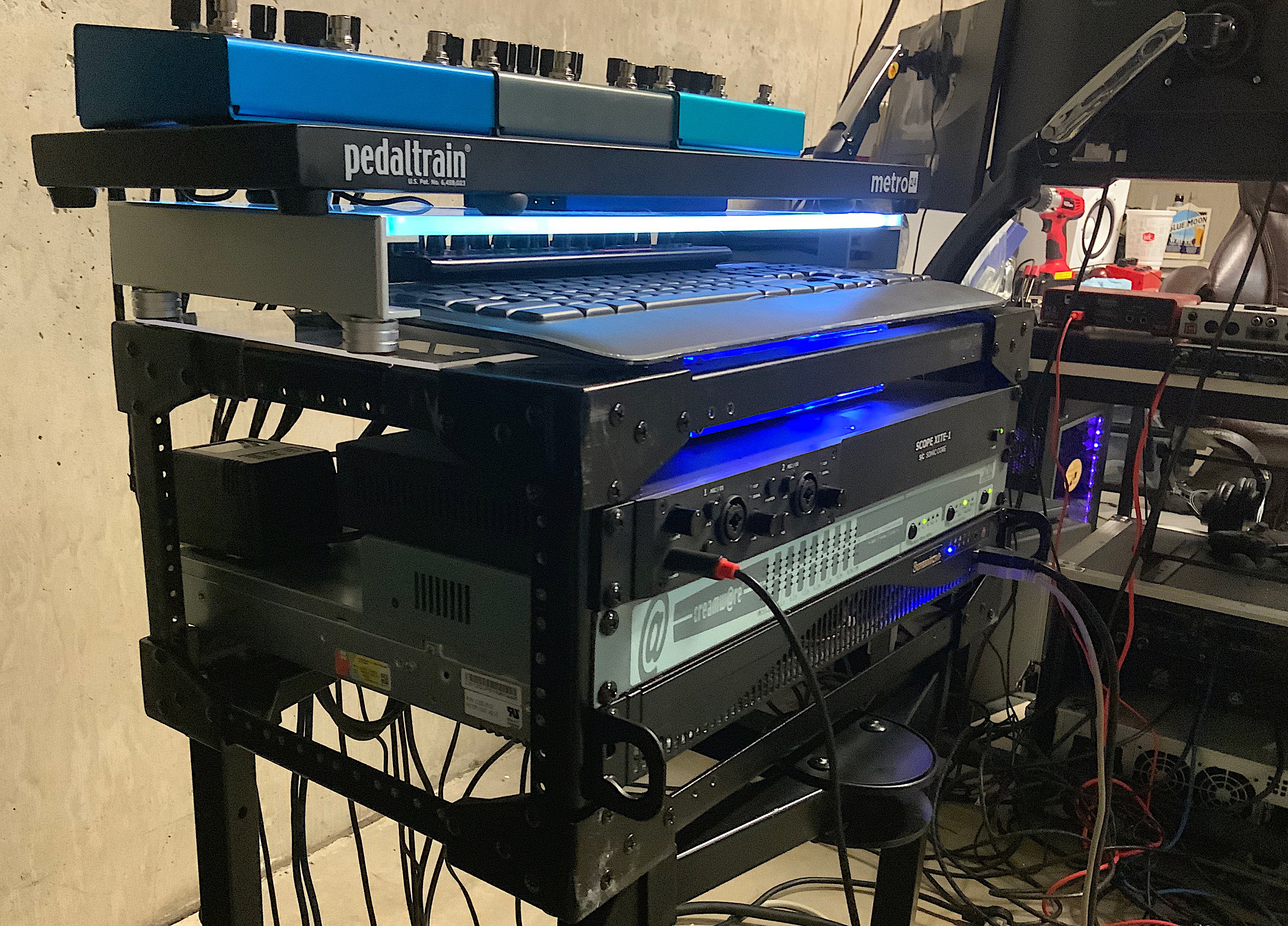

I run an Analog Synth, a Hammond B3 Organ Module, and 3 x Strymon Pedals.
All using the various Soruce and Destination Modules, but the Master Effects Module houses the Strymon Pedals, Mixer AUX channels sends and returns go in and out of the Master Effect Module.
They sound great.
Heres the mobile rig. Underneath is the Synth and B3 Module, Pedals are on top.

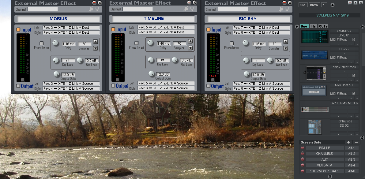

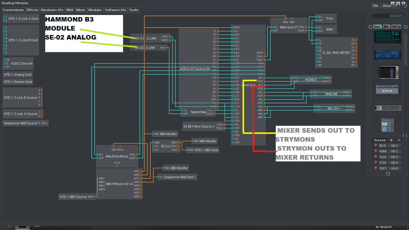

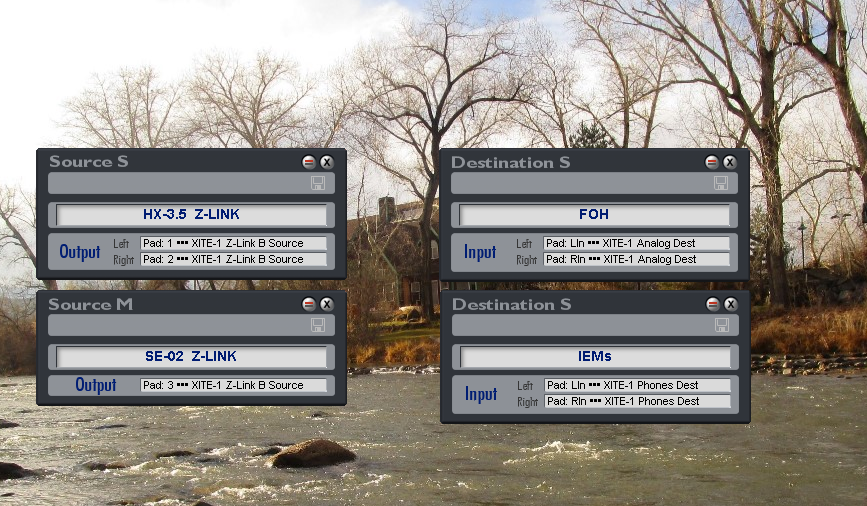

Posted: Thu Sep 19, 2019 12:49 pm
Heres everything coming into and out of my Scope Project Window
The Z-Link connections are an ancient A16 that sounds as good as every other converter costing 1800 or more.
Those are using Master FX Modules because they are in and out, where as synths use Source Modules, outputs to FOH or IEMs need Destination Modules.

dawman wrote: Thu Sep 19, 2019 12:49 pm Those are using Master FX Modules because they are in and out
No need if you do not need the dry/wet, phase or delay: you can use Externel Effect ;)
As for the 12dB gain you add there, IIUC that's to compensate for the dry&wet internal mixer. Give it a try.
Only reason you might need this one is if you want to crossfade dry/wet somehow during a performance without crackle, I see you added some delay to the signal (delays the dry to compensate for external routing delay, so dry/wet remain in phase, so maybe that's what you do)
Re: external fx processor / routing advice
Posted: Thu Sep 19, 2019 6:23 pm
at0m wrote: Thu Sep 19, 2019 2:26 pm
I have to always adjust phase/wet/dry as well as db from AUX sends/returns.
I eliminate any coloring as I made sure my Strymons were high quality transparent FX.
They get phasey from the multiple TS connections.
Once I get what I like its saved with the project.
Never had issues with Analog Effects.
But even my HX-3 FPGA Based Hammond B3 Module needed some adjustments on the mixer channel.
But whatever is needed Scopes tools always work out well.
A really nifty device was a Stereo insert by SpaceF with sample delay.
Im very happy with my live rig.
Turn it on and play.
No need for a mouse and QWERTY once I start.

Just 1 more thing @dawman does this mean each strymon is plugged separately to dedicated physica in&out?
Posted: Fri Sep 20, 2019 5:08 am
by t_tangent
Interference wrote: Thu Sep 19, 2019 11:44 pm Just 1 more thing @dawman does this mean each strymon is plugged separately to dedicated physica in&out?
Yes, judging by the photos you can see the I/O to and from Xite's Z-Link, which is then going to the A16 Ultra A/D D/A physical in outs and the strymons are connected to that
Scope Z-Link modules have 8 ports A and 8 ports B :)
