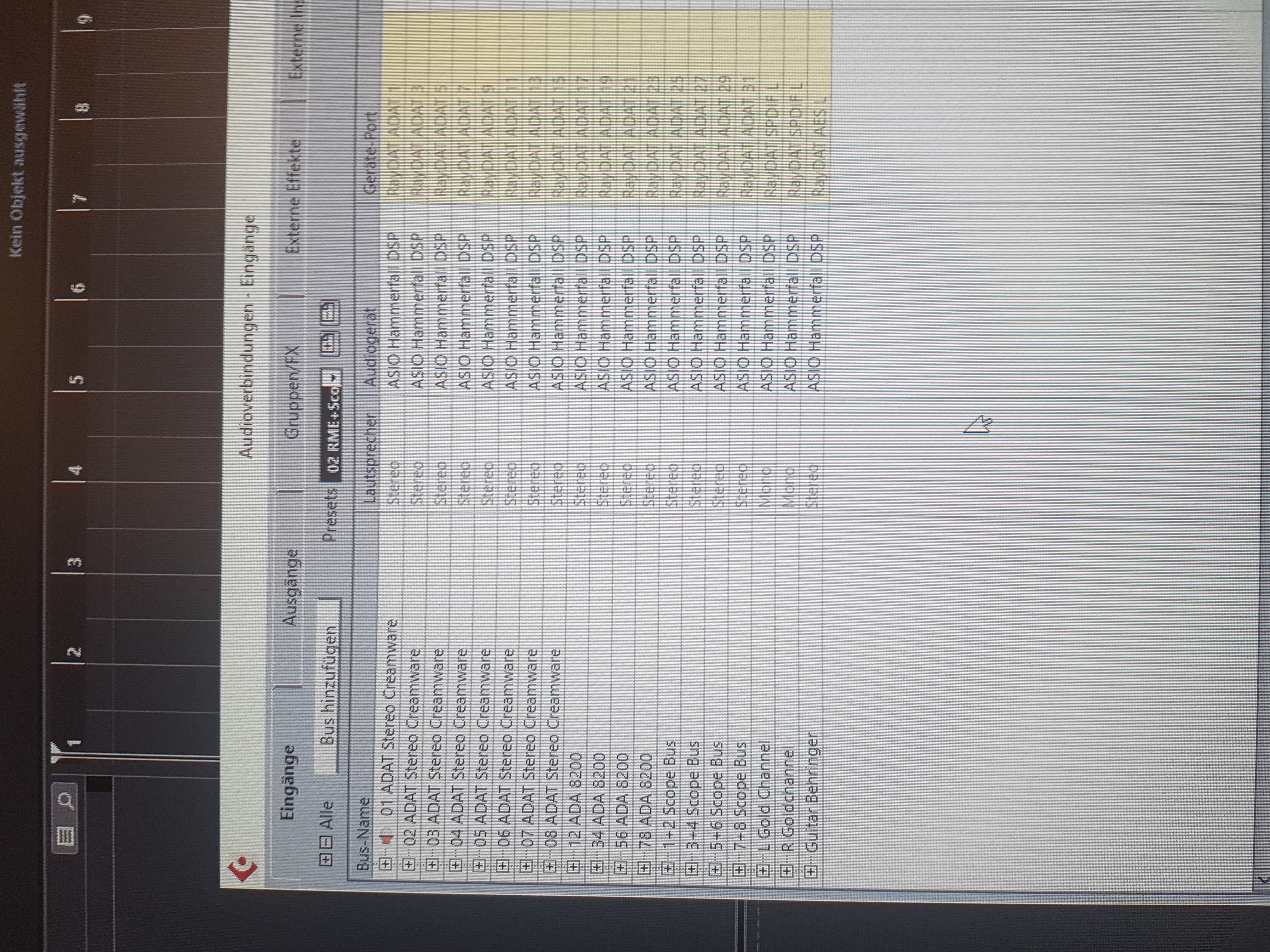

Hi guys,
FIRST I WANTED TO THROUGH MY SCOPE CARDS INTO GARBAGE AND BOUGHT A RME RAYDAT ........ BUT THEN :
I killed the drivers of scope in the Arrangement
Windows and connected one ADAT IO with 8 audiostreams from scope into my RME raydat within one PC! And it works. No f##cking pci Overflow messages anymore! Because to many audiostreams kill the pci bottleneck. (only 8 card succed)
I use scope a like an external mixer and more going into rme's Adat connections. And use 24 more Direct Adat connections ifrom my A16 nto rme's Adat connections. I load rme's asio drivers into cubase, and it works great!
Rme's latency is extrem low because pcie!
I m not forced to Start scope if I dont need it. I can work with cubase only. I have combined both advantages of both worlds and enjoy the benefits.
Did you do the same? Do you have experience with this type of connection? I Route audio streams via the Bussystem throufht rme's lightpipe into cubase for more fun!
Do you have any Tips or tricks?

Re: RME raydat AND scope connected together!
Hi Marco,
I had a similar setup about 12 years ago (maybe longer) with the old RME DSP 9652 and had a reasonable amount of success with it.
There is one thing that irks me as I read your post and that is that I should have used the RME ASIO driver and not the SCOPE driver . it was by far the more superior driver and I'm kind of kicking myself for not doing this and the various routing connotations at my disposal. Saying that I can't remember if the totalmix software was included with those early cards which may have had a impact on the decisions I made at the time.
Using SCOPE's mixers as your main console and using SCOPE's processing to power it's synths, effects and midi tools is a very efficient way of working within the box.
I would record the mixer's output with a audio editor like Wavelab with the wave driver only (it was more stable for me). That was a long time ago but these modern computers would handle it no problem.
Don't forget about RME's totalmix software for extra routing possibilities (it's worth a look)
Good luck with it.
Regards
Simon
Totalmix has always bee present on RME cards, and I concur about the routing possibilities (I have 3 RME cards connected to my Scope cards). However I will mention that attempting to mix in Totalmix isn't worth it. Switching between the Matrix view (X) and the Mixer view (M) however is well worth it!
Marco,
I use RME cards on separate machines and keep Scope in the same machine it's been running in pretty much since I got my first card. I personally find this to be the best of both worlds, as I can tune the machine around the software its running.
If you use modular, have a look at the SAW ramp flexor stuff for generating your clock, recording those ramps into your DAW (on an audio track) and then sending that info back to modular in time with your DAW's timeline is the most rock solid timing I've ever found with any gear, hardware or software.
Thank you very much for the flexor hint. Yes I have flexor. I feel very relaxed now after this fight.

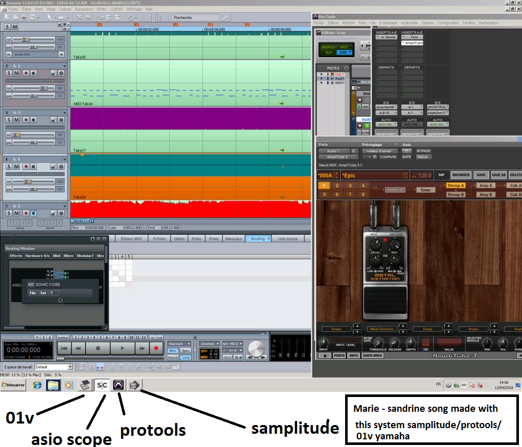

hi i make like you working scope 5 with protools hd so powerfull no more latency real time playing recording with RTAS plugins at 64 samples !
- protools hd salved by samplitude.png (755.33 KiB) Viewed 10723 times
