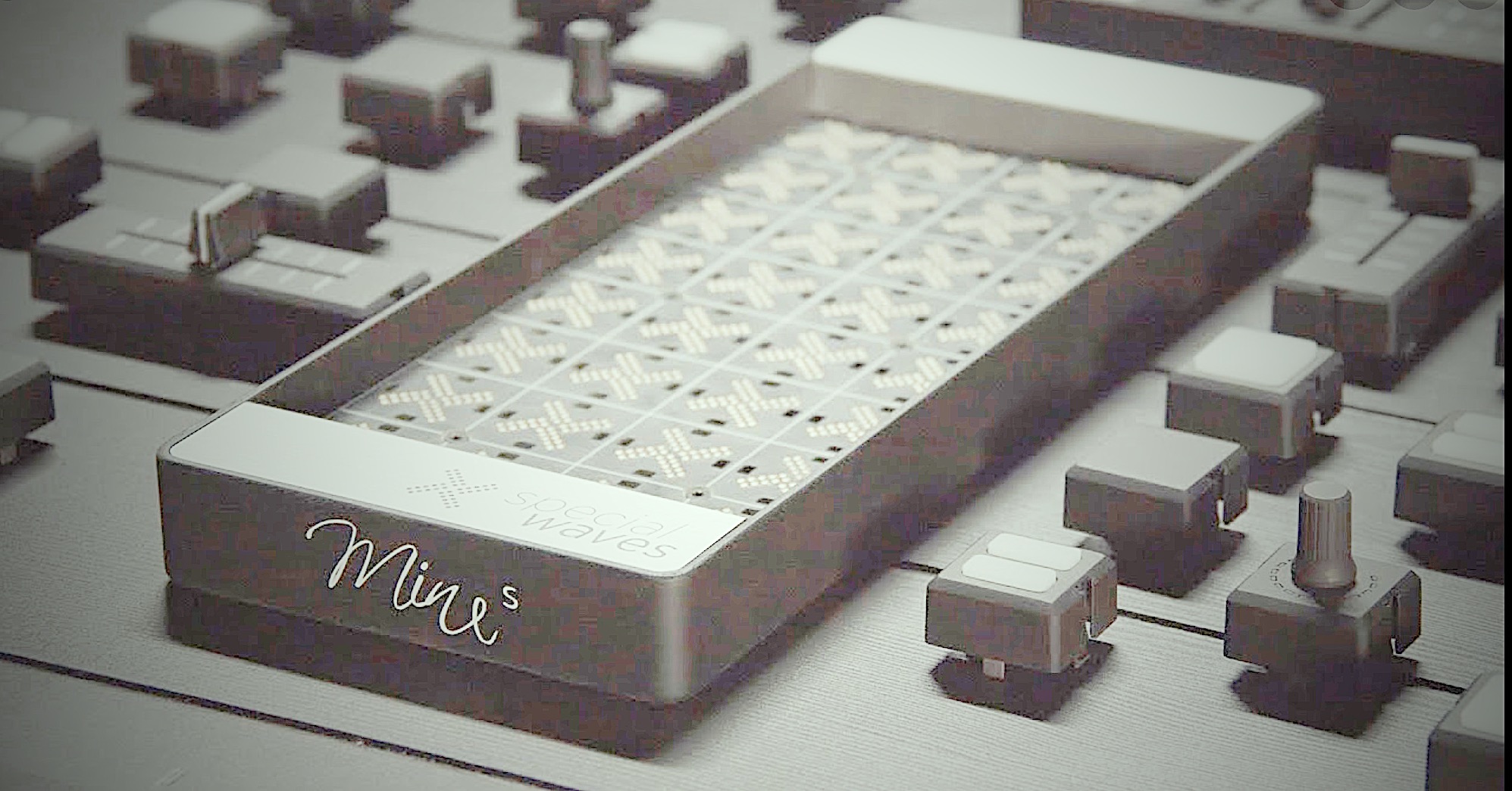

I guess I can always create another zone, and power the extra controller from one of the many Physis K4 USB Ports.
Then MIDI to the Strymon using one of these customized controllers designed for certain tasks.
https://youtu.be/S6O0Io2BVRo
https://www.indiegogo.com/projects/mine-s
May as well get the 32 Module version.
The Double Button Module is great for holding down 2 footswitches on say Tap, and then Reverse.

Some great looping tips there Borg!  esp for people like me who are foot spastic.
JV, that Mine-S looks really cool. Def signals a new wave of next gen controllers.
Pricey though and the first thing that came to my mind is whether customizing a layout is worth the extra $$
as opposed to just buying something like this: https://reverb.com/p/novation-zero-sl-mkii
I'm most likely missing some very important new feature and with your line of work, customization is probably a pretty important aspect.
