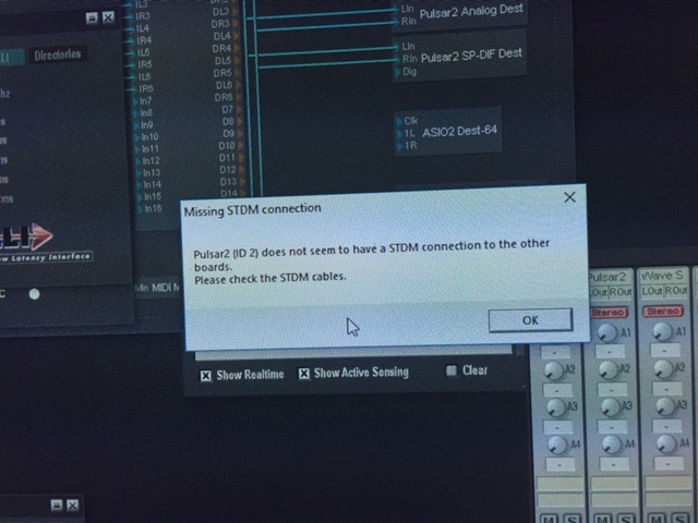

I have tried two sets of cables, cleaned them with isopropen alcohol , it drives me nuts. Installed on a brand new board (thanks again valis) what means ID2??? I have installed 3X pulsar II boards...have other 6 pulsar II cards here...I can change a faulty card (if this is the case) but which one?
Does ID2 mean the middle one? Thank you, haba
						Missing STDM connection

I have changed the board in the middle, now I have the same problem with the ID 1...

The cards are getting verry hot...
