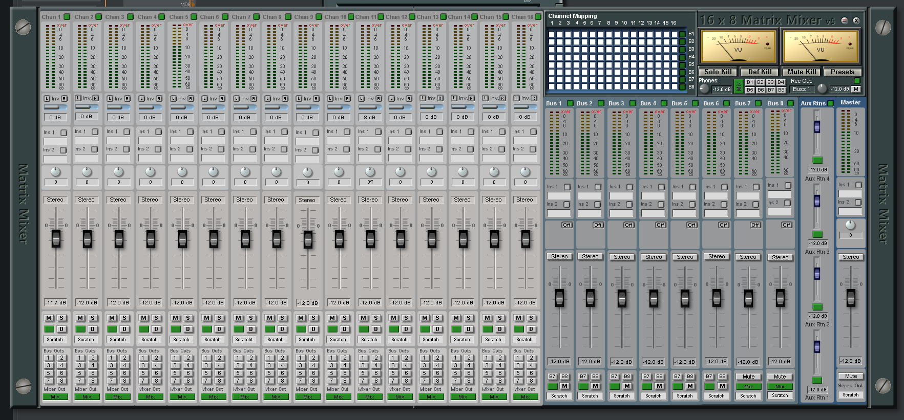

Another Mixer!!
This is a 16 x 8 stereo matrix mixer.
Each of the 16 Channels can be routed to the stereo out as well as one or more of the 8 busses.
Each channel's inputs can be switched to stereo, stereo reverse, mono, left only or right only.
There is a Record out the can record individual channels, busses or the stereo mix. This might be useful for stemming or the like.
The VU meters are associated with the Stereo Mix out. They are more for show, but are reasonably accurate around -3 - 0 db.
Unfortunately version 4 mixer will likely be only useful for XITE users as it is reasonably heavy on DSP and has been set to load on DSP 8,9 and 10.
I hope it is useful to you.

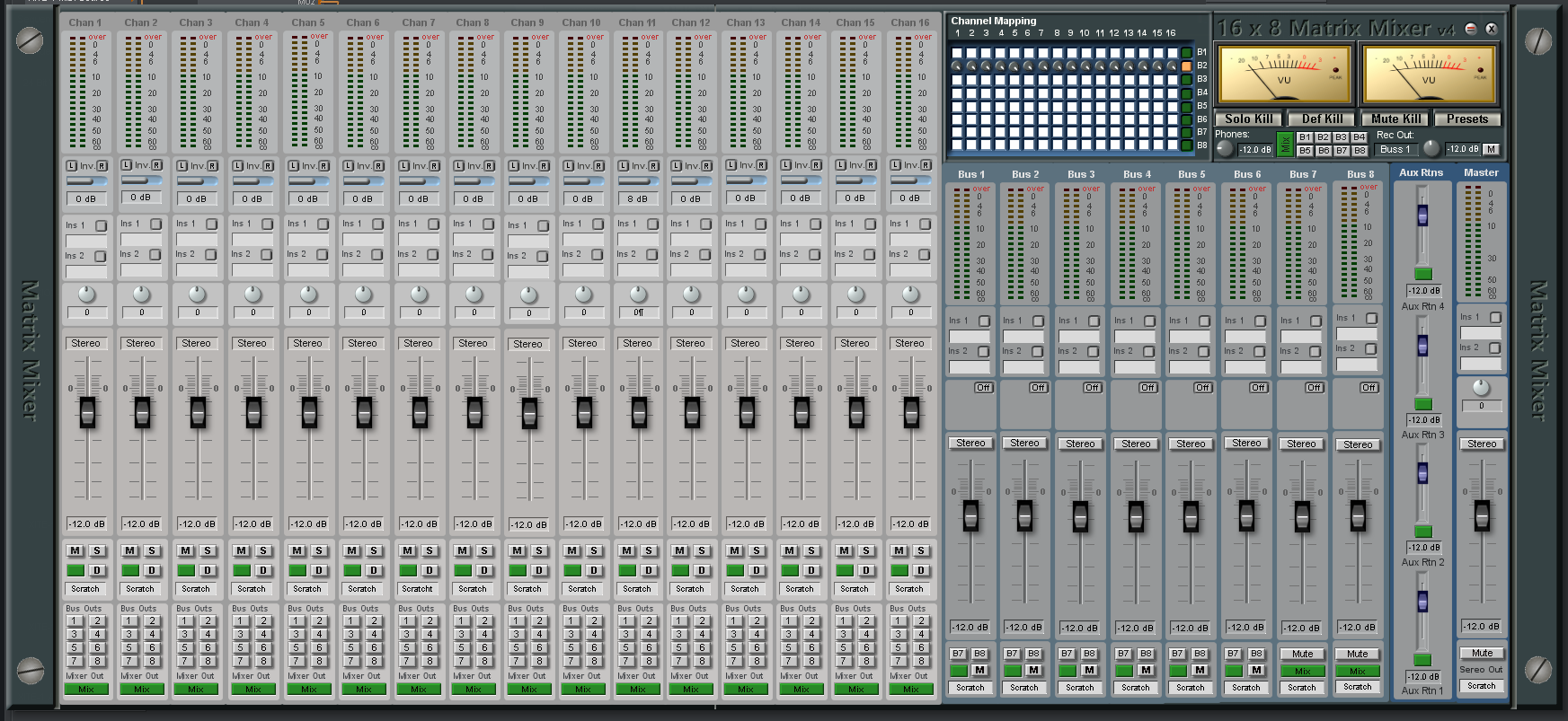

Re: Matrix Mixer
Hi There,
I have updated the MatrixMixer to version 3.
This version now has 4 Aux return channels and Head Phones monitoring features.
By deselecting a buss from the final mix (Green Buttons) and utilising the direct outs, each of the Busses can act as an Auxiliary send.
These are then supported by the 4 Aux Return Channels to get them back into the stereo mix.
Complex routing is possible also by sending one or more channels to buss 1 through 6.
These busses can, in turn, be further sent to Buss 7 and/or 8.
So you could send channels to (say) B2 which has been decoupled from the mix to act as an Aux send and, at the same time, send B2 to B7 for further mixing and mashing before reaching the stereo master via B7 and also via a Aux Rtn Channel.
The Phones out can be switched to the stereo mix or to one of the Buss Channels.
It provides monitoring 'before' any mutes so material and mixes may be previewed prior to going live to monitors, FOH or IEM etc.
I think one of the great features of this mixer is the ease and flexibility in setting and saving complex routing presets.
I have included a couple of 'Test' Presets to demonstrate some of the routing possibilities
- pay attention to the blue and green buttons as well as the matrix at the top of the mixer to see what is going on. I think you will quickly see what is possible.
You might also see that the Record out could be used as an extra send channel, which has the added advantage that you can send an individual input channel to some external effect and bring it back via one of the Aux Rtns.
The new version can be downloaded from the first post here.
I hope it assists you in your work
maus
