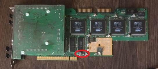

@astroman can you please point out on the picture which one might went off.
Regards
which one.jpg (51.29 KiB) Viewed 3773 times

yes, it's about those caps you marked, but the 2 right above may be considered as well.
(in the old design those were a row of 4 at the very bottom)
You may inspect the solder pads with a magnifier glas for cracks, as none of them has fallen off yet.
There may be leakage at the bottom (which is invisible).
If none of you is tech savvy the best option is to find someone at a repair shop to handle it.
(it's not a big deal and no circuit details are required)
