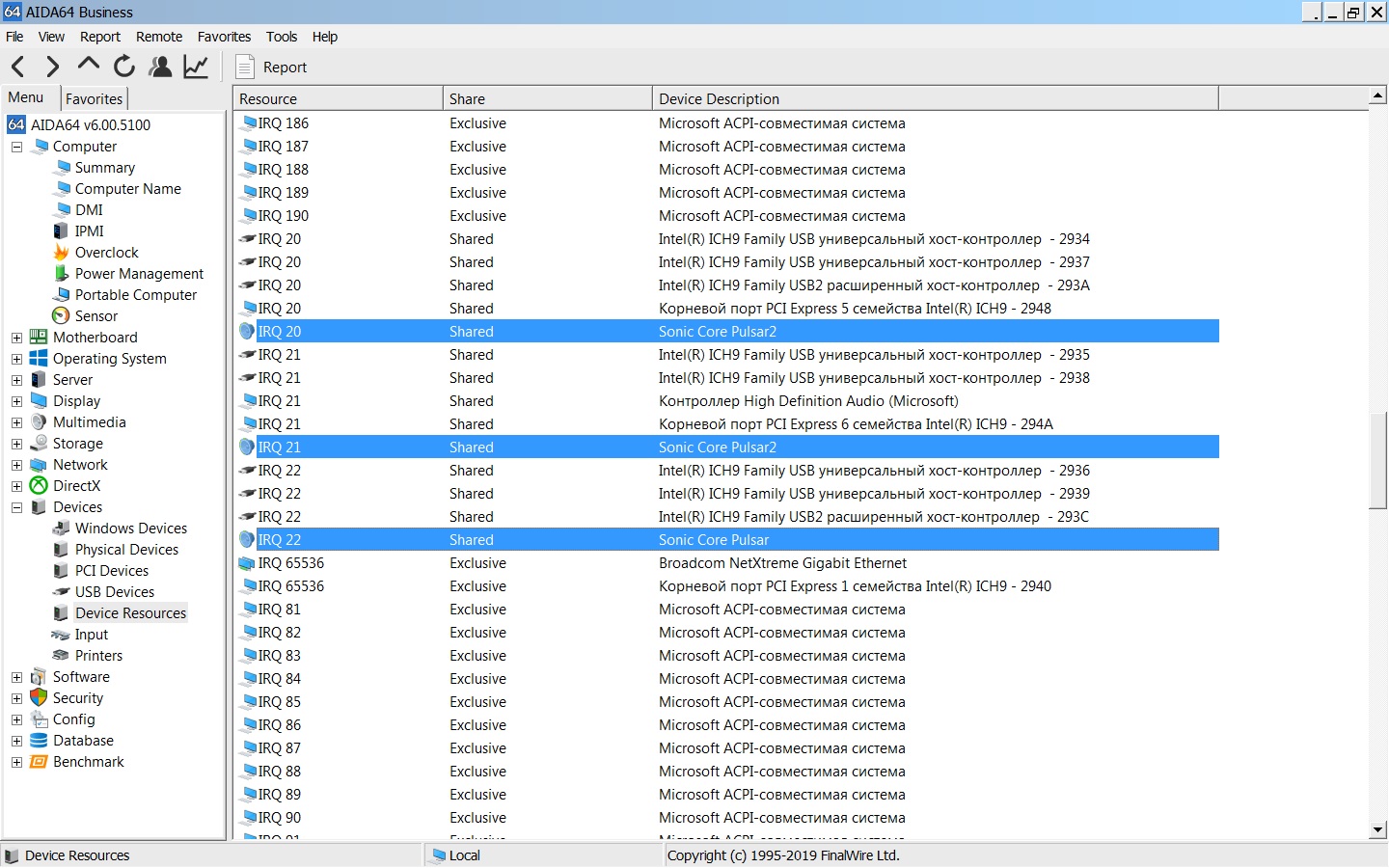

and about irq
Is it normal that cards on Shared IRQ's?
- irq.jpg (391.41 KiB) Viewed 9849 times

Re: HP xw4600 very hot
Looks like you´d have to deactivate lots of (or as many as possible for your work) USB controllers in device manager and for IRQ #20,#21 and #22.
MS HD Audio om IRQ #21 is a canditate too.
I disabled HD Audio (Bios-Security-Device Security)Bud Weiser wrote: Wed Jul 03, 2019 8:55 amLooks like you´d have to deactivate lots of (or as many as possible for your work) USB controllers in device manager and for IRQ #20,#21 and #22.
in bios all USB controllers set to IRQ 10. 11 and 5 ( Advanced - PCi Devices), it means they use these IRQ's or, all the same, 20. 21.22 ?
you cannot manually set irqs in windows.
GaryB is correct, the modern HAL is ACPI and stacks most external i/o devices on 1-2 IRQs, and lets the APIC controller figure everything out below that layer.
On a technical level, those are basically "masking" interrupts, which map to low level interrupts in the (BIOS/EFI) APIC/ACPI layer but the OS calls the masked IRQ and allows the hardware layer (EFI again) to determine when a resource is free. Ie, they are REMAPPED to only a few high level IRQs, and you CANNOT control that side of things. This is really necessary on LATER generations (everything from Nehelem/Intel 2009 era onwards) as more and more of the system is managed directly in the CPU itself. You'll also find that disabling sleep states and so on for everything post Nehelem becomes more complex as well, as that was the year that the Power Control Unit was moved onto the CPU itself. This was a good thing however, for on a modern 8/9th gen Core (i) Intel CPU we have very few issues like we had back then with realtime i/o like low level stremaning-data audio & video performance.
In the *very* old days, hardware makers would simply publish slot/resource sharing diagrams in their manuals, but as more and more complexity has been introduced this is hardware to present in a simple table, so doing this yourself once hardware is installed is necessary. What I did on systems before the modern 'i' series (i3/i5/i7) such as yours, was DISABLE the ACPI controller in the BIOS and then boot into something that has ACPI disabled for an OS, and map out all the hardware sharing at that point. Again, you'll have a harder time finding an old enough OS to do this, but I still keep a few ancient Debian based Live CD's (and USB keys) around, plus the odd XP installer. Once you boot to a non-ACPI environment, it's simple to see what your card is sharing with, and move things around accordingly.
Once I have all that taken care of, I then set the BIOS *back* to ACPI mode, and begin my OS install. For any OS prior to Win10, your HAL (Hardware Abstraction Layer) is mapped out at this point (barring major hardware changes that will cause this to be rebuilt), and if you have isolated what interrupts are masking through to multiple devices as mentioned above, you will find you have much smoother performance. Win10 is flexible enough that you can actually rebuild the HAL at any time, and it will sort everything out. But that's not as relevant here..I simply mention it in passing as it not only makes restoring from a backup image easier, it also means it's much more tolerant to major hardware changes without needing a reinstall than prior Windows OS versions.
Pre-Scope 7 it was rather important to ensure that your PRIMARY Scope card (the first one in the DSP meter) was 100% free of sharing resources with anything, but I've seen GaryB report that this is less of a concern with V7. So I will defer to him on that point, but personally I still set my primary card in my cset.ini file once everything else is sorted out.
maybe in this way?
Pulsar2 (Primary) - IRQ 20
Pulsar2 - IRQ 21
Pulsar1 - IRQ 22
I have two USB devices that are constantly on - mouse and midi keyboard.
I can connect them to USB ports, that use IRQ 22, and 21, 20 will free.
other usb devices will connect as needed
