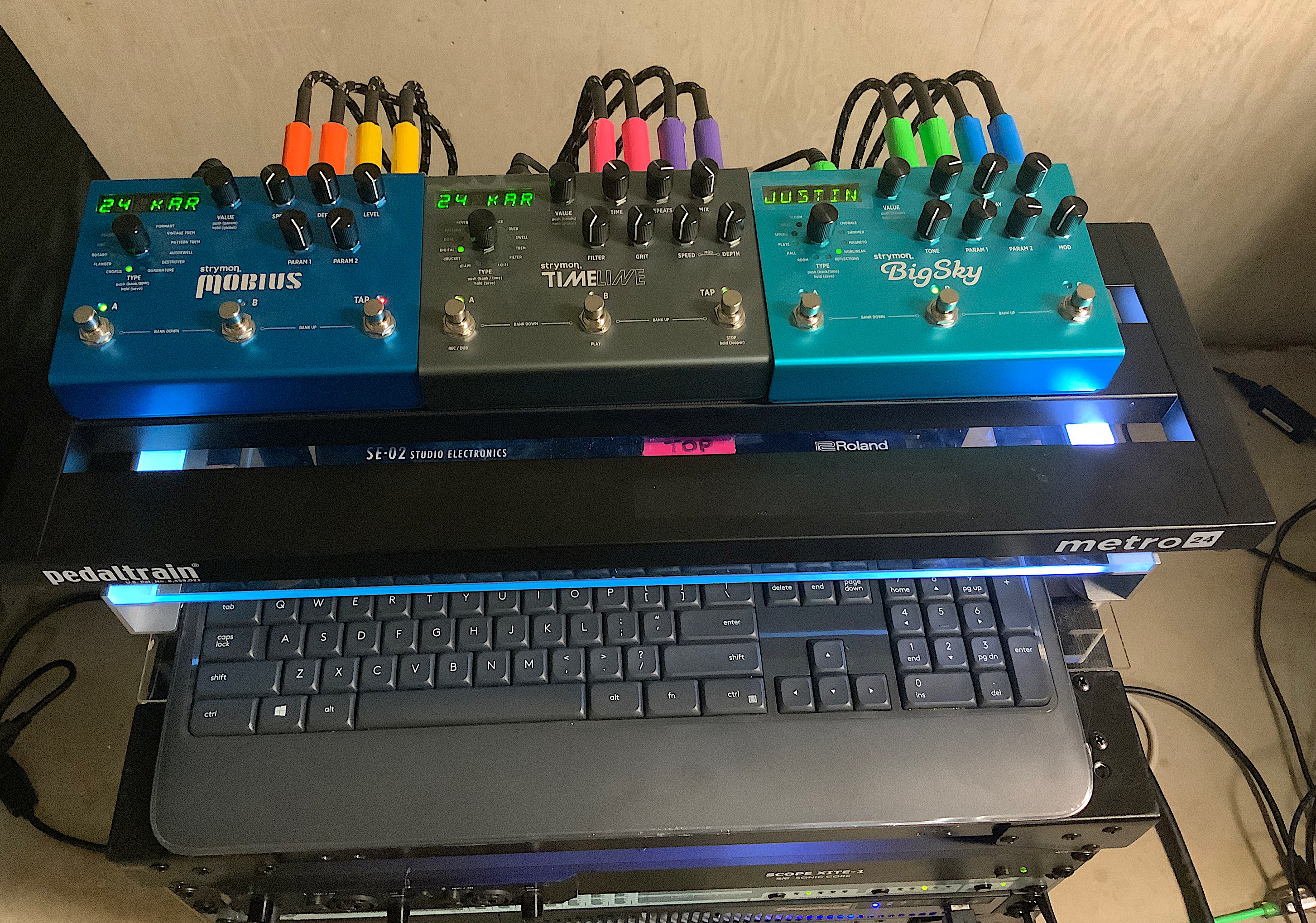

Here’s a pic of the racks, no shots of any sizes other than the 8U, but you get the gist of things.

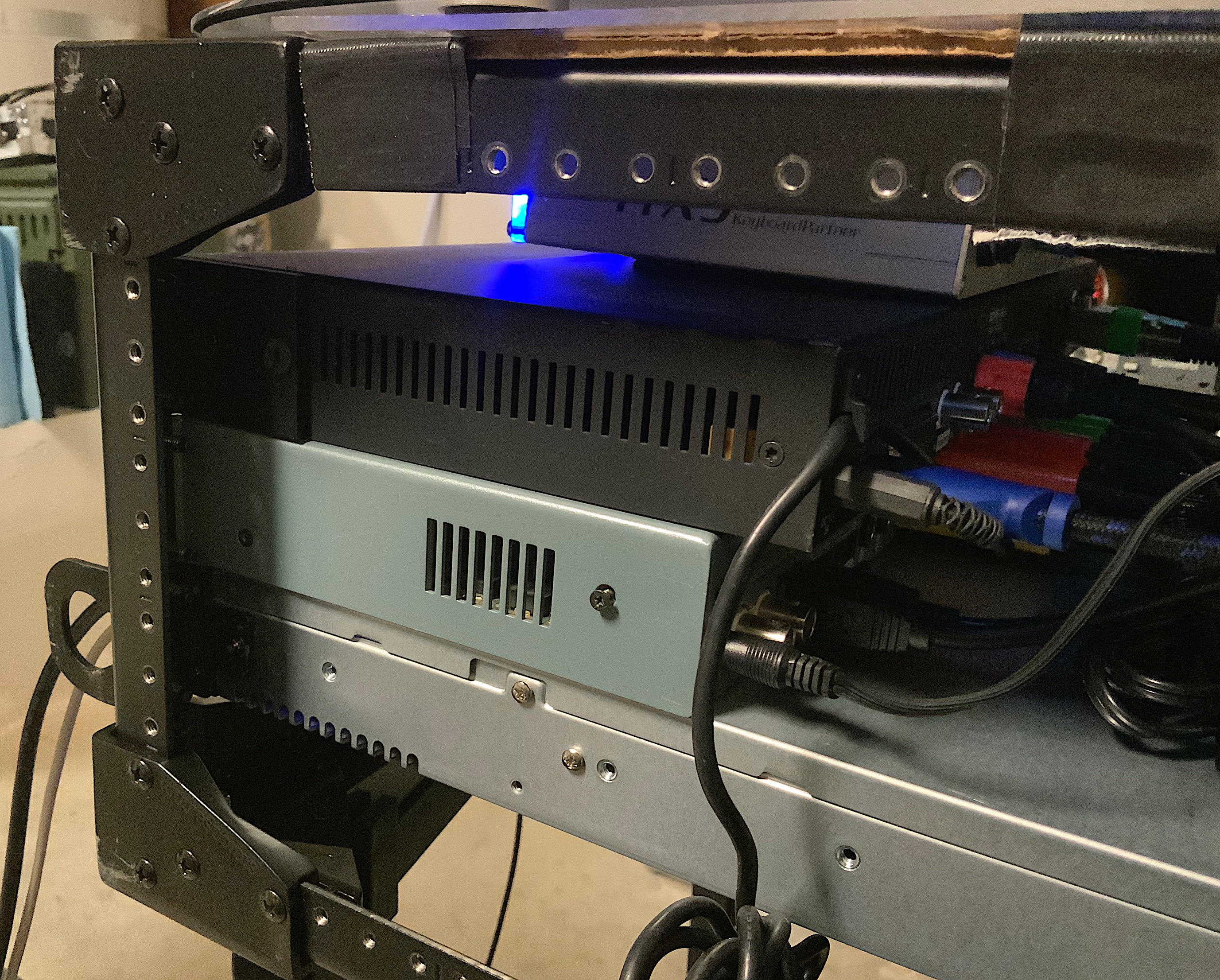

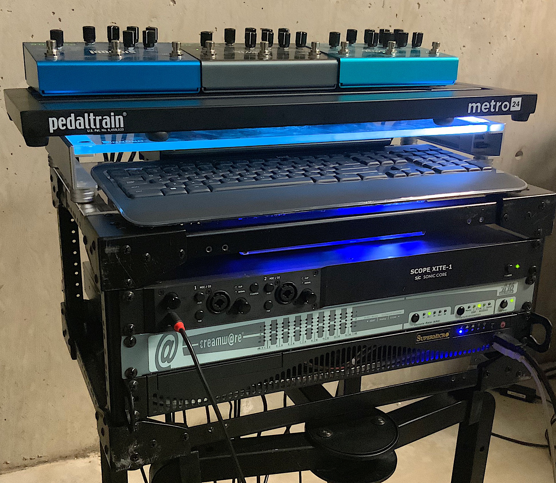

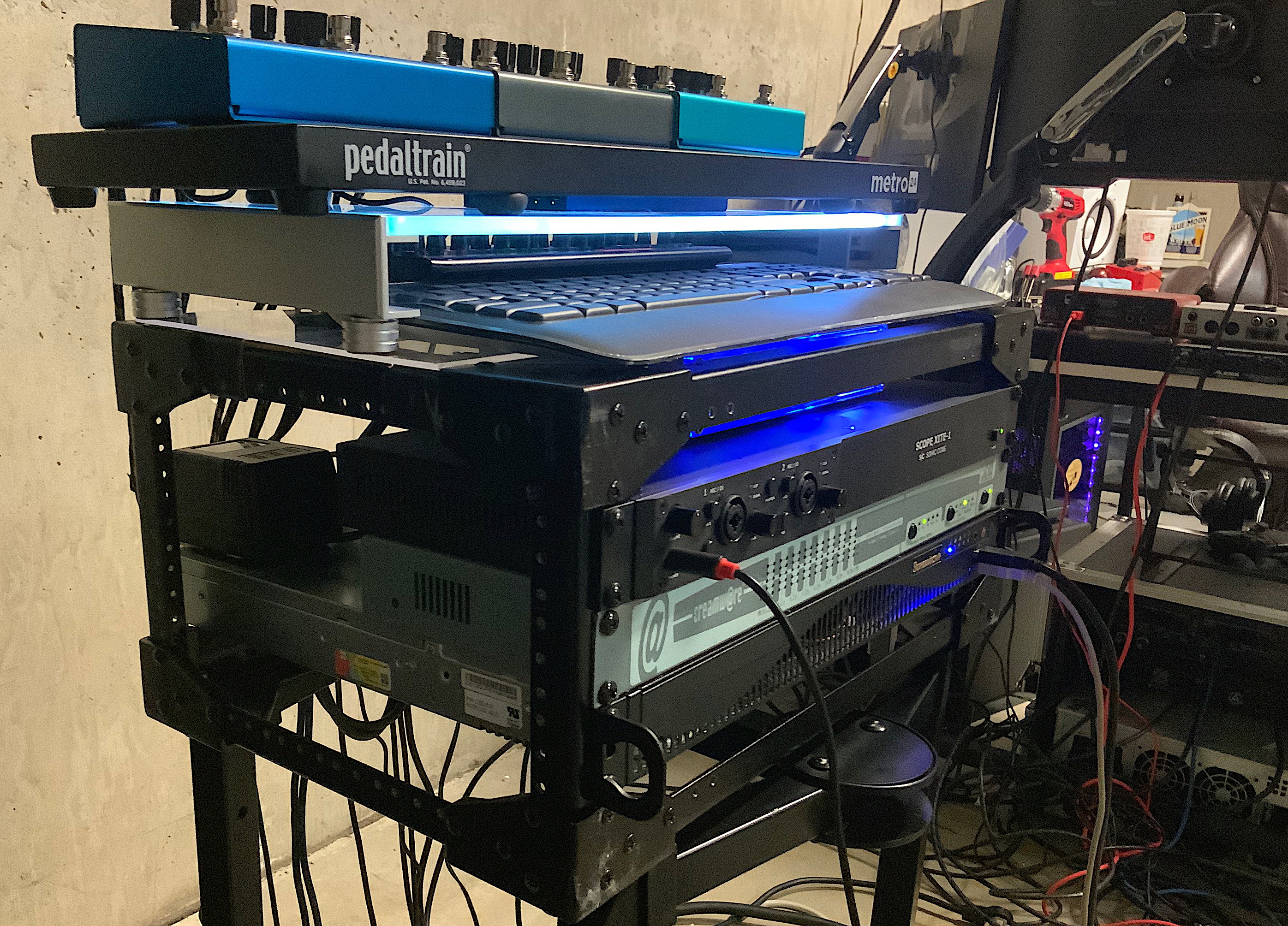

Re: HEAT - How much of a problem is it for the XITE?
Posted: Mon Jun 17, 2019 5:12 am

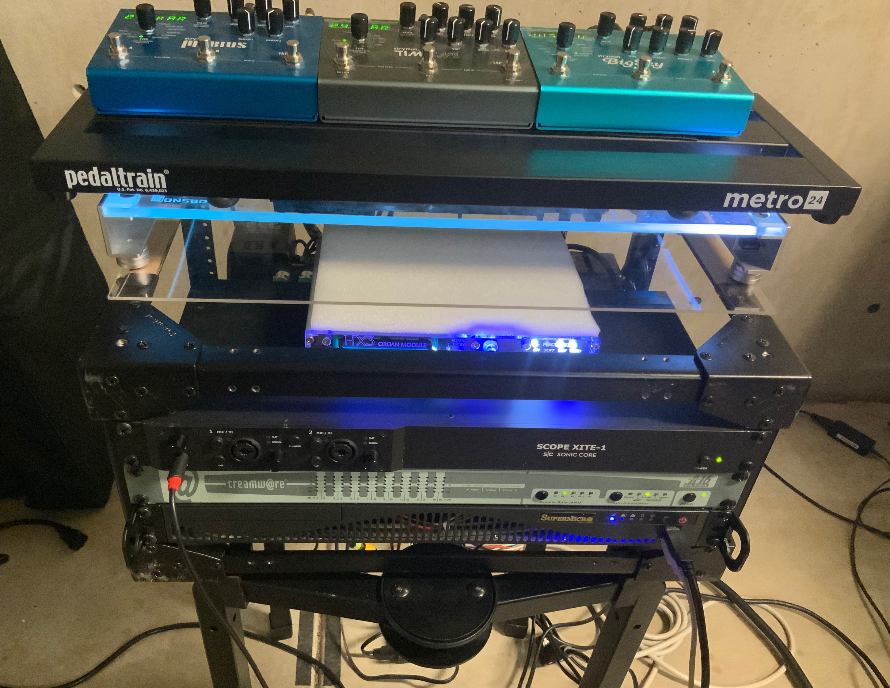

Here’s some views of the summertime rig.
These frames can also be shoved into shockmounted rack ATA 2” foam cases for flight.
Taken back out for local gigs.
This is the 13” deep 3U Model.

My rack is one of those closed kinds, that doubles up as a transport case, I guess it doesn't allow for enough ventilation.
Now I have the XITE on a laptop stand, with nothing near it. The fact that it's tilted forward also reminds me of not putting anything on top :)
But yours is over a PC and the A16U and no fans... I don't think I could pull that off with my unit

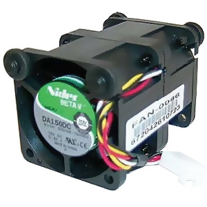

The side vents on S|C gear might benefit to have air blown across the main board and chips using one of these.
If heat is the problem one of these will fix that.
I’ve got these on my PCs and they’re so strong I can leave a piece of paper on the intake section of a 1U and it stays put instead of dropping.
