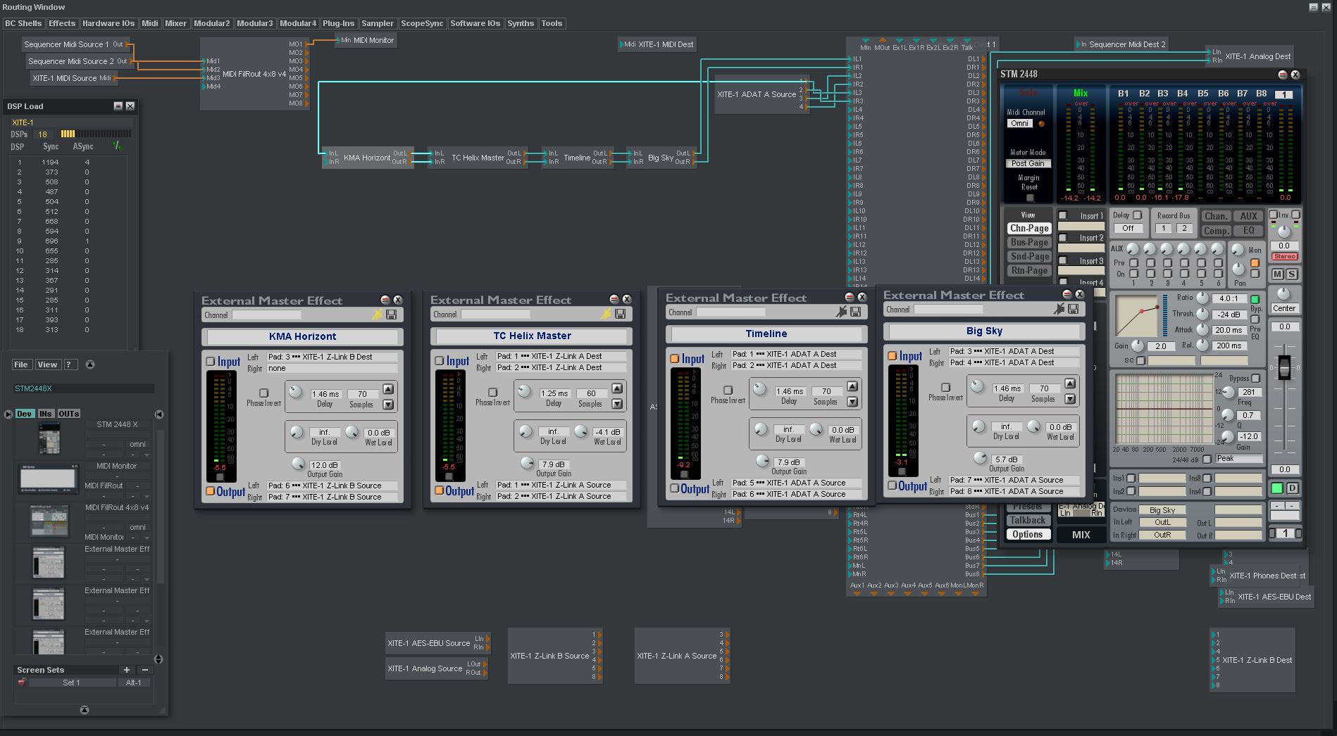

So to continue with my external pedals/patchbay project.
Soundbyte using Scope external effects modules out A16 to patchbay and back into Scop
https://soundcloud.com/yayajohn/4pedals (some popping/crackling i'm going to have to track down
Signal chain:
Rev2 - mixer -ADA ADAT - Scope -
External effects module - A16 Zlink - patchbay - KMA Horizont - patchbay - A16zlink - Scope external effects module-
connected subsequently to 3 other external effects modules (TC Helix, Timeline, Big Sky)
- Externaleffects.JPG (277.5 KiB) Viewed 3107 times

Re: 4pedals
Posted: Mon May 20, 2019 4:40 am
by Marco
How did you create the external Master effect device?
Re: 4pedals
Posted: Mon May 20, 2019 5:20 am
by t_tangent
Marco wrote: Mon May 20, 2019 4:40 am
Marco, they are in the tools section. There are a few different types which you can then label and save, then each time you reload that device all the I/O connections are already set. But remember to also load the hardware I/O modules in the routing window, or save those I/O in the default project. For example if you have an an outboard reverb connected via analog source and destination, load those hardware modules then load the master effects device from Tools, add the analog source and analog dest in the bottom drop down in Master Effect device surface window, label it as "Name of your external reverb" and save device as same name. Next time you want to use in a project, first load analog source and a analog dest into routing window, then load Reverb device. You will also notice that the I/O modules themselves will then no longer show the connectors. That's it.
It is useful sometimes, when you have a lot of outboard and can't always remember what is connected to what, although I also have a text file with all my physical outboard connections.
Re: 4pedals
Posted: Mon May 20, 2019 6:25 am
by yayajohn
t_tangent wrote: Mon May 20, 2019 5:20 am
Yes they are very useful. So to elaborate a little further:
What I do is load all of the I/O modules in my default project and move them out of the way. When you load one of your External Effects Modules you will see the connection disappear from your I/O module.
Why to use them?
-saves time
-no need to remember your I/O once you create each module
-signal level boost or reduce and wet-dry adjustments. Also, VU level info(on Master External Effect module only)
-you can use the modules in insert slots. (use carefully though)
-a bypass button
