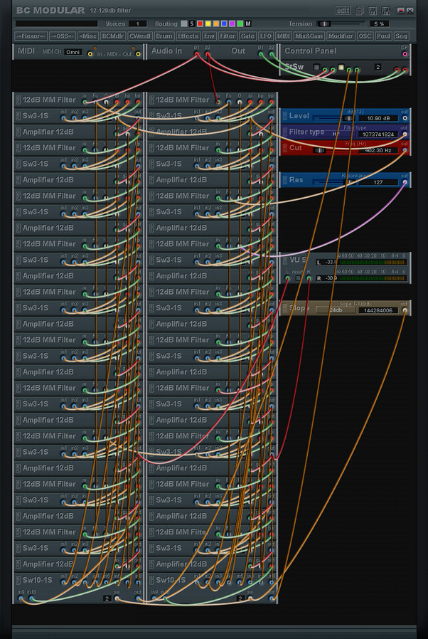

  Some simple low & high pass filters with curve up to 96db would be very welcome !
I thing by puting 8 low & high pass filters of 12db in serial, I would obtain a 96 db one but all them in one device would be much more convenient !
I could do it in SDK ....
  But I don't know how to transform that in a Scope device ....

				there is our quickcut device its basically this no? well without modulations anyways.

				Damn ! One again I missed ! Thanks, Faxi ! The slope is up to how many ?

				ha i dont remember, i think yah 96

				Finally, I made a modular one, up to 120db !
 Stereo.
I had to add 12db on each filter output to keep the audio signal at the same level. (Modular filters output are -12db)
- 12-120db.jpg (231.41 KiB) Viewed 23513 times
http://forums.scopeusers.com/viewtopic.php?f=15&t=35839
You can choose the slope from 12db to 120db !
