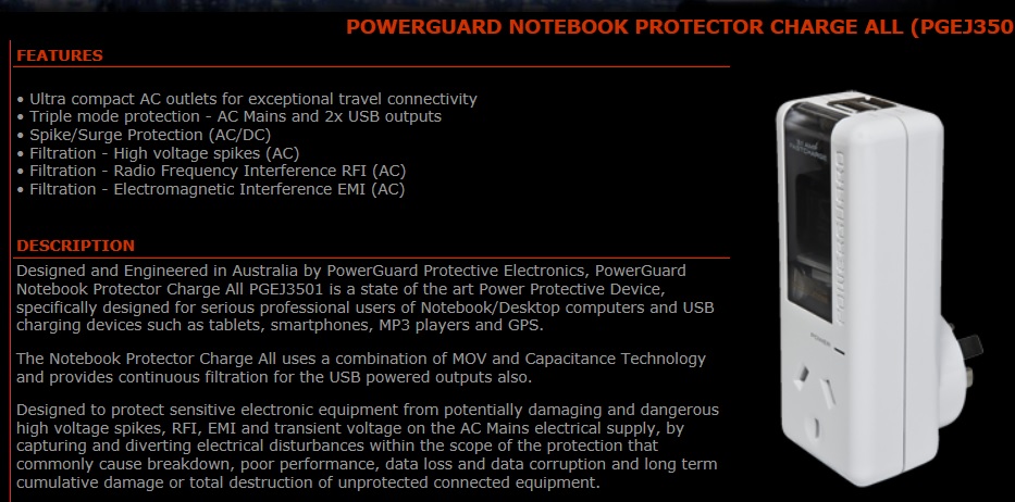

A couple of months ago my PowerWare UPS (http://www.hitfoundry.com/issue_08/ups_mast.htm) crapped out so I took it out of the circuit. After that I noticed a lot of crackles coming in from the mic, so I got this powerguard surge protector which I put on the mains outlet. It has reduced the crackles and pops but not eliminated them all. Anyone got a better idea / filter device ?
Powerguard
Powerguard

Indeed, your powerguard notebook protector charge all doesn't seem to have a transformer inside that will electrically isolate completly the output of the filter from its input, so no ground loop can appear.

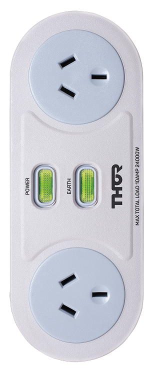

@gary - no idea about the building grounding. However, this little THOR baby did the trick for $109 - mic signal clean as a crystal in space.
thor
thor
