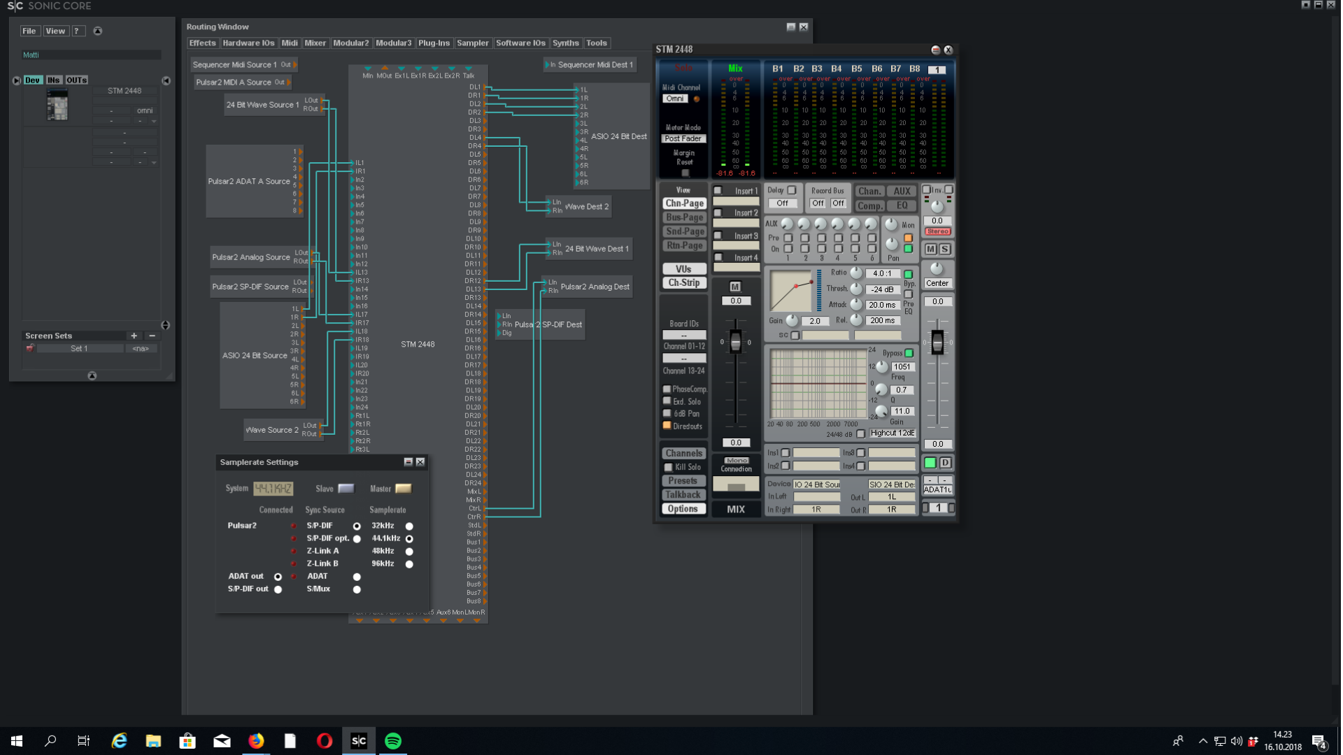

Re: Voice problem
Posted: Tue Oct 16, 2018 3:30 am
by Matti
SCOPE Platform-Matti.png (422.19 KiB) Viewed 6380 times
Re: Voice problem
Posted: Tue Oct 16, 2018 3:32 am
by Matti
Here above is my SCOPE Platform if this help?
-Matti
Re: Voice problem
Posted: Tue Oct 16, 2018 4:53 am
by Ripper
Did you do what i told you about Windows update and services?
Ps: DL outputs are Direct outputs from the inputs with the same numbers, so, DL 4 will not output any sound and DL12/13 will only output the signal from one side of In13. But that is another issue not related with the OP.
