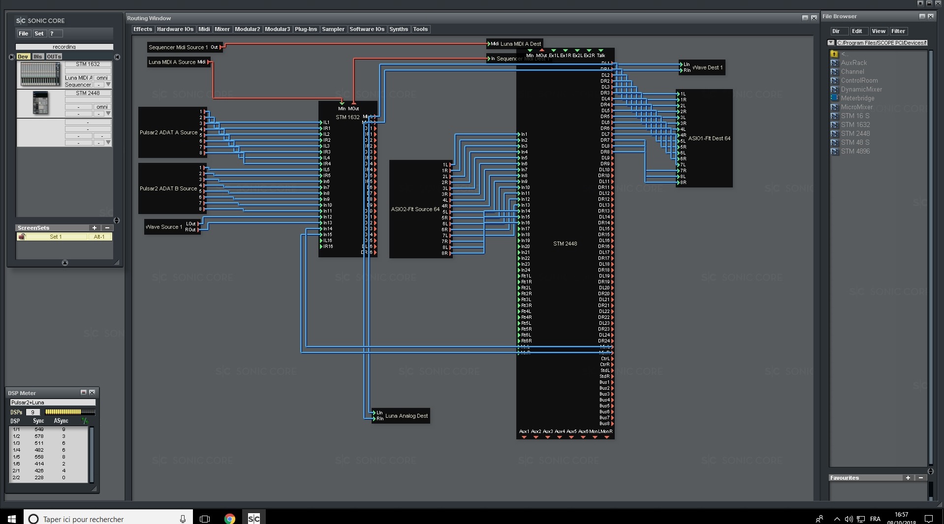

No signal in scope and daw
Hello.
Having recently a Creamware A16 ultra that I connected to my Pulsar 2 coupled to a Luna.
So I have 16 inputs connected to my Presonus studio live console 16.4.2 Ai, the 16 outputs are connected to the A16 ultra which is connected to it in Spdif on the Pulsar 2.
Each input sends the signal well on the A16 ultra so far everything is fine.
But on the sound card interface and in my DAW (retype) the signal does not pass, it seems to me that I did not make any mistakes when connecting the interface
Thanks

Re: No signal in scope and daw
I don't see any external signal being sent to the Asio Flt Dest 64, but an Asio Flt Source 64 is.
By your project, the signal from the ADAT A and B sources should be the ones going to the Asio Flt Dest 64.
Or maybe I understood wrongly what you are trying to accomplish.
I just want my 16 Adat inputs to be active in my Daw.
I understand from what you say that I should connect the adat a and b source to the STM 2448 so that they are directly connected to the asio dest.
Not to the STM2448 but to the STM1632 Mixer!
As you have it now, the signal from both ADAT A and B stops at the STM1632 Mixer and only go to Wave Dest 1 as Mix out.

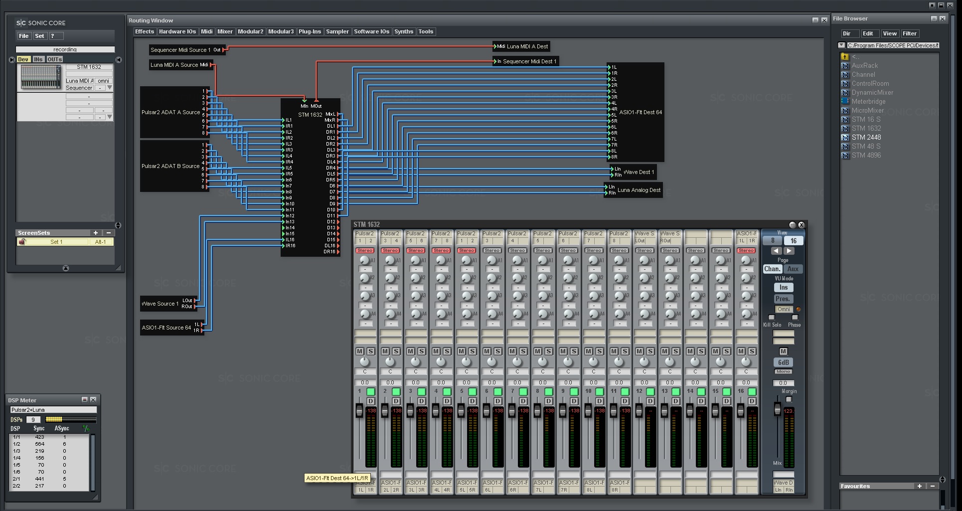

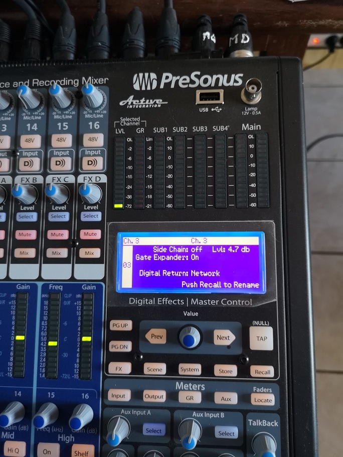

So I just modified my scope project, but the result remains the same.
As in the pictures, the signal arrives well at the console and it sends back well to the A16 ultra

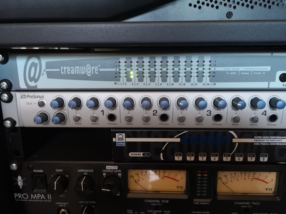

The a16 ultra
- IMG_20181009_122203_resized_20181009_122325472.jpg (135.23 KiB) Viewed 6255 times
the console
- IMG_20181009_122151_resized_20181009_122356737.jpg (192.08 KiB) Viewed 6254 times
