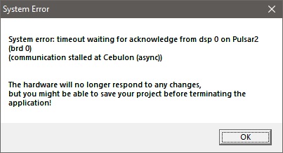

Periodically, my soundcard stops working with the error message:
Code: Select all
System error
timeout waiting for acknowledge from dsp 0 on Pulser2 (brd 0)
(communication stalled at Cebulon (async))
The hardware will no longer respond to any changes, but you might be able to save your project before terminating the application!
[OK]
Do you have any idea what might be causing this and how to stop it?
The system is two PulsarII cards connected via S/TDM.
Scope v7.0.1705
Windows 10 64Bit

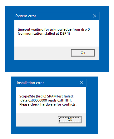

Got this error on XITE-1.

I‘ve had this error numerous times on a Pulsar, and it had nothing to do with the SRam.
If the error persists, check the cap located between wordclock and midi, it may have come off.
(it might be faulty, but that‘s not very likely, considering it‘s relatively short time of usage)
Of course that‘s just a hint for a quick check. If you feel uncomfortable with opening the unit, contact support.
In my case replacing the caps (4 in a row on a Pulsar) solved the problem.
(the io system with the 2 SRams seems identical for many Sharc designs)
