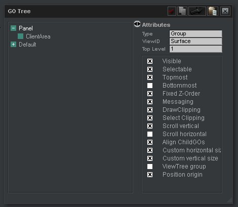

Thanks, quite useful. On SDK 5/7 the controls/menus look slightly different. And there are not 'Dummy Pads' anymore. Instead use 'Audio or Control Pad'. One question regarding GUI: how did you move the controls on the panel? I'm not able to do this with the mouse, I have to use the 'Dimesion' tool. Yes, I'm in surface mode. Maybe there is a trick to do that.

As you can see in the reader on dummypads i use the audio and/or control pad to make dummy pads.
For moving stuff on the panel...goto surface mode and with the cursor in move or edit mode i can move gui parts around

RA wrote: Mon Jun 04, 2018 8:33 pm As you can see in the reader on dummypads i use the audio and/or control pad to make dummy pads.
That's what I thought, but nothing's moving.

There is another hidden option when you right click the panel module...think it is hidden there...or the surface interface module connected to panel...disable move...maybe that flag or another is causing this.
Or what you can do...open a basic empty effect or something....and copy all your stuff into that panel...does it work then? Gui editing is one of the harder things todo in sdk.

Post by DragonSF »
Right clicking and changing the flags: no avail. Creating an emty effect: all the controls are outside the panel, they move with the panel, but can't be moved inside.

Post by RA »
Try to unset the custom vert and horiz size....so the viewtree group to auto. Do this in the GO editor. Probably there is a clip select flag set to the panel or group and the size is incorrectly set. Together with the clip select this can be the problem. Clip select means you cannot select outside the group.
