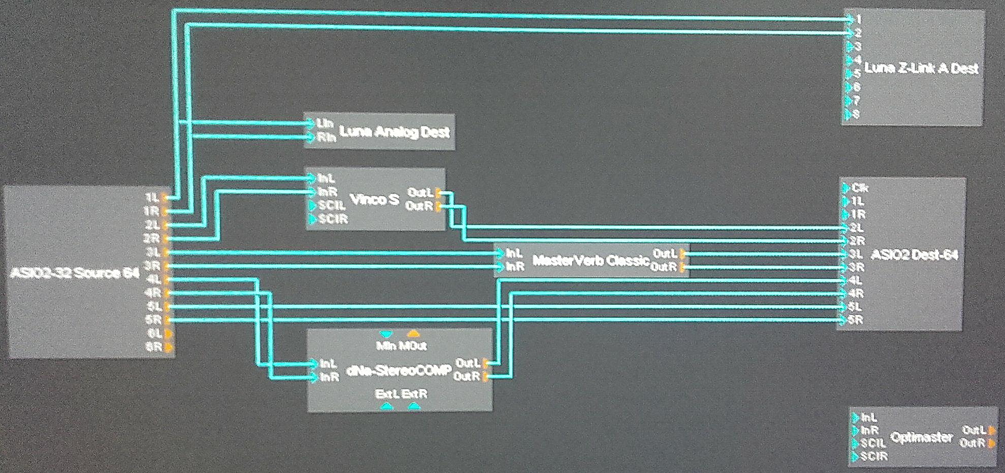

Hello! I am using reainstert vst on the master track in Reaper, I have sound.. signal.. vu meters of the master track show signal, I can hear the Scope VST through which I am sending and returning, all works fine, except that when I try rendering with the reainstert vst on the master track of reaper, it is 0 signal.. even though I hear everything ok.
Picture attached.. I have the reainstert vst sends and returns on channels 7 and 8 for the dna stereo comp.

Scope plugins are not processed by the PC. if you render offline, how can the computer know what is happening on the card?
to make this work, you would need to do a real time render, or better yet, just record the mix into a new stereo track.

1st ... you might have a routing problem in Reaper, but we cannot see here when you show just only the SCOPE environment screenshot.
In addition, your description is irritating.
A "VST" is a DLL-file.
SCOPE VSTs are only in use when you use XTC mode, otherweise they are SCOPE devices.
Both the usage of SCOPE standalone and XTC mode require different routings/projects.
I´ve read your posts above, but for me, it´s not clear what you´re really doing or trying to achieve.
You should tell the forumites more,- which Reaper version you´re using and which SCOPE (v5.1 or v7) ...

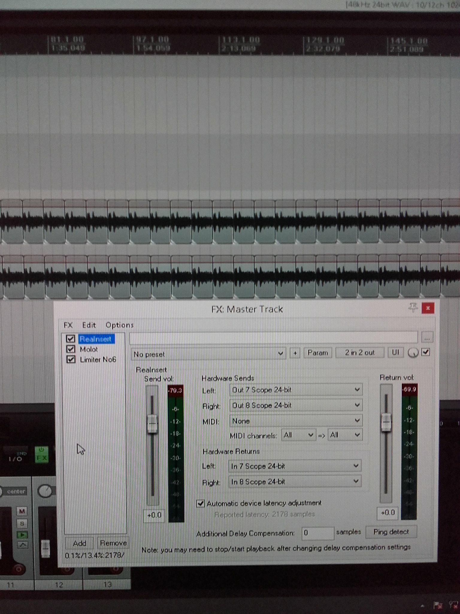

I am using Scope V7 for the old PCI cards (Pulsar, Luna..) and Reaper 5.33. What I was trying to record was indeed the master track that would have been the mix of all the tracks after they get routed through the Scope plugins.
I was sending the Master track of Reaper through channels 7 and 8 to the dNa StereoComp and getting things back through that again since on top of it I had also some other VSTs in Reaper. It sounds good, but I am not doing things right. I attached a picture of the master fx here.. I did this with all the tracks that use the routing through Scope plugins using their associated asio in and outs. Still trying things here. Thank you!
Bud, sorry for irritating with my way of expressing the things, for me, the Scope devices act like the plugins and that is why I described things like that.
- master.jpg (378.43 KiB) Viewed 5771 times
