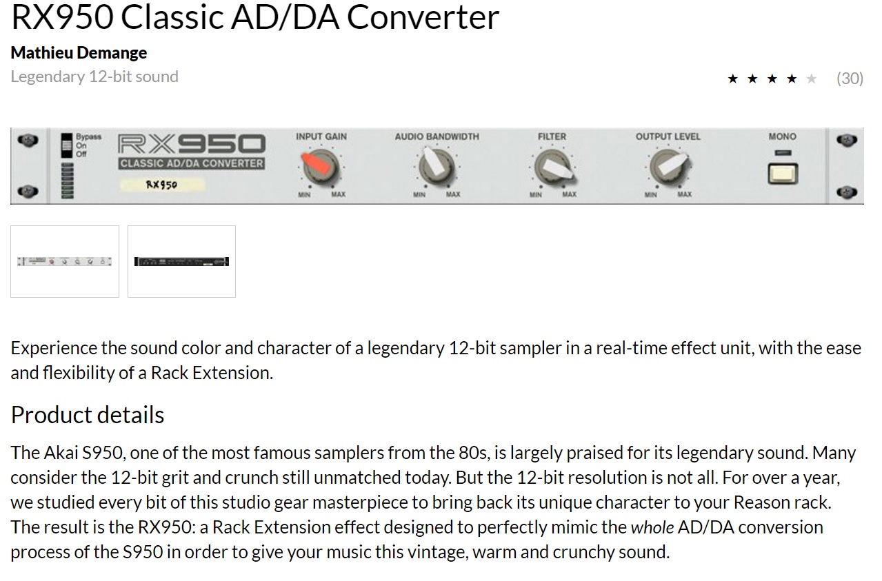

So much so that is a desired sound. Just got this recently so can apply it to modern samples :)
