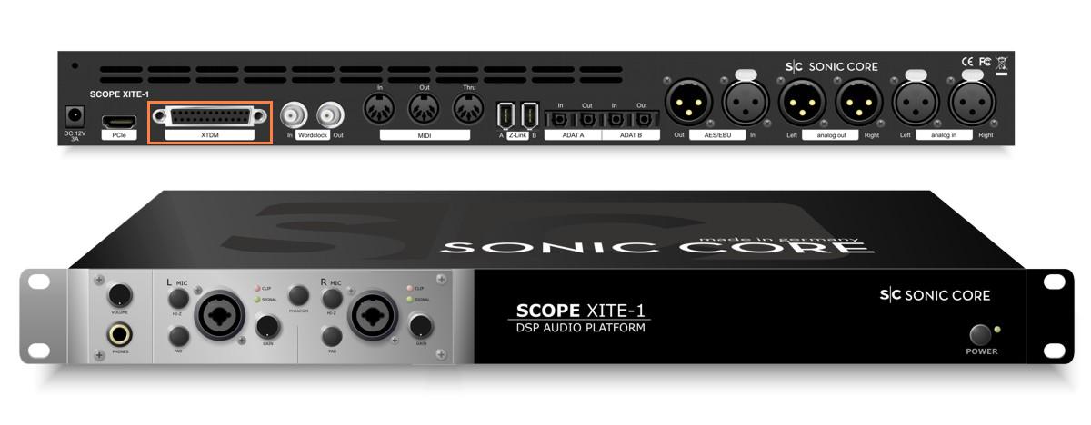

Re: SHARC DSP revision number

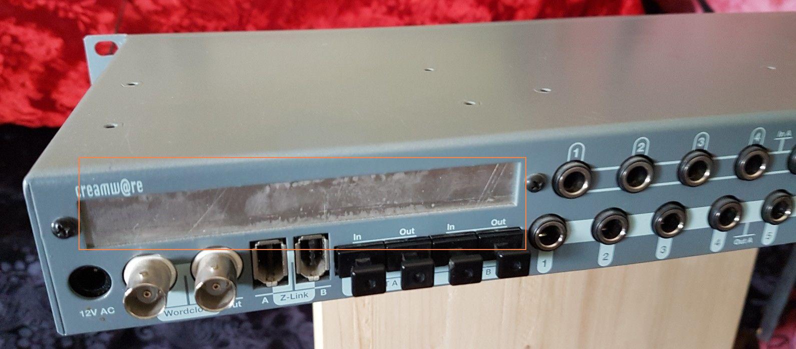

completion expansion / cascading would be my biggest wish
				- a16ultra-b5_exp.jpg (129.47 KiB) Viewed 5494 times
				- scope xite-1_exp.jpg (53.46 KiB) Viewed 5494 times
