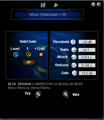

https://spacef-devices.com/DOWNLOADS/Mo ... ressor.zip
I did it after reading the thread, as I thought it might be helpful?
It is a plain compressor with sidechain that can be from ModMixer modulation inputs.
Also has different stereo modes with sidechain stereo or mono.
The "Mono" Mode outputs on L/R channels, so it is mono to stereo but doesn't do any stereo special effect.
not a beauty contest

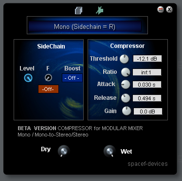

				here is slightly better one
- Added sidechain gain booster +12/18/24 dB (probably necessary when a filter is used on the sidechain, 12dB did not seem enough to me).
- output gain was at +10dB which was too loud. now 0dB.
https://spacef-devices.com/DOWNLOADS/Mo ... orBETA.zip
Enjoy !
It works well with scope modulators too (lfo, sequencers etc).
