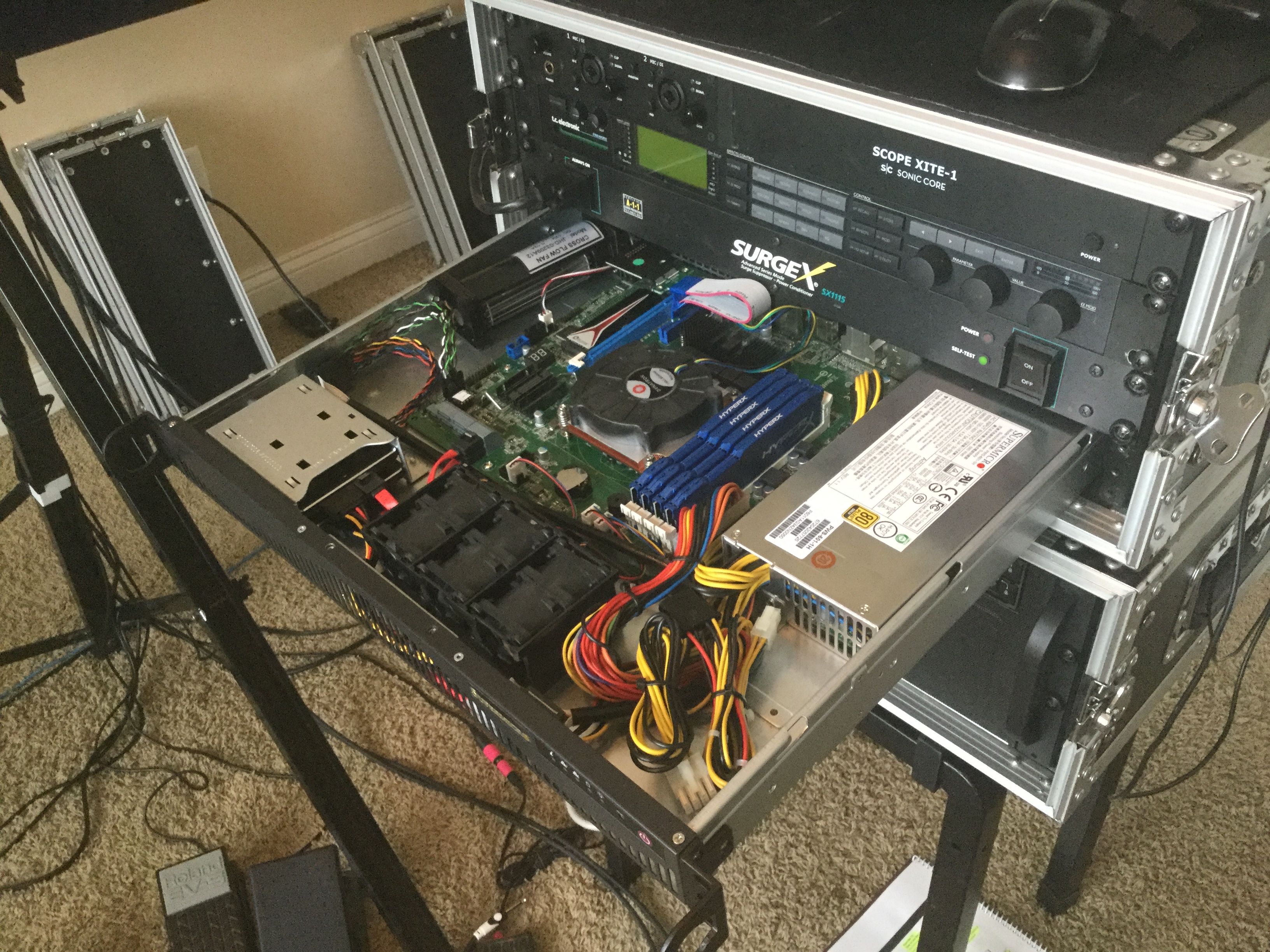

Re: Is it worth to use a pcie Adapter to connect a M2 ssd?
Actually sample loading and OS+Apps will see noticeable increases.
Streaming will scream until the controller becomes hot and throttles down to regular SSD transaction times.
I put Omnisphere on my M.2 NVMe devices because samples are loaded via program change messages, just like an old hardware sampler does. My progress bar flashes instead of slowly loading.
OS loads extremely fast now too.
Even though they throttle down to PCI-e 2x speeds that’s fast.
These devices we see in the consumer markets weren’t invented with streaming in mind.
But AMDs new Infinity Fabric design is so fresh for x86 computing code can be written to take more advantage of applications that benefit from streaming.

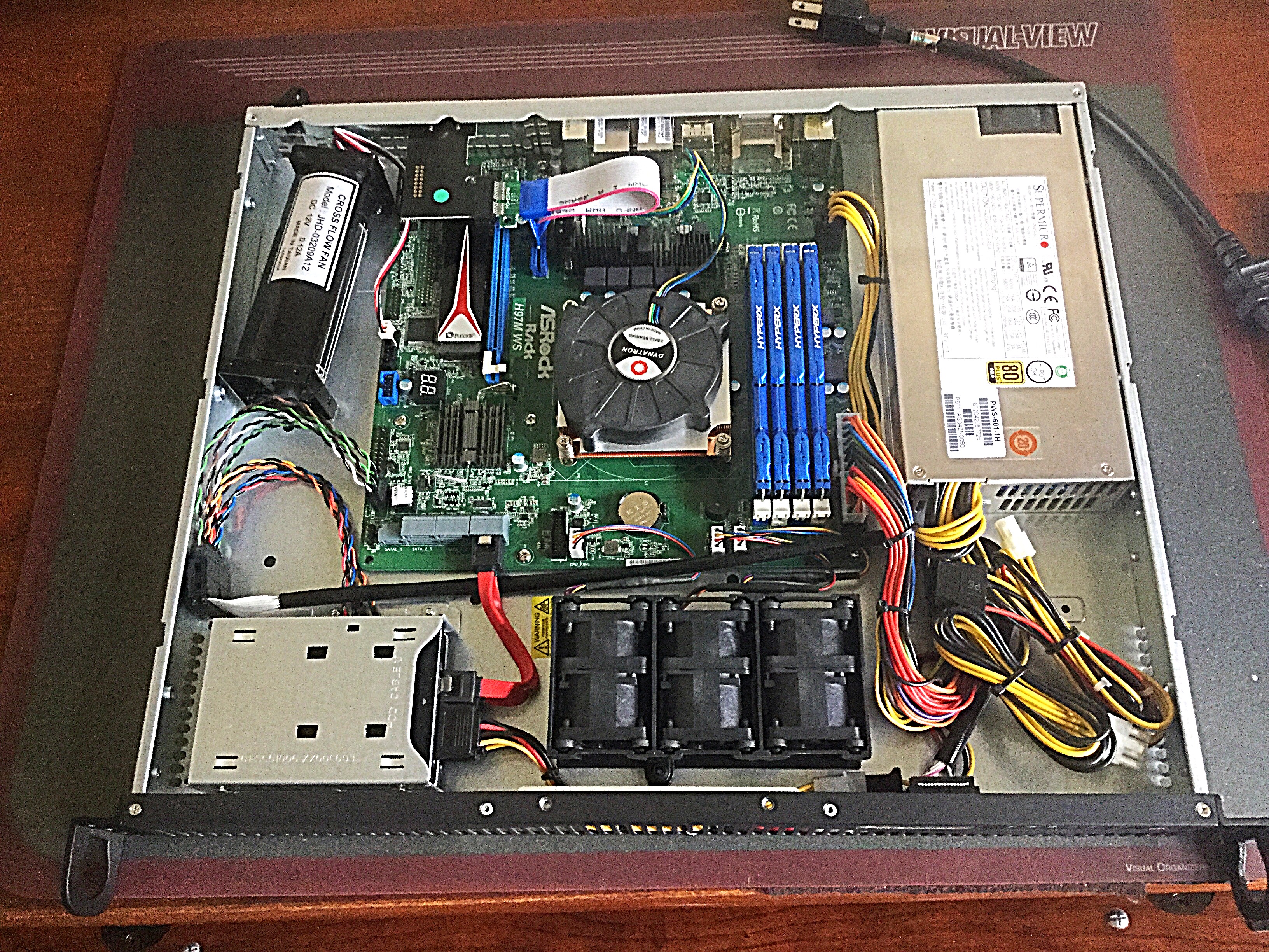

I use a cross blower Dynatron Fan to cool my NMVe (upper left) but this is more for show as hardware monitoring app seems to report 3-4 degree differences. I thought I’d give it a try though. Looks all scientific & shit too.....

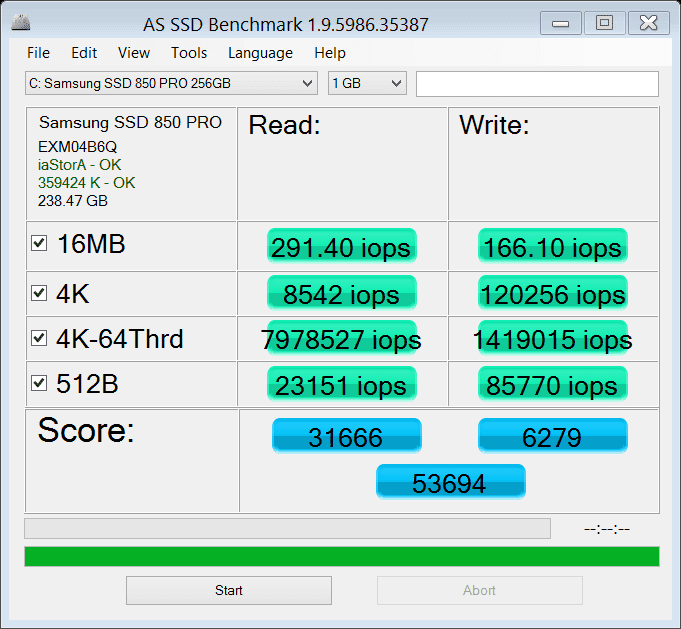

The card style NVMe devices from Intel and others have adequate cooling but I had some Intel 400Gs and while you don’t really notice the dissipation of bandwidth in our apps, AS-SSD and other benchmarks show the results after 15-20 minutes.
Best performance I’ve seen are the Samsung Pro 850 SSDs.
10 year warranty, in house controllers made, even have better drivers and caching software. The Magician software benchmarks but also caches RAM which seems to benefit audio apps.
Here’s an unrealistic benchmark basically off the charts because Z/H 97 chipsets take data directly to the CPU instead of the PCH.
These are very fast SSDs so if you get EVOs, they are also fast but lack the Samsung Pro 10 year warranty.
I wish my devices ran as quick as the Benchmarks say.
