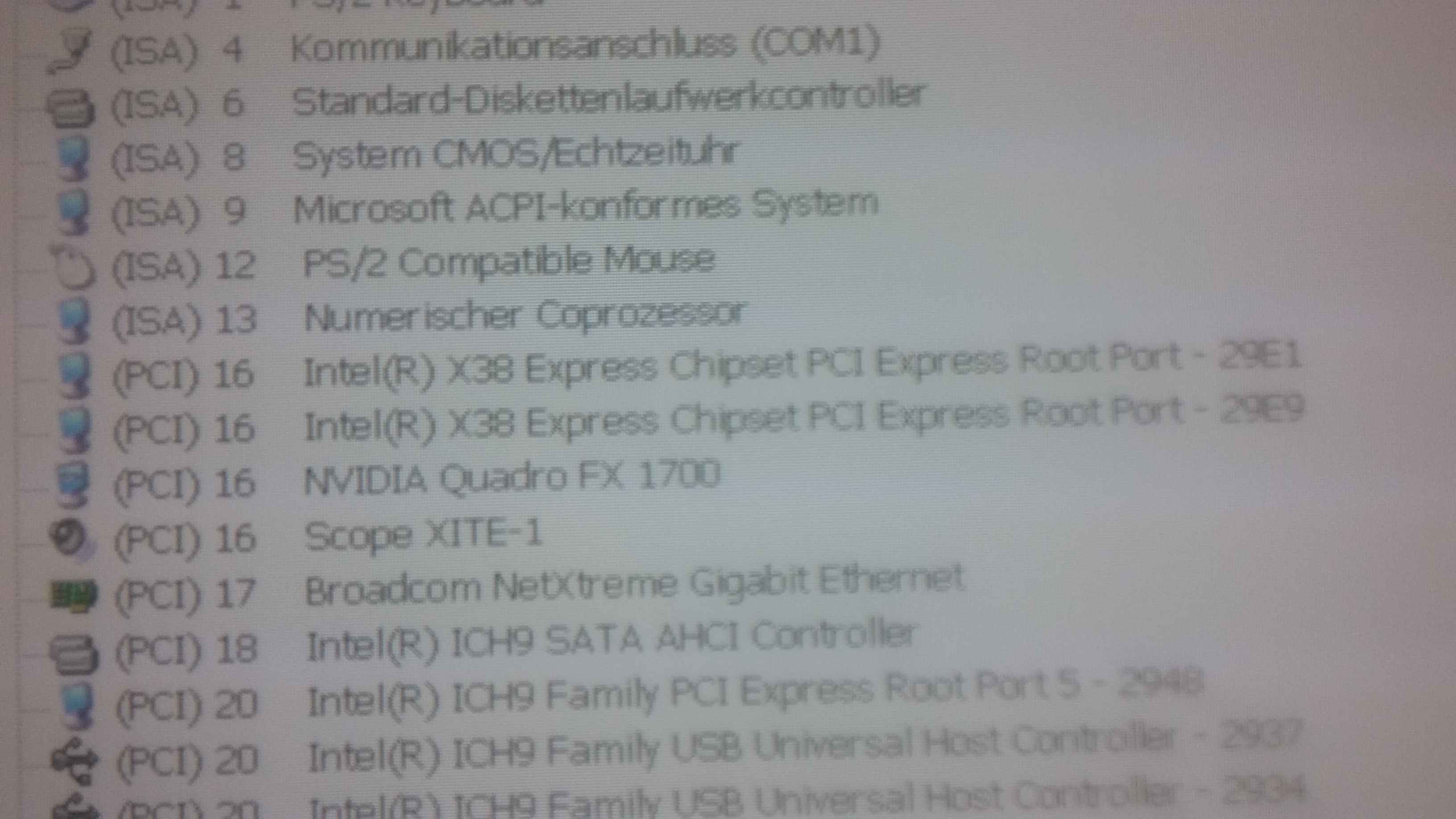

Yes, this would be my next purchase...but...I see conflicts with IRQ sharing...might this cause the problem? It ocurs randomly...the rate to get it started is appromaximately 25 %. Running xp sp3 on hp xw4600

probably not what made the problem, but you might tray a different slot anyway. the PCIe root port controllers don't matter, but it's probably better if the video card doesn't share an irq with the XITE.

the other slots will probably share with usb controllers, but it's not too hard to turn off the offending usb controllers in the device manager. sharing isn't a problem unless it's usb, firewire or lan, and mainly usb.
yes, the hdmi ports being loose will do this, but be very careful. they're easy to break.

I have tried the card in every pcie port...all of them are at irq 16, sharing the grafic card. I had bluescreens. Now its set in the short pcie and it seams to function.
