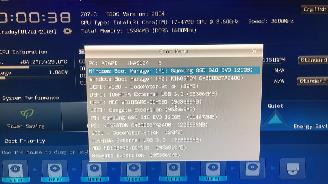

- dante
- Posts: 5089
Re: Would appreciate some advice on reconfiguring my hard drive settings
t_tangent, see screenshot below of BIOS, the boot partitions and the sizes. They are separate SSD - 120GB and 240GBt_tangent wrote: Tue Feb 27, 2018 4:01 pm Hi Dante, thanks for your reply. Yes it was actually your post and setup that led me to use Partition Wizard as well. At first I used Macrium Reflect but then I needed to resize the 64bit partition and couldnt figure out how to do that with Reflect, so I used Partition Wizard to do that. I have used an earlier version of Minitool before and its a decent util.

- t_tangent
- Posts: 989
- Joined: Sun Dec 28, 2003 4:00 pm
- Location: UK
Thanks for the picture Dante. Unfortunately for me it seems my bios doesn't have this feature, so just using windows boot manager. Will also get another ssd for sample libraries etc, as it has made a big difference already having the OS on SSD.
Thanks again.
Thanks again.
